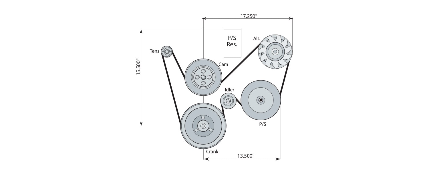

Shouldnt the belt route this way:.......?

Looks like its the Corvette drive:
