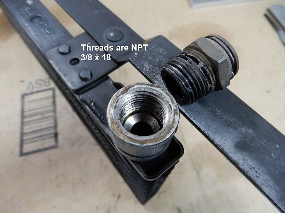

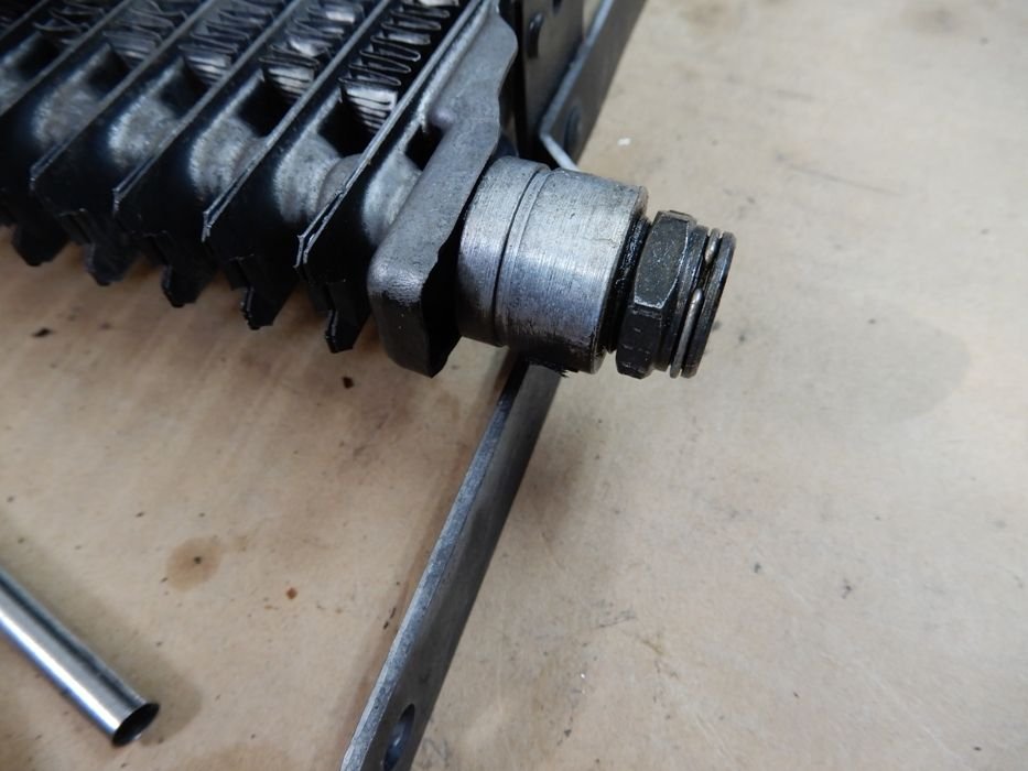

Does this quick disconnect fitting unscrew? I've had the left side in a vise but the fitting won't budge.
I picked up this tranny oil cooler at the junkyard last week, want to use AN6 fittings on it like I did on my4L65e tranny.

A little heat from my torch softened up what ever GM was using for a thread seal.
They unscrewed very easy.
I'll be using a 3/8 NPT to AN6 elbow like.
http://www.earls.com.au/shop/earls-9...6-to-38-npt-2/
