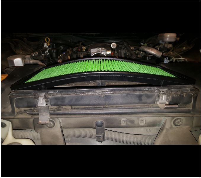

Yep, they do. Part #2021
Here's a really good video explaining them. No tricks, no gimmicks.
So this is similar to the K&N reusable filters except it flows better. I hope they fixed the fitment issue, this Amazon photo was dated 2016.

I'd still run it like that. Clamp down the lid and let her eat
That was always one of the biggest complaints with the K&N; the lack of sealing from the airbox to the lid. That looks substantially thicker.
