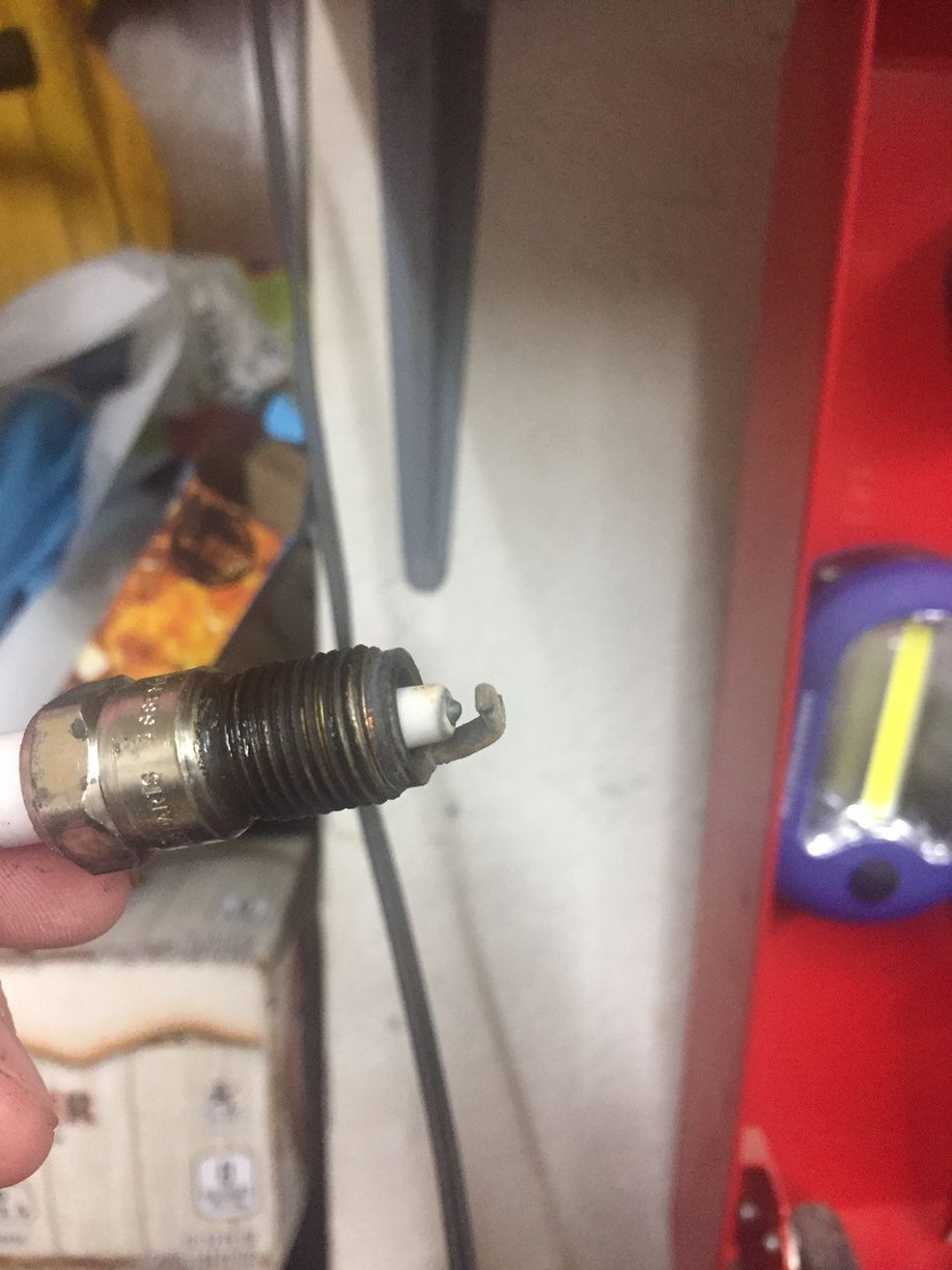

Unhappy Spark Plug Issues/Causes - Need Advice
I've replaced the plugs in our 2007 Yukon (5.3L) in July 2019. I'm posting a picture of the plug comparison at that time showing the before and after. Today, I took at look at cylinder 1 and I noticed the same behavior. The plug tip appears to have melted. Anyone have a suggestion why? So far Google has not returned any good results.
The vehicle is totally stock, other than a tune to eliminate the DOD feature.
One post I found said putting too much anti-seize on the threads insulates the plugs and they could run too hot. This is certainly possible. I usually put a dab about the middle of the threads and then let the twisting of the plug during installation spread it.

They're overheating.
Either for some reason they're running extremely high timing, or it's running very lean?
There's no way that the dab of anti-seize found it's way to the tip on all spark plugs.
Also, look at the threads themselves. They are coated with either oil, or dirt. If oil - I'd suspect there are misfires during operation (oil finding it's way to the combustion chamber) So it leads me to ask:
How is the truck running? Smooth? rough? vibrations?
Then, there is the possibility that those threads are black from temperature, meaning those plugs are just too hot. But I suspect that's the least likely possibility here anyway.
If it's just dirt - make sure you're torquing them to spec.
Who did your DOD tune? Or did you do it yourself? What was changed?
What anti-seize are you using? It's possible that particular anti-seize just turns black from heat (mine doesn't though).

They also look like it's too lean.
Use silicone dielectric grease on the threads instead of anti-seize.

The pictures didnt load the first time. The orange on the straps gives me pause. Are you using some kind of wacko fuel, or additive? That's not normal. $3 TR55 or TR6 plugs will outperform the iridiums, if you dont mind changing them every couple years - and they won't melt.

Based on condition of plugs, they misdiagnosed the root cause of your vehicle stumble. Oil fouled would not burn the center electrode off. Only serious heat or serious spark will. Don't think anti-seize is going to impact plug temp that much. Each plug thread is locking into threads of head when torqued to 15ft lbs. Personally, anti-seize is not needed on GM LS engines. Ford 3V 5.4 with 2 piece plug, yes.
Any pending, history or current codes stored in PCM? What did previous plugs look like? How many miles were on them? The recent plugs (12621258) with 15K look like they have 150K on them. When did the off idle stumble start?
Need to find a shop that can datalog/record fueling parameters to see what's going on when driving. Was +10% at idle or cruise? It's needing to add fuel to hit target AFR. Idle indicates possible vacuum leak. Cruise idicates fuel delivery. Fuel pressure low? Do you experience detonation when vehicle is hot or under load (going up long/steep hill)? Are you using a K&N filter that is depositing oil on the MAF? MAF or IAT could be off. Lot's of things to look at to help pinpoint root cause. You need an excellent diagnostic tech that go through the process to resolve your issue.

You have knock off plugs with chinesium electrodes, not true iridium, that's why they wore out so fast. The same way copper plugs wear out in 30k or so miles vs 100k with platinum/iridium, that cheap metal wore out way faster than the real thing would have.
As for coloring, those look like almost every plug I pull out of a car (I'm a tech and do plugs multiple times a week). I see plugs in bone stock vehicles a lot and they almost all have that brownish color. (Oddly mine do not, but I see it A LOT on customer cars, always assumed it's due to fuel or some sort of fuel additive?)
Edit: I ordered a real one, here's a video of it.
And for guys saying it's too hot, when I melted plugs in the past I melted the ground electrode off, not the center electrode.. is melting the center electrode a common thing too?
