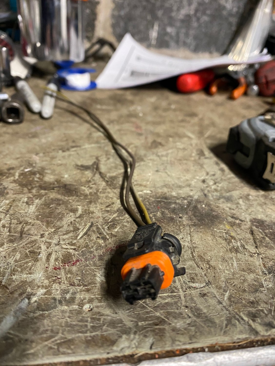

hi i have a dr44g alt from a 2002 chevy tahoe i put the motor which is a 5.3 in my 80 chevy malibu im running a carb no computer the alt has a 2 pin plug can i wire it to the malibus wiring or do i need a doide that everyone keeps telling i need
Are you sure your alternator has a two pin connector?

yes i was told just to hook to the battery and dont use the 2 pin plug

If it has a two pin plug, it's not a 2002 alternator

thats the only thing i have maybe its earlier one thats what on the motor
Post a picture. I'd say it's later.

im trying to post the pic but it tells me its to big of a file

Originally Posted by ShawnHarris1968
New to LS1Tech and have searched all over for some technical answers, I'm hoping someone here can help. I have a 1968 Nova that I am doing an LS Swap on. I purchased the GM Connect and Cruise package with the LS 376 with the T56 Tranny. I added the billet serpentine system with the one wire alternator. One of the questions I have is hooking up the "Gen" wire from the LS2 computer to the alternator. Since it is a one wire alternator I have a cable ran to my battery to the alternator but I don't know what to do with the "Gen" wire. I'm not sure what the purpose of the wire is and whether I need to hook it up or not. My thoughts are it does not need to be hooked up. Thoughts?
The two wire alternator charging is PWM-controlled by the ECU. If you just hook it up with the Bat+ it will go to default, approx 13.7 Volts which might not be enough to charge the battery.
There is a good thread on the Corvette forum.
Search ”2 pin 2006 + alternator. Don’t throw it away”
https://ls1tech.com/forums/conversio...hrow-away.html

yes i see what they are talking about but im nit running a computer or ecu all i have is the msd box and im running a carb

yea, but if you read the whole thread there is a way to get it to work with a PWM generator. Or with the Arduino nano if you don’t have a 5V output. (Arduino 12V supply)

this is what i have
