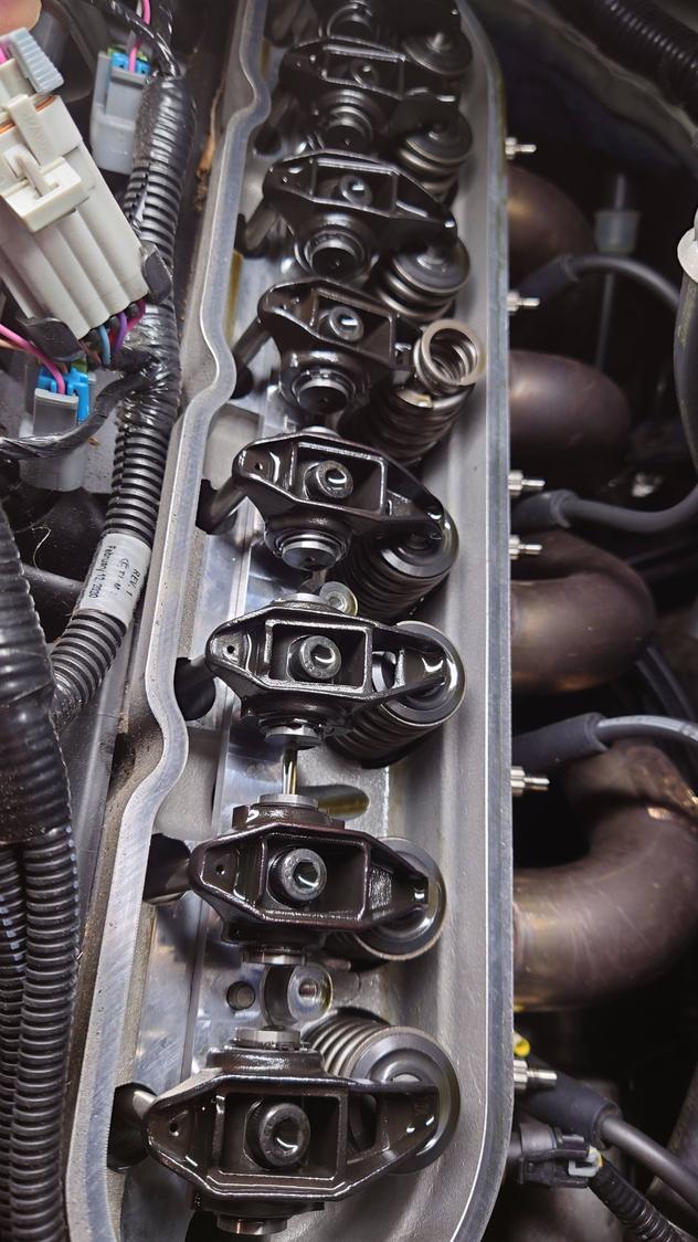

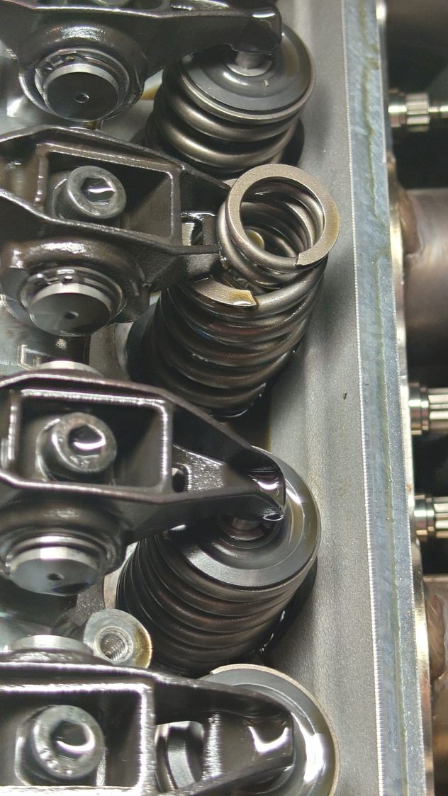

Went ahead and took off the valve covers. Passenger side was fine, pretty, shiny; but the driver side presented something different...
Rocker arm for the intake on cylinder 5 broke but the remaining portion is still holding the spring down and it looks like the spring has the valve in a bind so it isn't dropping. I'll post updates on how it looks once I get the heads off, fingers crossed. Thanks for the help to those that chimed in.

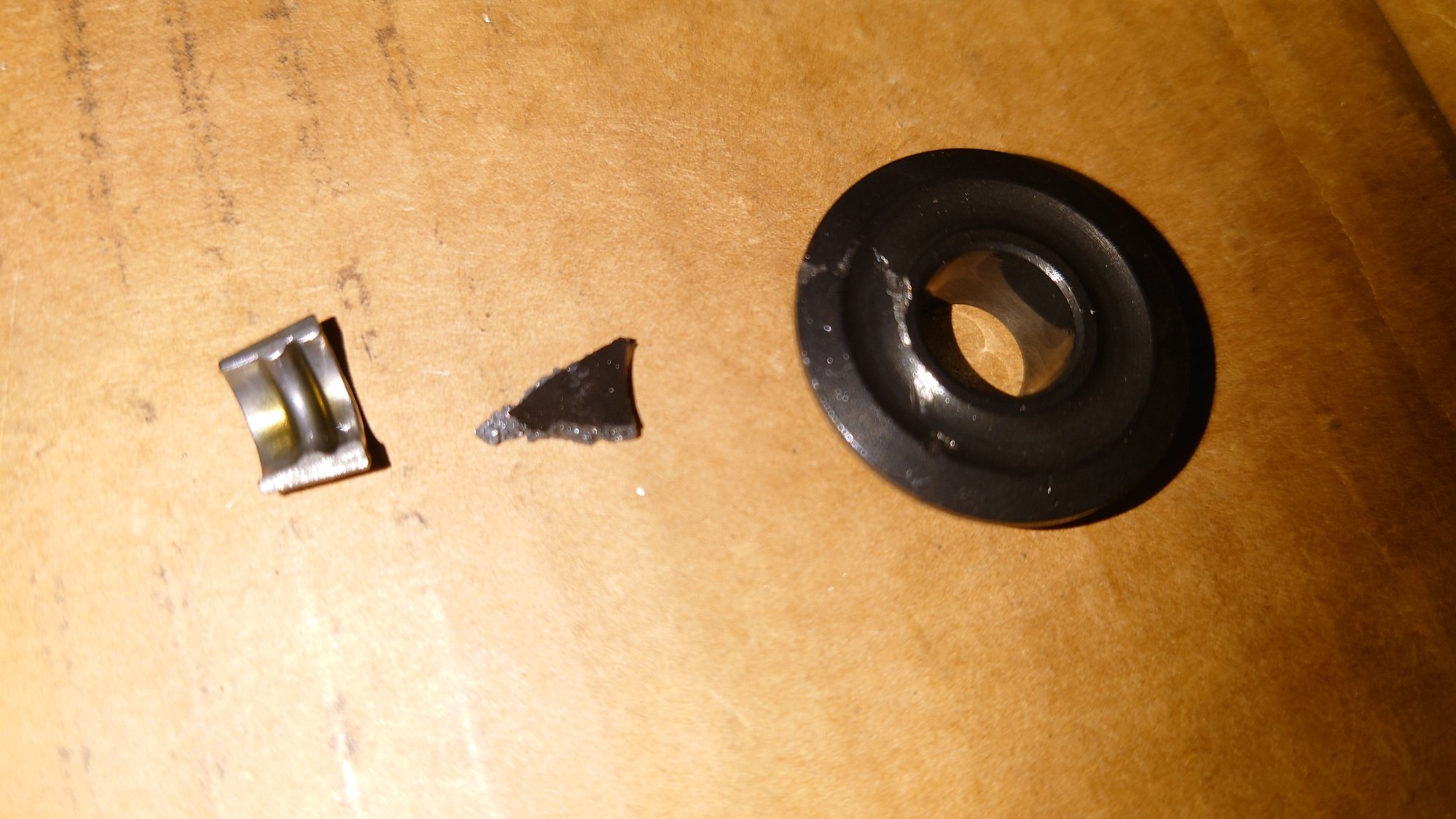

Why has it been over a week since my most recent post and it wasn't approved? People come to these threads hoping to see what the problem was and mods not approving posts can end up causing people more headaches. If this one manages to get approved, the problem was a stuck intake valve on cylinder 5. Rocker arm broke against it and I'm currently in the process of figuring out what caused the valve to get stuck.
