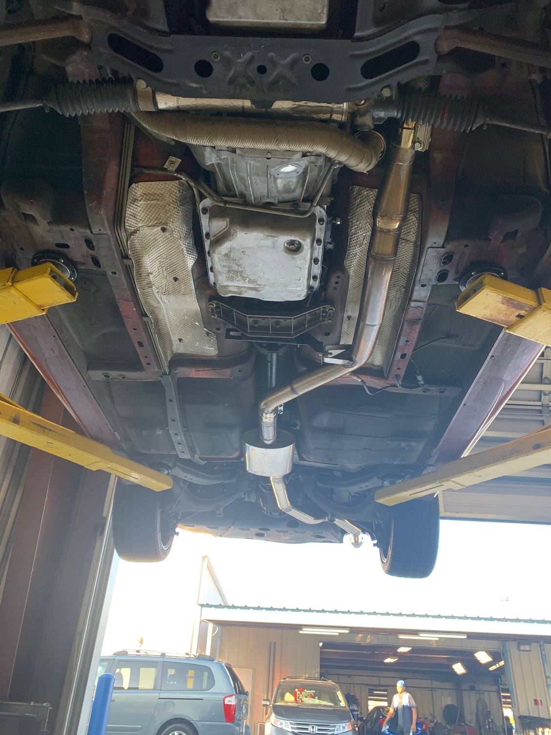

Aight. Maybe some of you gents can help me out. I'm about to build/upgrade my exhaust. Right now I have a single 3" coming out the turbo and all the way out the back with a borla pro xs muffler and a vibrant resonator at the rear. What I'm doing now is putting a 1.25 exhaust housing on the turbo and its a 3.5" out. I want to take advantage of that because I'm pretty sure my backpressure is high as i'm running 20-22lbs of boost. I may go a little higher when i switch to flex fuel. So i'm going to run 3.5" all the way out the back. However, thats going to be loud, and I want it quiet, until i don't. So dualmode is what I plan. I already have a nice 3" electric cutout...but dumping under the car sounds like **** and rattles the whole car. SO I figured 3.5", then "Y" it into two 3" and one side go through either a round muffler on one side and bypass it on the other side with the cutout....merging back into the exhaust after the muffler. Problem is, I need a round, not oval muffler that is quiet...to accomplish this. OR I was going to build a square muffler with a dual 3" inlet/outlet and one side will be straight through.
Now my questions are, 1) any idea on a quiet muffler? 2) what about a straight through borla dual in/out 2.5" muffler? (2) 2.5" have roughly the same pipe area so it "may" flow about the same. OR 3) I could use a more common quiet 2.5" round muffler and bypass it with a 3" and that should equal the flow of a straight through 3.5"
The muffler is longways in the middle of the car. Thats the reason for doing it this way.

This is what I have now:
