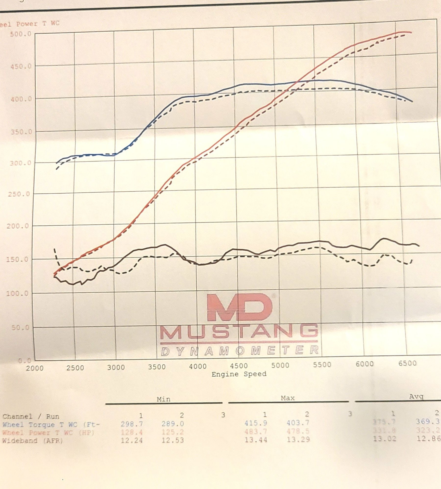

It looks different because whoever was running the dyno did the new run (red line) in a different gear (compared to the green/blue runs). So your comparison is completely useless here.
This happens when people don't know how to operate their dyno correctly. Also there should be no good reason to have the X-axis in wheel/drum speed instead of RPM (unless of course again the dyno operator has no idea how to use the dyno).

Results are in and there not any better than my stock ls3 intake. I gain 10hp at 5500 to 7000. Ok, it does look better, however there has to be some paramters to produce a gains with this intake in my opinion. My heads 235 cam combo netted no real change only 10hp, it did gain but I expected more. Does feel better up top. Mid feel the same even though the numbers are a tad lower. Here is the dyno. LS3 vs XS. Life moves on and so will I.

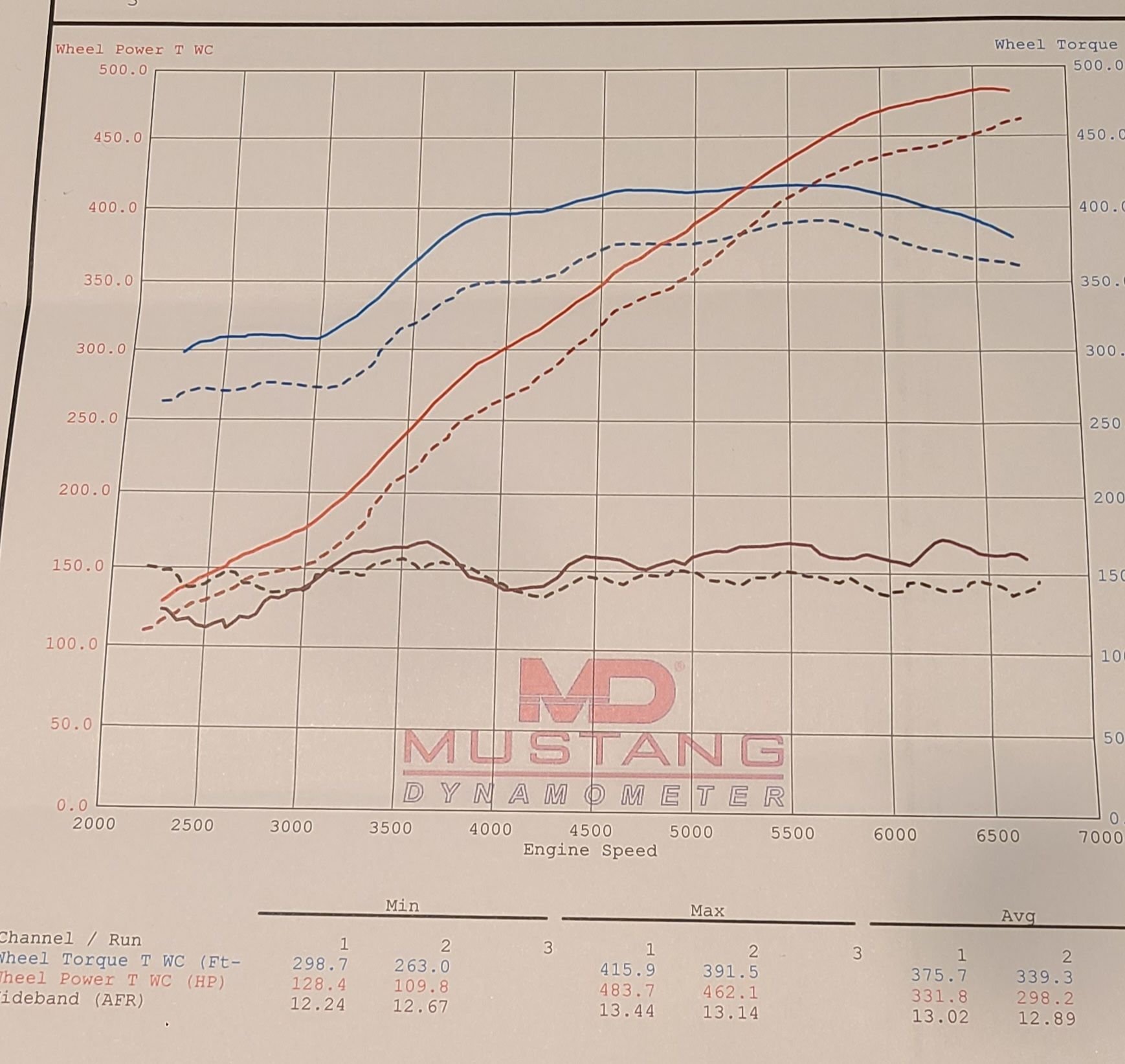

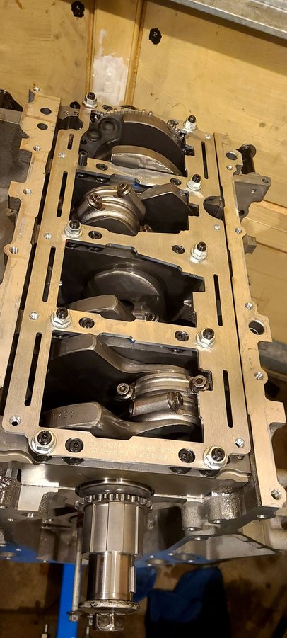

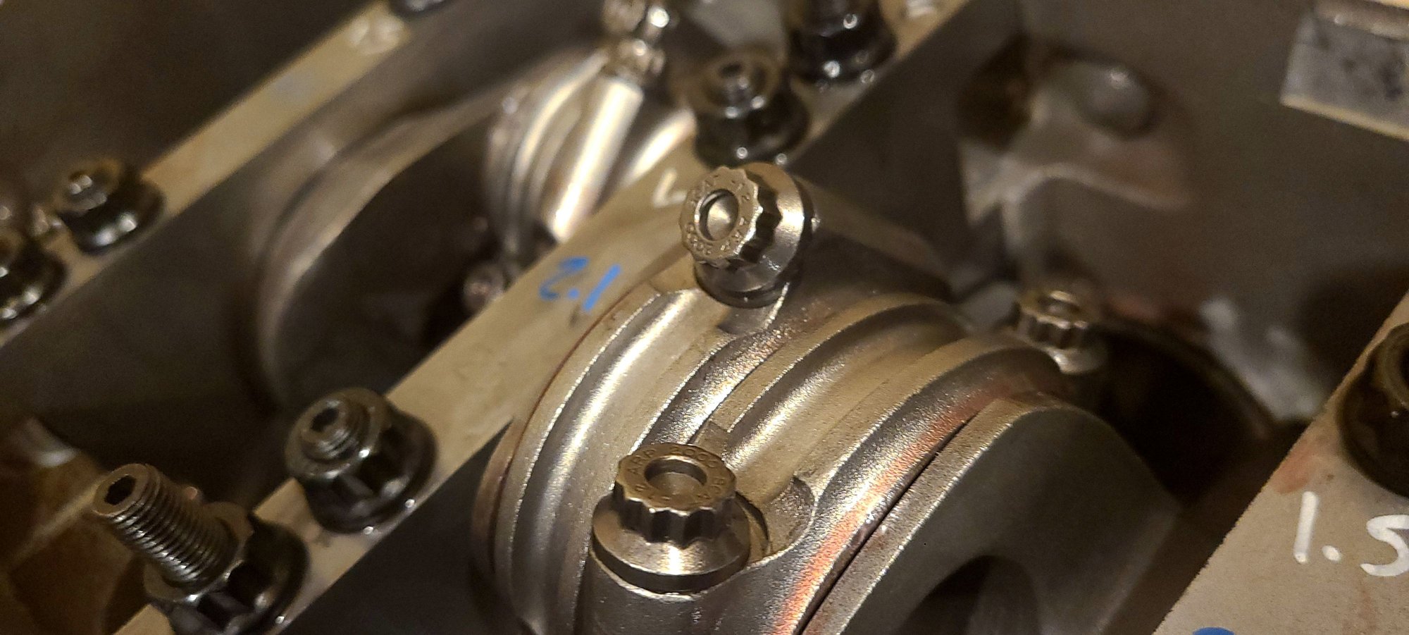

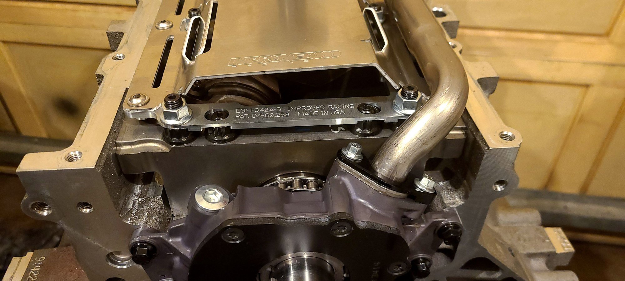

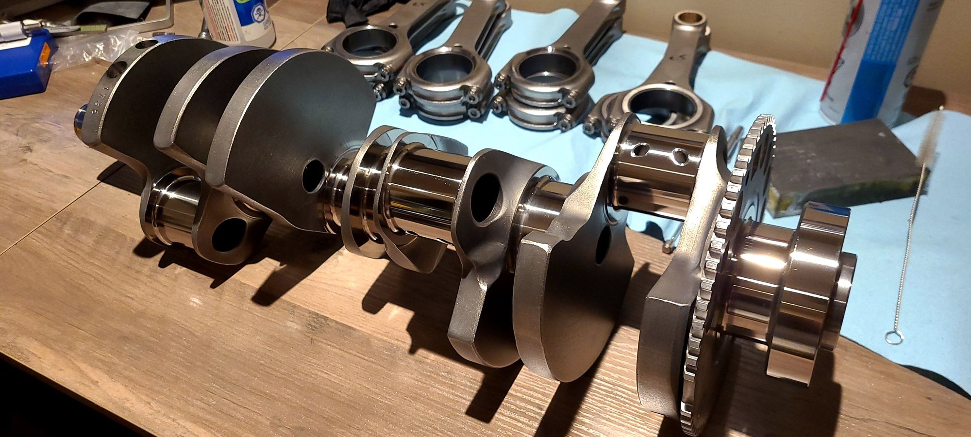

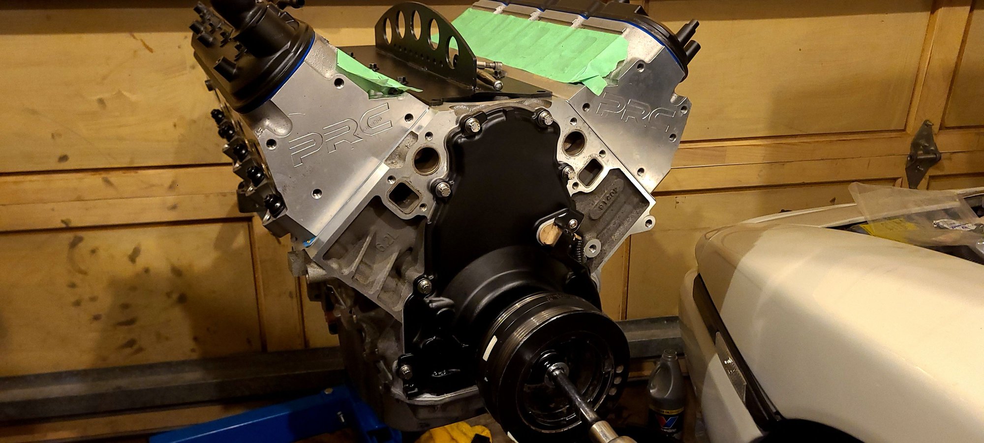

Update gents!!! Cracked a piston in Aug 2024. Built 417 Scat stroker. Look at these gains. If people are interested i have s tone pictures. I have the same intake as the one I started this thread

Is that power gains over your previous combo, or power gains over an LS3 intake? The photo is cut off so we can't see the scale on the left.

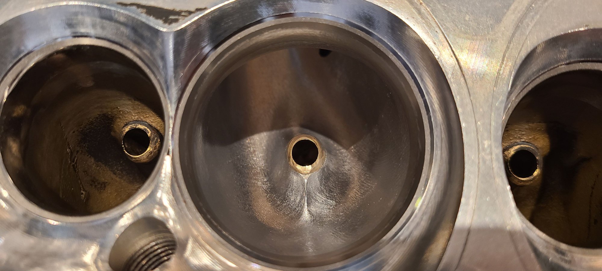

The dotted line is the Performance Intake, stock cubes 6 2L. 235 243 cam. Solid line is my 417 Stroker, thats the pictures i showed, with a 238 254 cam. I kind of wish i went with a bigger cam, but runs great, maybe in a couple of years bump it up. Made power everywhere so im happy. I also fully ported the runners this time the polished them. I also opened up the exhaust bowl another .120, as you can there is much of a seat there. Intake bowl is at 96% of the value size, so im happy.

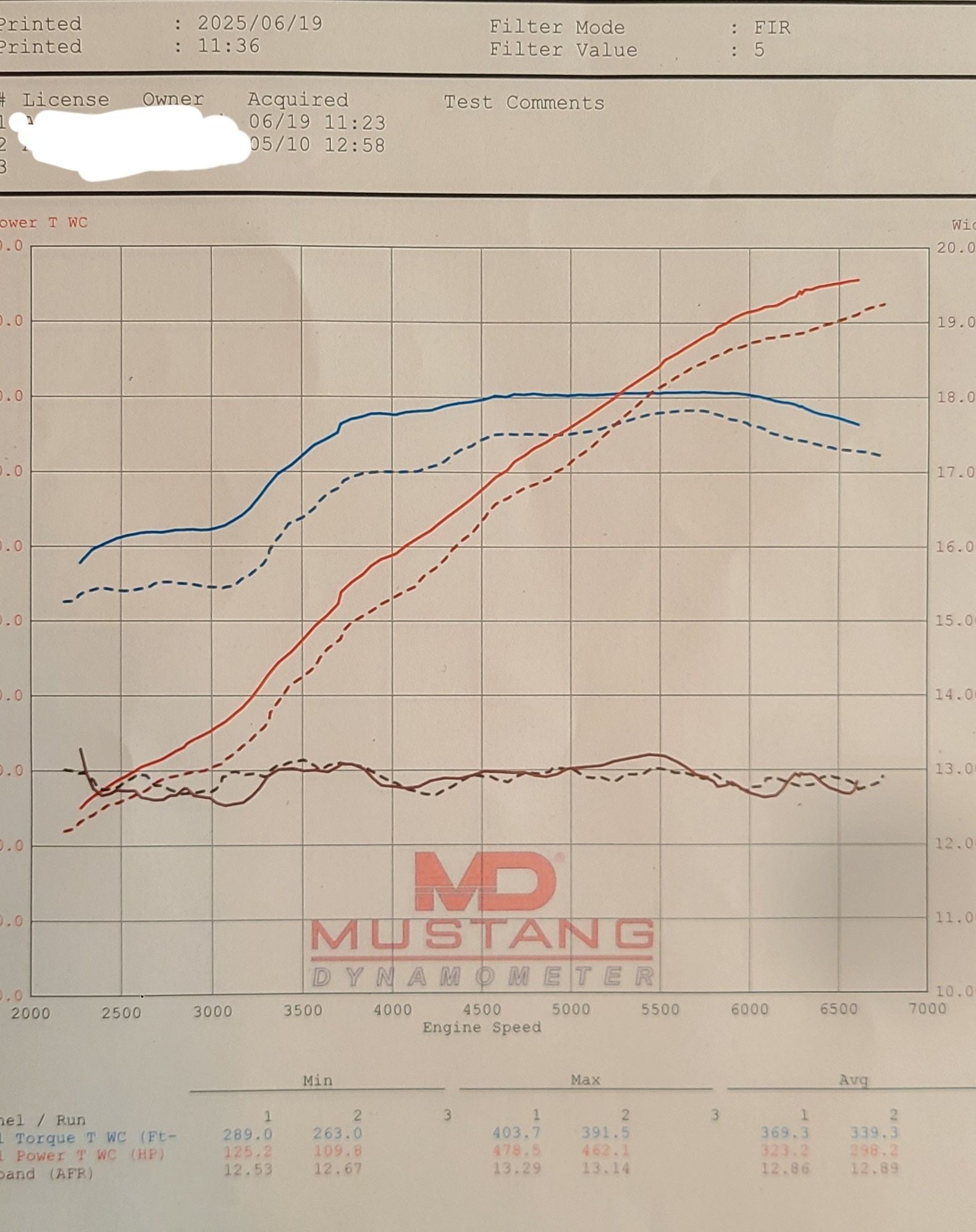

Hit the dyno and made some gains with adding some timing, but less timing up top worked better. Leaning it out to 12.9-13.2 gained alot more power. This on a mustang dyno, results below. Dyno did show 485, however it changes it on paper.
Graph below gains from last year and bottom is overall gains from switching to a stroker.
