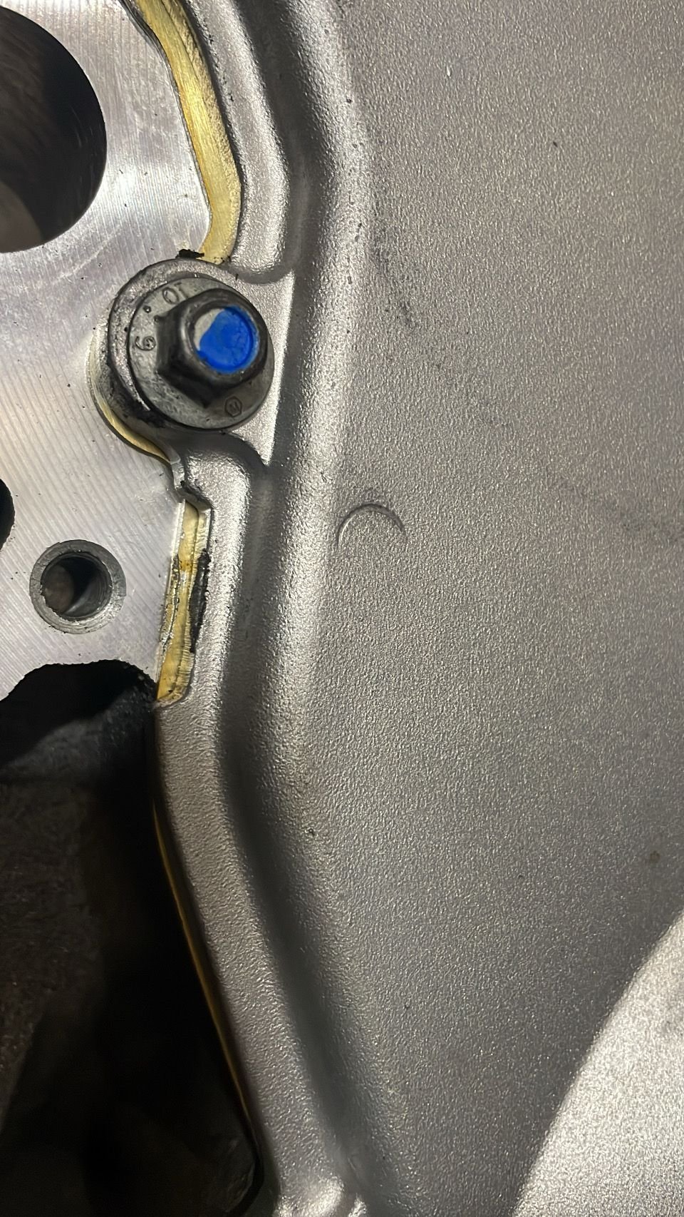

well like i stated it was a huge gap and making contact. there was a 1/4 inch gap. The gaskets are no where near that thick. That wasnt the problem. It was the bolts on the back of the pump. Yes my version of the water pump was the factor. Others posted different versions/brand pumps that had different bolts. I know you really want to push your point of mocking up without the gaskets but, it was a different issue. Its obvious there will still be a gap without gaskets but not 1/4 inch

well since you seem so inclined to prove your point rather than be helpful and claim that i think the issue is the bolts and its useless to explain to me. Maybe you just have your panties in a bunch. The bolts were making contact not allowing the pump to seat even with gaskets. Theres then indentation THE BOLTS were making with the cover. Im sorry you were so inconvenienced to keep replying to my post stating you never had issues

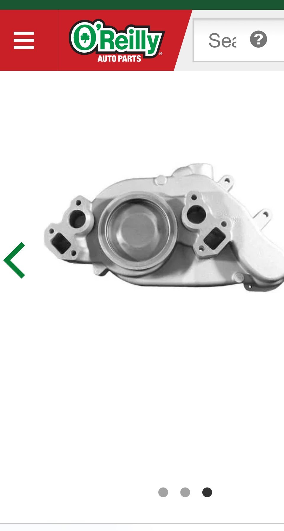

I also mocked up with the gaskets and the same original bolts just to disprove mervs claims of the bolts not being the issues and it was the gaskets not being used. Still the same issue. Just didnt snag a picture of it.
Even went the extra mile to get a new ac delco pump, and boom what do ya know different design on the back that doesnt use any bolts. Even went further to see the other remanufactured pumps they had which were a different design on the back just like mine. The ac delco seated perfectly and fixed the problem. Didnt snag a picture before i left my buddies house but this is the one i bought below

Just had a thought and I know that's pretty crazy for me but I have two spare new LS1 2002 Camaro water pumps on my parts rack. Both have bolt on rear water pump covers. One I test fit on a current LS3 project and yes the water pump bolts hit the front of the LS3 VVT delete timing cover. The water pumps came from NAPA 3-5 years ago. So it maybe was a bit a bubba but all I did on the LS1 water pump bolt heads was grind the bolt heads down a bit for clearance. Plenty of the head left if you wanted get them out but I don't have any idea why you would.

I had the same issue some years back with a off brand pump using bolt on rear cover. I ground the bolt heads down a good 1/16 or more. Just enough for them not to contact. My new delco brand has a press fit cover. So no contact, but it sure is close. Thats a stock LS3 with f-body water pump/accessories/balancer. Also my steam line is close to the underside of the TB, but no contact either.

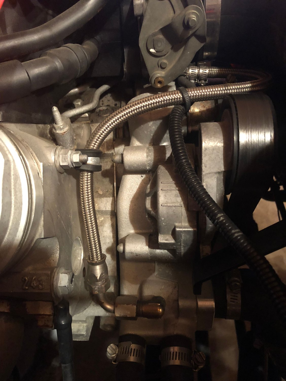

My LS6 swapped 98 Wrangler I tapped the water pump for the steam line. Been 15 years with zero issues. But if the pump fails I'd have drill and tap a new pump. It hasn't failed but it would be on the Power Tour a 1000 miles from home. I have a new pump already drilled and tapped I take with me on road trips.
But here's a pic of 80 Camaro LS3 project. Steam line to the radiator. No mods to the pump if it fails. I think that is a better solution.
Wrangler tapped into the water pump.
Pics.

In the bottom pic, does the other end go to the steam pipe coming off the heads?
I wanted to use a schrader valve on mine in place of the braided hose to release any trapped air, but not the tire valve type. A more heavy duty version.
Anyone ever done that or is that a wacked idea?
Old Jan 5, 2025 | 06:49 PM
  #40
the_merv's Avatar
Veteran: Air Force
iTrader: (88)
Joined: Mar 2006
Posts: 21,019
Likes: 893
From: The Beach...
Yea his line loops to the Steam Line, it's out of the picture up on the top there but you can tell.
If you've ever worked on the Gen II LT1's, part of bleeding them was a screw valve.
However in the case of the LS I highly doubt you'd get trapped air there, as soon as that Water Pump turns there's enough turbulence and moving water to move everything in that little line, expecially when the coolant in the Heads is moving through that Steam Line.
