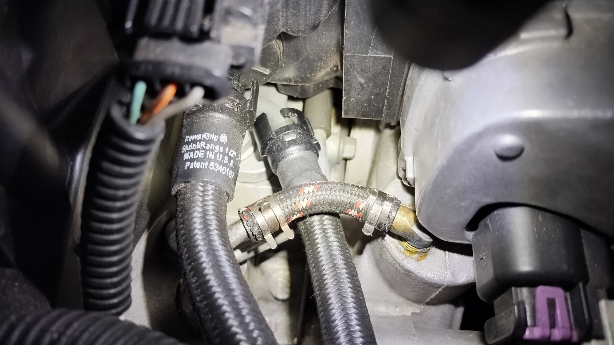

In the pic with the long -3 SS line it is a -3 brake line I get from the local dirt track parts supplier. Teflon lined.
So what maybe confusing before I had some LS steam line knowledge I plumbed them into the water pump. The pic was a stock LS1 hard steam line. Again never had a problem.
But on my last few LS swaps I use a truck? hard steam line that has the steam line tube outlet on the right side of the intake. I cut the outlet tube off and drill and tap the block for 1/8" NPT. Then using a NPT to -3 adapter with a 45 degree -3 fitting.
Again not a great pic but it shows the 45 degree fitting.
I've never used a valve in the steam line to bleed it.
