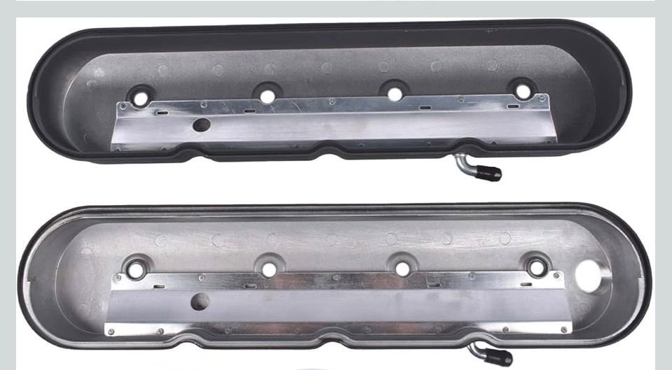

I am running Holley tall valve covers. They do NOT have a PCV. They have baffles and each cover has one vent tube. My valley cover does not have a vent.
can I just run both valve covers to a breather tank?

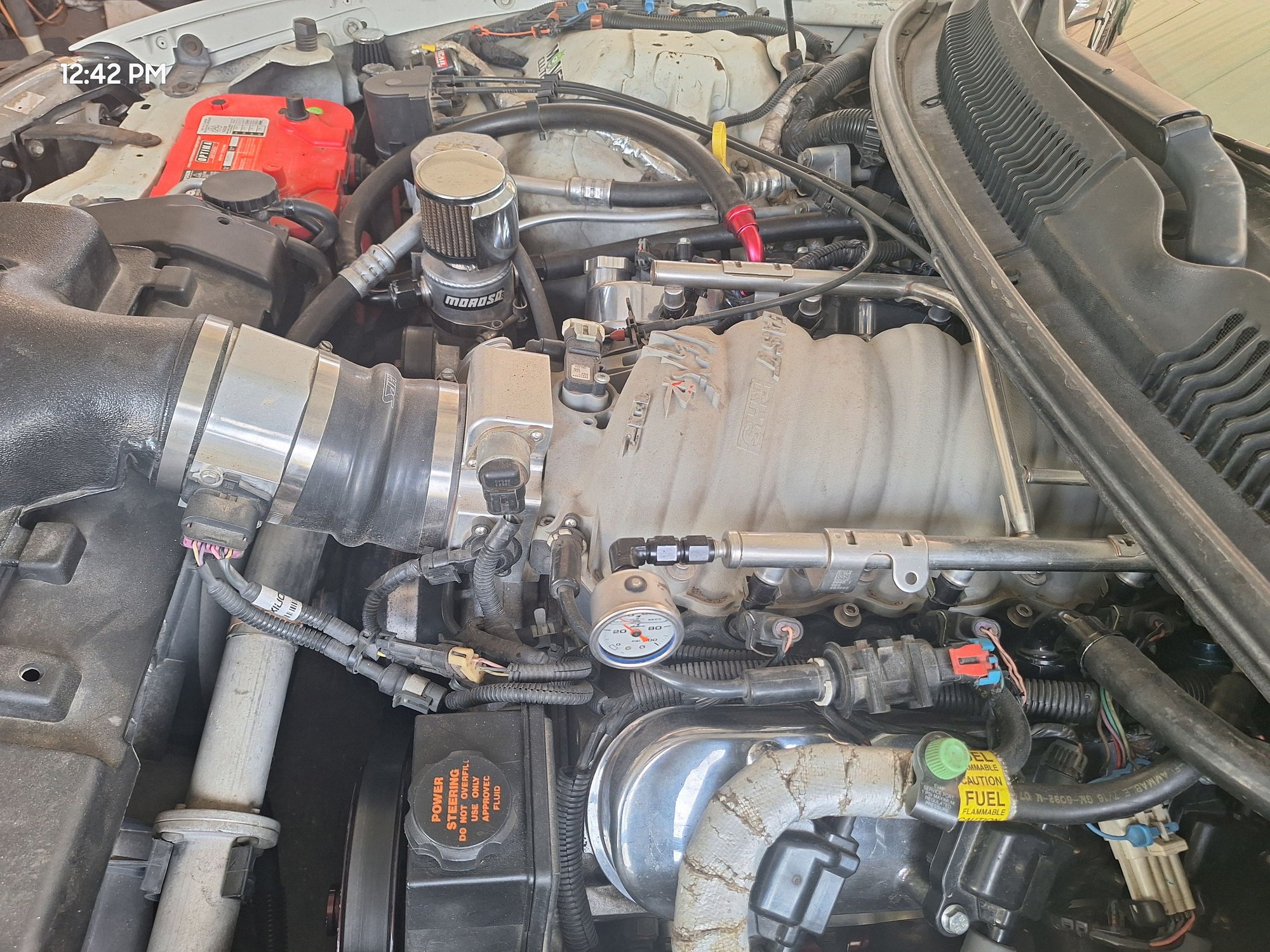

I have those on the 427 and I just removed the hose fittings and drilled and tapped the valve covers for 3/8 NPT and installed 10AN bungs on them. I then ran two 10AN lines to a single breather can and capped off the intake manifold and throttle body ports. This is an option if you want to ventilate the crankcase and not allow the intake manifold to pull air through the engine and send the crankase vapors into the manifold. If you wish to run PCV you can leave the valve covers as-is, connect the driver side port to a sealed catch can. From the catch can run a hose to the intake port but install a PCV valve in between the can and the intake manifold port. For the passenger valve cover you can connect a hose from that cover to the throttle body. That is if it has a port for a hose and if it dosen't then you could install a hose barb into the intake elbow or the air intake tube going to the throttle body.

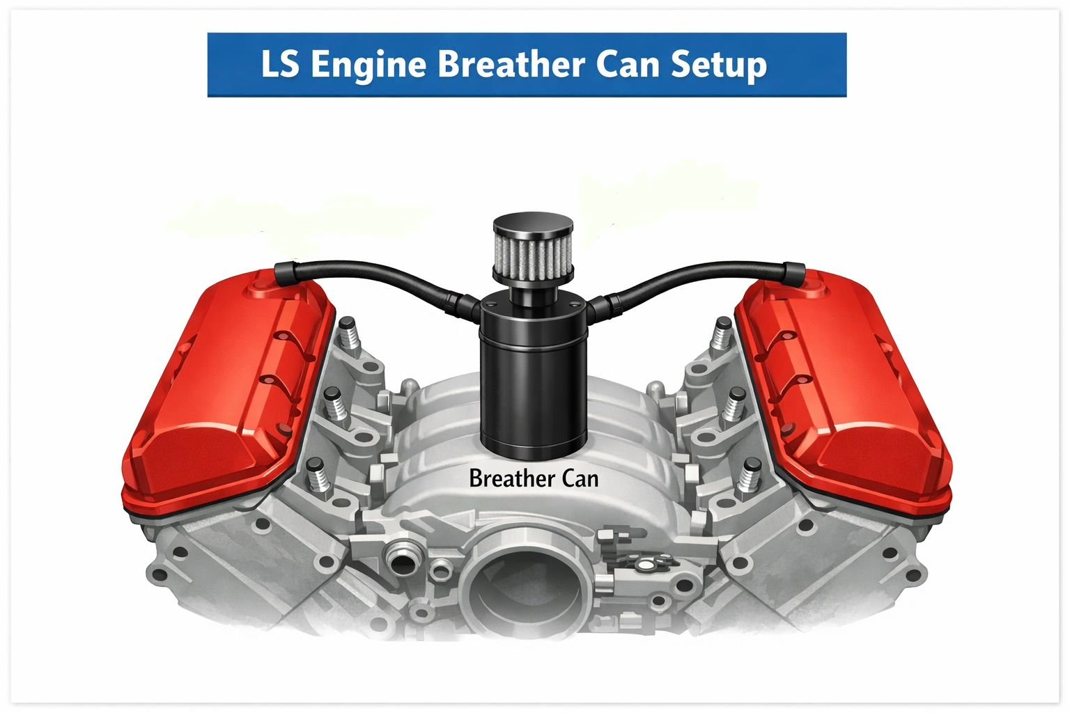

basically setup like this correct ?
no check valves ect just vent the pressure

Smokie- PCV stands for Positive Crankcase Ventilation, which is NOT what you show above. You show a Passive Crankcase Ventilation setup, which is half-*** at best.
For proper PCV, you first pull fresh air from the air intake AFTER the MAF (if used). Route that line to an unrestricted valve cover hose nipple. That clean air will then go thru the engine picking up all kinds of nasties as intended, making its way to the opposite valve cover with either a restricted nipple or PCV valve. From there to either a catch can and then a manifold vacuum source OR straight from valve cover to manifold vacuum source. DONE.

You still need to evacuate the catch can and send that back into the intake manifold.

That is correct!

Notice the 10AN on the passenger and the other 10AN line on the drivers side valve covers? Those both connect to the Moroso breather can shown in the image. As for the intake manifold and throttle body they are capped off.

Doesn't a PCV can like a Mighty Mouse pull vapors out of the engine and then feed the clean air back into the manifold?
Old Feb 21, 2026 | 04:59 PM
LS1Formulation's Avatar
Posts: 3,909
Likes: 1,158
From: Grand Rapids, Michigan
Yes, it does.

thanks man! I appreciate actual experience w/ photos.
question about that can. Does it have internal baffling ?

I do my own research too and found that according to motion race works that is not necessary. It’s just to prevent the smell , which I believe will mostly be at high load. One could take the breather filter off and route it to the intake.
some say we need to pull the vapors out with vacuum, other say it pulls the oil out. With a good baffling system that won’t happen. I do think I’ll run two check valves that allow air out but none in.
here’s the proof from motion who knows better than most of us Here I’d argue

It has a wire mesh inside the can. I've never seen the can fill up with oil per say but it does fill up with condensation during the cold months and since there's some traces of oil that does collect in the can it looks like a light brown milky substance and you will notice water coming out of the can when you drain. This is only if you run the car in the cold because I never see anything coming out of the can during the summer months.
