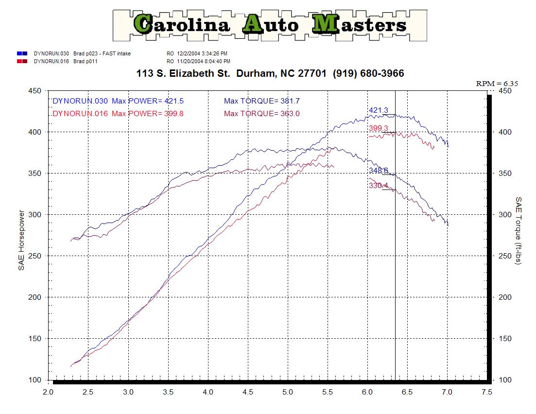

Here's one guy, a friend of mine, that lost 20 HP just from switching to the LS2 ...He now has a FAST on it, and here's some numbers.
Blue is FAST and Red is LS2

What did he have on before, an LS6? When you say he lost 20hp from the LS2 do you mean that he gained 20hp over the LS2 from the fast intake?
The fast may be better than the LS2 for big cube motors. I suspect we will find that the LS2 is significantly better than an LS1 and slightly better than an LS6.

Hmmm. the same?
All Gen IV small-blocks receive a new throttle body; for the LS2 it's a huge, single-blade 90mm design that incorporates a motor to actuate the throttle's operation with electronic throttle control (ETC).
The manifold itself isn't revolutionary; just an evolution of the cross-over plenum design of the LS1 and LS6. As with the Gen III versions, the LS2's manifold is made from lightweight composite material and comes in basic black.
Evolution -- A gradual process in which something changes into a different and usually more complex or better form. See Synonyms at development.
These seem at odds with the caption on the picture.
