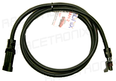

Racetronix sells one as well http://www.racetronix.com/RX-LS2-CSAH.html
