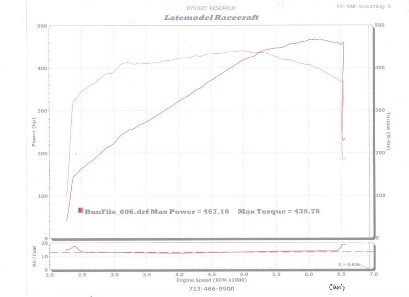

Put down right around 470/440 at the wheels using the stock intake and throttle body for now. Hoping to pick up a Fast 102 and throttle body later this month or next. Runs great though, LMR did a great job on it.

Gotcha, I assume by stock intake/TB you're using the LS2 setup? I am using stock 799s with mid length headers, LS6 intake, ported LS6 TB. I put down 450/475.
Aren't the LS6 and LS2 intakes pretty comparable as far as flow goes, with the edge maybe going to the LS6? Its weird how our numbers can vary by that much even though you heads and exhaust outflow mine, my torque is out the wahzoo. Do you have a dyno sheet?

I just went and found the dyno sheet and the exact numbers were 467.10/439.76
