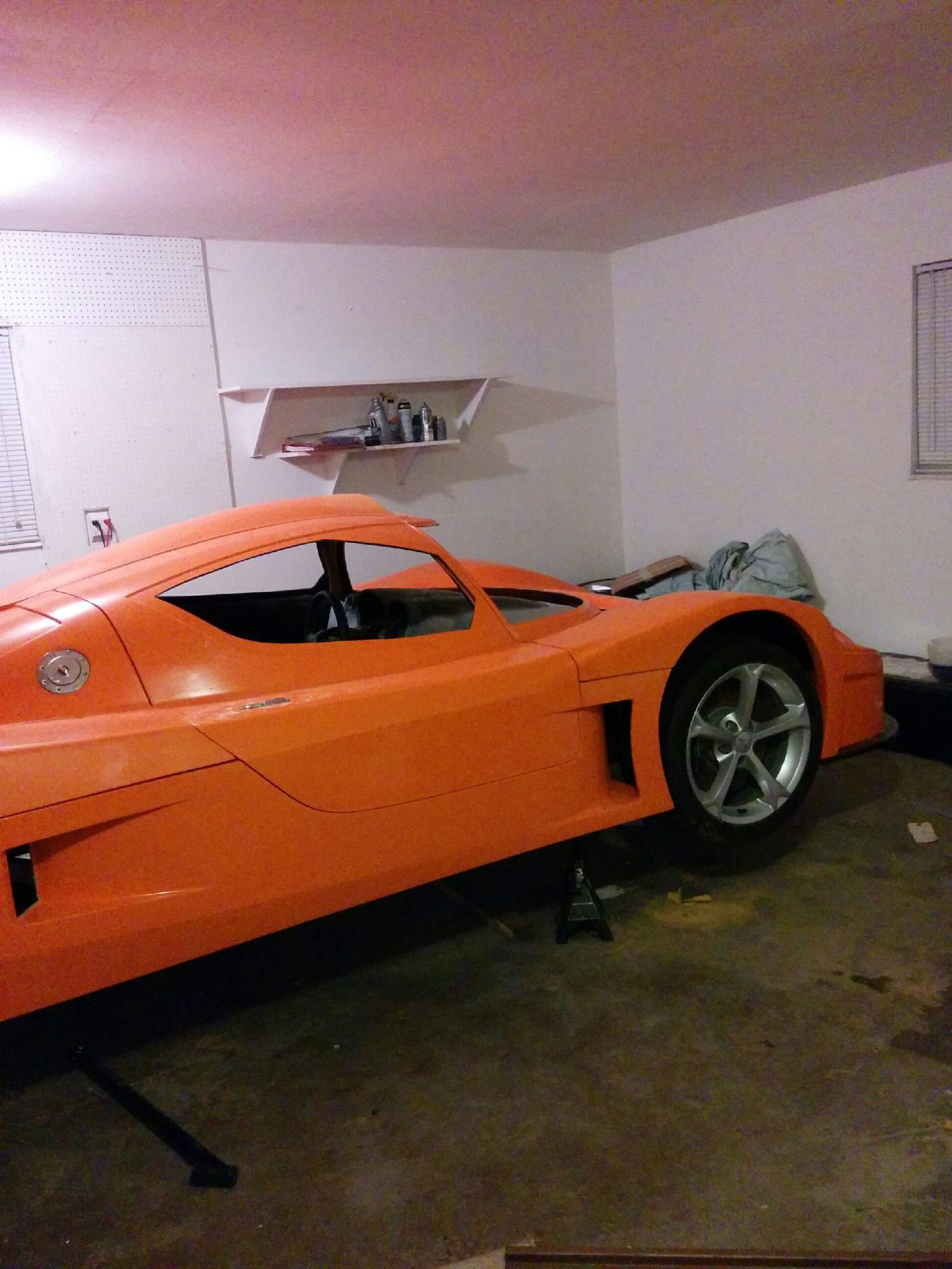

Okay,, here are the pictures. I had to put the shell back on to make room in the garage this weekend. Hoping to get the Fuel Tank off to welding soon for the internal fuel pump modification. BTW does anyone know how I might have this thread moved to another subject, or should I just start a new one?
