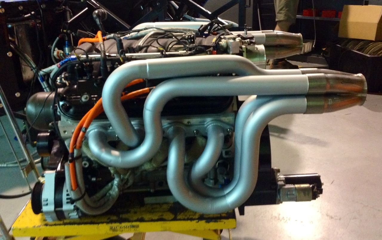

Hi David,
I road race with this car and this engine, see photo's below, and this LS7 based NA engine does everything DK says he wants and its affordable in terms of what DK is after which is Time Attack track car.
Apart from the off the shelf V8ST spec Dailey Engineering Dry sump pan and pump, it is pretty much a standard LS7 with a really nice 665" lift Hydraulic roller camshaft, spec'd for me by Kip at CamMotion. It makes very smooth power from 3,000 and revs to 7,500 RPM. Peak power, 700BHP, is @7,000 RPM and peak torque 540 Ftlbs is @ 6,000 RPM.
It even use the stock Ls7 manifold and 90mm throttle body, so for a short duration "Time Attack" car its an awesome road race engine, with great throttle response at a very reasonable cost, less than $20K all new.
Cheers,
Mark.

Old Jul 10, 2015 | 05:13 PM
DK's Avatar
DK
Joined: Jan 2013
Posts: 52
Im sorry I cant hear you from the loud bang that was my jaw hitting the floor
Originally Posted by KiwiKid
Hi David,
Cheers,
Mark.

Hi DK,
No question we run a serious race car at the top end of road racing here in New Zealand.
I guess my point is that you don't have to use anything more than a bog standard LS7 crate engine, which you can buy brand new from Chuck at Pace Performance for under 13K, then re-cam it, and stick some decent headers on it and go racing for about 15K, if you don't want to go the expense of the aftermarket top end dry sump system, which you will only need if you are cutting a lot of laps.
If you can buy a second hand LS7 from a really reliable source you may be able to do it for even less money. the Camshaft is only $375 and that and the headers are the key to what you need, believe me! I spent a lot more money on the exact same configuration and basic spec because we run for 3 hours and longer, so we have to go for reliability, and better parts cost, its that simple.
WE RACE CAR'S NOT DYNO'S
Cheers,

Thats a 'half way house' engine to my own 3.625" short stroke engine, as it keeps the standard 4.125 bore which saves a bunch of money, so I understand the reasoning behind that build decision.
What I also don't understand [like yourself] is why use 1.7 expensive Jesel Mohawk rockers, instead of 1.8's, that's leaving very cheap BHP on the table.
The rod ratio could be improved further by using a 6.200" rod but then again that's more money, so staying with common components such as the 6.125" rod saves money, but it does mean the piston will be heavier that ideal because of the compression height needed unless they have decked the block.
In my opinion there is no point in upping the compression ratio, because that is going to increase the torque potential of the engine.
Its interesting that the engine also use the Dailey Engineering V8ST spec pump and pan that Bill Dailey and I designed, and I also use in my Mosler's present engine.
I dont see a price on that engine build but I think it will be mid $20's if not higher.
