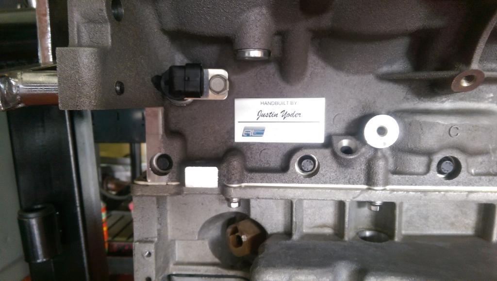

Millenium Z06's Avatar
Joined: Apr 2005
Posts: 229
From: Frisco TX
That's essentially what they told me (Seth), they'd build whatever I wanted but recommended against a 4.1 stroke and a power adder more than 100hp. Justin built my bottom end.
