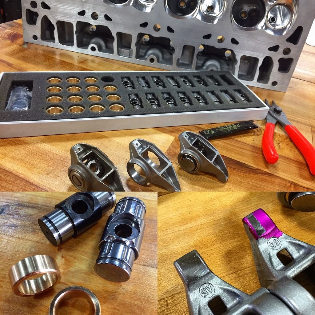

When you use a roller bearing, most of the time, the bearings float within the races allowing different portions of the bearing to absorb the load you are placing on it. If you are switching to a bushing, you are now loading one side of the bushing in the same place all the time. Aren't these going to wear on the load side since the bushing is not going to float and change the load bearing surfaces?
Good question.
In a needle bearing situation you have the “load” on only 3 to 4 of the needles that are supporting all the load. In a bushing application the load is supported by 30% of the bushing radius spreading the load out. When comparing load limits the bushing can with stand 300X the load than a needle can.
In short, the bushing is superior to a needle bearing application in spreading the load out over a larger surface area which reduces stress and pressure applied to the bushing and the trunion itself.

But, in a bearing situation, the load location is changing all the time. The same 3-4 bearings may not see the load again for several revolutions or more of the engine due to the bearing rotating. In a bushing, although the load may be spread across a larger surface, it is the same surface during every revolution of the engine.
What is the life of the bushing versus a bearing if everything else is equal?

I have seen aftermarket trunions fail before several times. More so the stock parts, but I have seen aftermarket kits fail as well.
As for the stock rockers, the needle bearings in a stock rocker arm do not revolve around the axle.

Interesting info to add to this thread, first - the stock rockers have a decent amount of taper across the tips as compared to the trunnion bore. This is due to the nature of the manufacturing process of MIM parts that are not precisely "coined" or pneumatically tapped into final shape after the powder has been cured. This explains why the set of LS7 offset intake rockers I upgraded today with this kit had .005" of taper across the tip (double what I see on others) and could be a possible root cause of the excessive intake valve guide wear consistently seen on these and the LS9. Additionally, the LS7 rockers have a trunnion bore that is .0008"-.001" tighter than any of the LS1/2 sets that I have measured and this was enough to make the trunnion barely turn in the bushing - we had to hone the bodies to proper size before being able to true and polish the tips to less than .0005" out from the bore.
Great kits, just some things to think about after having installed these kits personally...
Trued Tip on Right, After Buffing on Left
LS7 Rocker Before Tip Truing (Youtube Video)
LS1/2 Tip After Truing
Honing LS7 Rocker Arm Body to Accept Bushing Kit

BTR utilizes a needle bearing design like the Summit, Comp and every other kit out their aside from this one and the CHE rockers.
Originally Posted by Droptopws6
Did your guy ever report back to you regarding use with 1.8 ratio rockers? Usually by the time I get home from a long work day it's too late to call.
These will work with LS7 rocker arms I have confirmed this.
Good info in Machinistone post as well for those using LS7 rockers and the bushing kits.
Originally Posted by machinistone
Interesting info to add to this thread, first - the stock rockers have a decent amount of taper across the tips as compared to the trunnion bore. This is due to the nature of the manufacturing process of MIM parts that are not precisely "coined" or pneumatically tapped into final shape after the powder has been cured. This explains why the set of LS7 offset intake rockers I upgraded today with this kit had .005" of taper across the tip (double what I see on others) and could be a possible root cause of the excessive intake valve guide wear consistently seen on these and the LS9. Additionally, the LS7 rockers have a trunnion bore that is .008" tighter than any of the LS1/2 sets that I have measured and this was enough to make the trunnion barely turn in the bushing - we had to hone the bodies to proper size before being able to true and polish the tips to less than .0005" out from the bore.
IMG 2704 - YouTube
QA/QC on trued rocker arm - YouTube
IMG 2700 - YouTube
That is very interesting. I really appreciate you sharing that in this post so that others can learn from your experience and expertise.
I would think that the buffing and the truing of the rocker pads would help with any valve stem tip wear and rocker pad wear that could occur as well. I could also see valve stem tip wear occurring due to the taper of the rocker tips. Which is interesting that I mention that because I seem to have more customers with LS7 engines that experience valve stem tip wear with valve lift that stays in the "safe zone" of what the rocker arms pivot length can handle.
Thanks again for posting that!
So this is a guarantee we need to hone the rockers for proper trunion fit?
