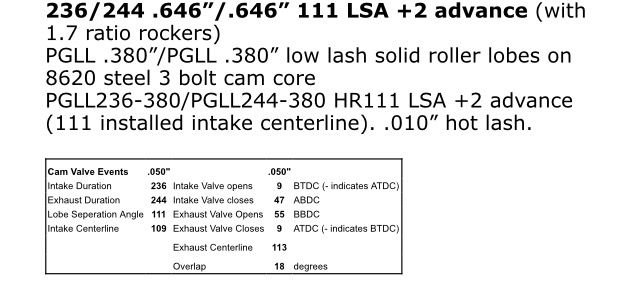

Attached pic.
Factory LS3 ported heads. 7.200 push rods.
Crower adjustable rockers.
Old May 18, 2016 | 12:02 PM
anthraxmm's Avatar
Joined: Oct 2006
Posts: 29
From: Exeter, CA
Originally Posted by mr08353
Attached pic.
What does the bottom end consist of? Pistons, head gasket etc..
Old May 18, 2016 | 12:37 PM
mr08353's Avatar
Joined: Oct 2015
Posts: 86
All stock.
