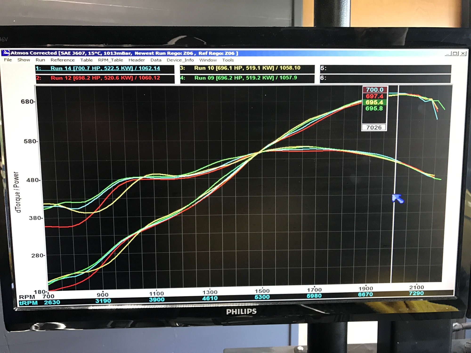

Dan,
Apples and oranges in this thread discussing LS3 components.
The MSD your referring to is an LS7 and not really applicable here. Also for the sake of discussion it doesn't roll over badly at all IMO considering its a 454 shortblock with good parts but nothing exceptionally trick in reducing the typical windage and frictional losses big cube engines experience at higher RPM. A really tricked out (aka expensive) shortblock similar to what you built with a lighter ring package etc would reduce those losses alot more IMO. Its nosing over at 7300 certainly as seen in the dyno gragh posted below but considering what we are discussing this manifold continues to impress me. I can port it the same way and install it on a 427 making 100 less RWHP and it will look fantastic at every RPM.....here is a much larger combo with a 100 more at the tire and its still doing a great job overall in my opinion. This combo wouldn't want to turn big RPM anyway so a shorter runner intake (if it was available) would likely give up alot to get very little up top because this particular engine isn't really needing (or wanting) or designed to turn high RPM anyway.
This thing is just explosive....its like a big bore high performance motorcycle engine (or big cube BBC) that just makes huge grunt everywhere and doesn't require big RPM to level the competition....biggest issues with these types of builds is putting the power to the ground in the lower gears.....if you have that sorted out its just an E-ticket ride with explosive power and torque at any RPM and the well balanced (heavily ported!) MSD is doing its job pretty well in an application it clearly wasn't designed for.

PS.....On a different dyno this engine made 585 RWTQ btw with zero changes....exact same tune....the curves weren't much different....the largest variable was one dyno to the other. Loaded differently on the first dyno (which has an Eddy brake involved) the numbers were also different. We can get on a three page discussion about comparing information from different dynos but any of the sharper guys reading this already know that. Point is this engine was stout with a really fat and very flat torque/power curve. It was a combo I spec'ed with my new MMS 265 LS7 heads and if you care to learn more about this combo and have about a week to read this informative in depth thread, here it is!! Honestly its a great read if your truly into this hobby.....tons of useful information in there....just be prepared to break it up int many sittings....its 40 something pages long with tons of pics and videos!
https://www.corvetteforum.com/forums...hortblock.html
