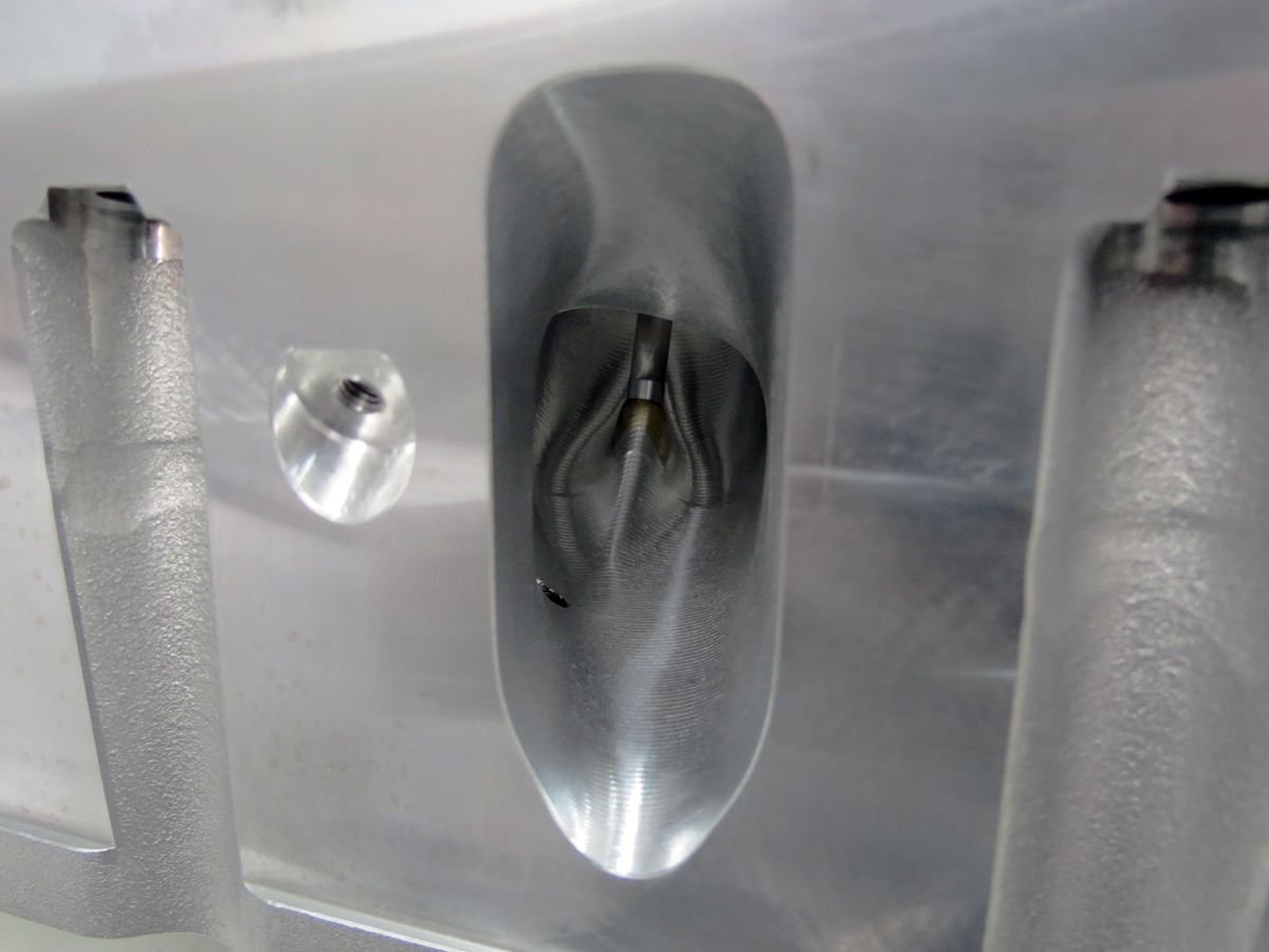

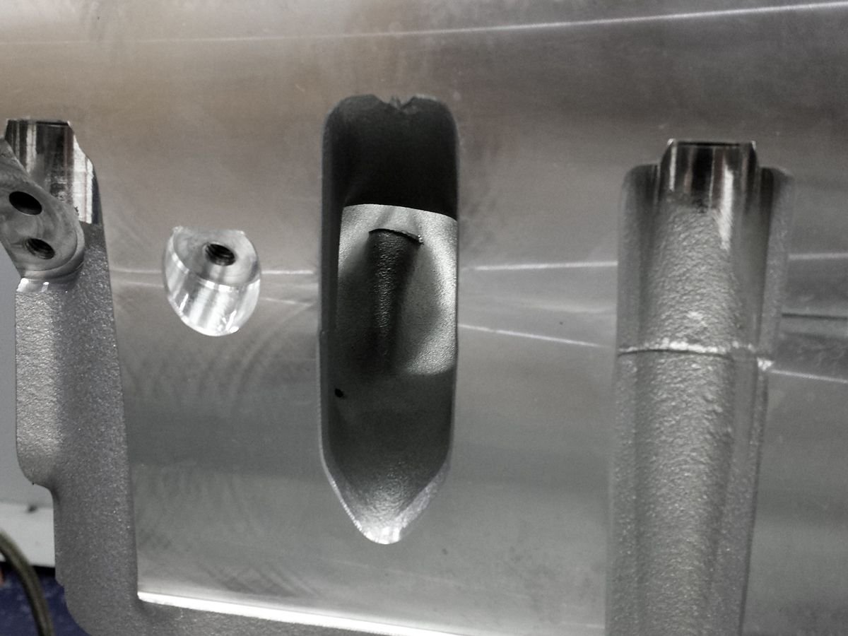

Here's a look at how we receive our TFS castings and what they look like after port work.
For those that don't know we receive them in a porter's casting (raw), and then run our port program through the heads which you'll see in the second image.
For anyone looking to upgrade to a set of TFS cylinder heads with the Frankenstein port program in the cat port version, we have two options.
TFS 237cc = $2900
TFS 254cc = $3250
-Russ

Do you have before and after flow numbers on say, 243 heads or any heads for that matter. I would really like to see the difference porting makes compared to stock.
Old Jun 5, 2017 | 11:30 AM
Frankenstein's Avatar
Joined: Oct 2015
Posts: 293
From: Texas
07NBSChevy,
Here you are:
BEFORE AFTER
Int: Int:
0.100 = 61 0.100 = 66
0.200 = 127 0.200 = 127
0.300 = 188 0.300 = 226
0.400 = 230 0.400 = 263
0.500 = 250 0.500 = 294
0.600 = 256 0.600 = 304
0.700 = 240 0.700 = 309
Exh:
0.100 = 50 0.100 = 56
0.200 = 104 0.200 = 108
0.300 = 140 0.300 = 150
0.400 = 162 0.400 = 176
0.500 = 170 0.500 = 208
0.600 = 177 0.600 = 221
0.700 = 182 0.700 = 228
-Russ

Any flow numbers on the 237cc? My 215s have been great from TEA (5+ years) and man the numbers still amaze me. Just always curious what a bigger head would do on my current setup.
Old Jun 15, 2017 | 08:12 AM
Joined: Oct 2015
Posts: 293
From: Texas
Intake Volume 237cc
Exhaust Volume 83cc
Chamber Volume 65cc
Intake Flow 292cfm @ .400”
348cfm @ .700”
Exhaust Flow 218cfm @ .400”
255cfm @ .700”
PAC spring kit included good to .700” lift
Intake Valve Diameter 2.080”
Intake Seat Material Ductile Iron
Exhaust Valve Diameter 1.600”
Exhaust Seat Material Ductile Iron
Valve Angle 13.5
Valve Guide Material Bronze Alloy
Minimum Bore Size 4.030”
