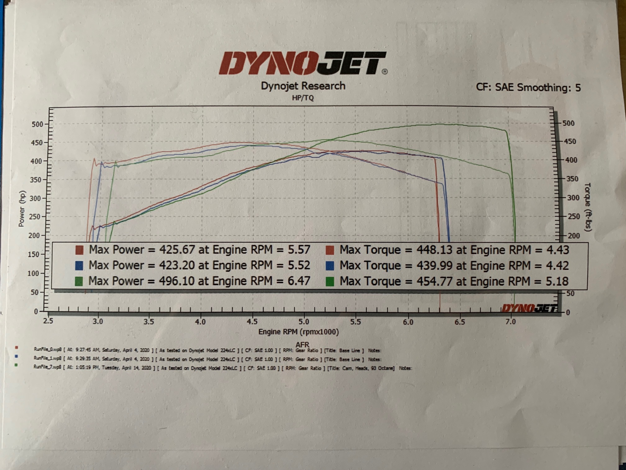

Just for accuracy if anyone searches, I'm posting not to argue but to give a data point. It was designed to run with manners. It isn't a max effort cam.
Driving videos:
Dyno sheet. It doesn't fall on it's face at 6000rpm as has been suggested by big exhaust duration guys. I've used it many, many times with similar results. It runs hard out to >6600rpm. Someone suggested it dies earlier than the stock cam at 6100.

Mr. Spin! Glad to see you back here. Thank you for putting the armchair cam guru's to bed. Please post more here. Some, like me, appreciate your knowledge.

I did see another dyno sheet where it did fall off early but maybe it wasn't set up well.
Back when I did my research there were some ok combos and some were so so.
Good on you though for doing all the work and giving us the data.
Do you know have any 1/4 mile times?

I had well over two dozen dyno results and they all looked the same. Various Corvette form installs that I didn't save the dyno sheet for had the same result. Just recently a result was posted:
https://www.corvetteforum.com/forums...no-thread.html
His dyno sheet looks exactly the same and doesn't fall off the map up to 470rw @ 7000rpms.:
Cams can be ground wrong, ect. I even tried a single pattern 230/230 on a 114+1 to run on A6 cars but getting people to buy a single pattern cam is like trying to sell bathing suits in Alaska. The single pattern ran out to 6300rpm for the peak. Of course after PatrickG ran a 231/231 on his G8 making over 500rw, it became possible to some that big splits weren't the only game in town but it was quickly forgotten.
https://ls1tech.com/forums/generatio...am-spec-s.html
Various corvettes were used for different purposes, It runs the same result any 480-500rwhp car would run. It wasn't meant for racing and it wasn't max effort. It was a daily driver street cam used by us old guys. Here is the first install. He ran trap speeds of up to 129 with it. ET of course will vary driver to driver.
https://www.corvetteforum.com/forums...ivability.html
It's a great manners daily driver cam that keeps up with quite a few cams that are bigger and drive like crap due to overlap. Everything in life is a compromise. All cam designs start with a base goal. This one was that overlap had to be as low as possible. Power was secondary. Many cam guru's start with a wide split because the theory is that the LS3 heads require it. There are literally dozens of LS3 cars running this 4 degree split cam running power as high as the dyno sheet shows and still the myth goes on even with the proof right there in front of them. I would think that if even one car makes power to 7k with a 4 degree split, the myth was proven false.
I've posted dyno sheets, a thread with track results, and video showing the driving manners in this thread. I think if someone still buys into the myth after 12 years, it's there to stay.

That's good data.
You also have good points.
Even after all these years, all camshaft gurus I have seen spec camshafts at least with an 8 degree split.
Brian Tooley's grinds are much larger again.
Maybe you could use a real narrow split if you increased the intake duration some, so it would hang on even better up top?
So many ways to skin a cat I guess.
No real right or wrong answer.
Compromises are where it's at.
It would be interesting if you tried this on an LS7 style head.

You sell more cams by not bucking the trend. If people want more than 8 degrees give it to them. Why make a cam no one will buy? If I was in the business, I'd be cranking out 8+ degree splits forever but I never sold a single cam. I made the first one for my car and it worked so I shared the specs for free. I can post 20 dyno sheets that buck the big split trend but I'd be wasting my time.
By the way I recall the first post in 2008 that started the kool-aid drinking. I read that GM used a 211/230 in the Z06 and the LS3 head is based on that head so it must need a big split.
Anyway, if even one cam makes power up top without the split, then a big split isn't needed. This 230/234 in the above dyno sheet it made 470rwhp at 7000rpm on a 6.2L. What am I missing?
