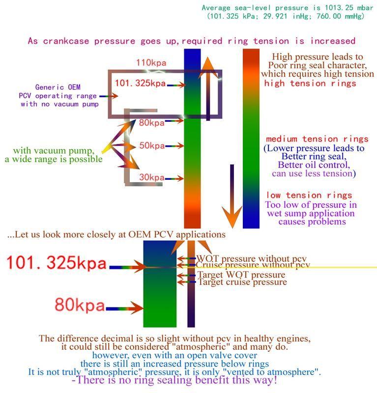

This is the "big picture" showing all pressure ranges possible and application specific detail
"let us look more closely at OEM pcv applications" Exactly mirrors sentiments from all above posts I have made regarding pressure differences using actual numbers for extremely accurate explanation of what the OEM pcv is trying to achieve for the crankcase system and how to use it to your advantage.

The part you seem to be overlooking is that performance builds often exceed the capability of the stock PCV system and forces vapor/oil out of the fresh air side of the system and this has been well documented on LS based engines. It happens quite often on completely stock engine once they have started to wear considerably. I've seen it happen to low mileage stock engines that have seen sustained high rpm usage (highway pulls). These engines are also sensitive to the type of oil being used to the point that engines might use 2-3 quarts between oil changes suddenly only using a qt because of a brand change.
Have definitely NOT overlooked that aspect. I have addressed several times what the options are when one exceeds oem pcv capability.
Almost every engine will be exceeded once it's oem output is tripled, this is a general assumption, not LS specific and definitely gone over repeatedly in previous posts.
If you have trouble finding them I'll link a bunch, I guess, but try first at least to find at least one
A stock type PCV system does nothing for ring seal...not even a little because it's not a closed system, all it does is pull air from the intake side of the system to the manifold, It does not create a vacuum in the oil pan so it does not help ring seal. Think about what you're implying for a second, You're basically saying that under wide open throttle your manifold has enough vacuum to pull on the oil pan so hard through a small hose that it overcomes the fresh air inlet and the blow by the engine produces to the point that you would have a measurable negative reading at the pan... I'll guarantee you that's not happening.
Hook up a gauge on your oil pan and show me how much vacuum it reads..... If it has reading at all it will be a positive reading because you done blew your **** up lol
I'm not saying anything. I'm hooking a pressure gauge to the crankcase and taking measurements. For many years, on many different engines. And trying to understand how the OEM apply crankcase vacuum situations on various vehicles. And this data is presented, and now arrive to several conclusions. Your statement is wild and confused and has no bearing on anything because you have no data, no numbers, so it's just a bunch of words which to you mean something completely different than what they mean to me.
I've explain this a hundred times on the internet but I'll do it again for you now. If the engine is running and you put your hand over the throttle body to block it completely, what is the pressure inside the intake manifold at that moment? It will be very low. Perhaps 20" and then the engine will die from lack of air molecules. Even if the engine is at WOT.
The OEM take advantage of, and design their orifices with this principle in mind. That is, they create systems which use dry paper filters sized appropriately such that average life-cycle performance creates a pressure drop (a "hand" over the intake tube) of approx 1-2"(sometimes 3") Hg during WOT. Since the pressure at WOT inside the crankcase of such engines is typically 1~psi (healthy) there is quite a difference between them (1psi vs -2psi) and the WOT pcv functions to pull some of that (oily, carbony, tainted flow) out of the crankcase before it can interact with engine oil or attack oil seals.
A PCV system is not vital for performance as it actually hurts instead of helping. Like I've said many times already, You're sucking oil/combustion vapors into the combustion chamber, That brings down the octane rating and can lead to knock....What does the computer do when it see's knock? It pulls timing. Pulling timing does not help performance. The fact is a PCV system is an emission component not a performance component. On a stock engine I leave it fully functional because it does serve a purpose, On a performance engine where I want to make as much power as the combination is capable of then I don't run them, I run a catch can.
You want the best of both worlds you run a vacuum pump where you actually do help ring seal and you can actually pull the vapors from the engine....Yes you can run a vacuum pump on a wet sump system...it's done all the time and you would know this if you had any practical real world experience with high performance engines.
EDIT: Why can't you just admit when you really don't know what you are talking about? You seem semi intelligent but lack common sense, I know you have very little experience with V8 engines and even less when it comes to the LS variety. Sometimes you should learn from people who have first hand experience and quit relying your book smarts because that usually makes you look foolish. I'm not right all the time and will admit when I'm wrong and still learn something every day.

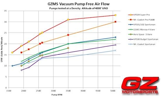

And I’d love to see an engine get 100+ hp from a vacuum pump, as you stated above. Most see 10-20.
i mean, is ur google crippled? or just lazy
One of the first thing we show beginner students in performance application is vacuum pump + blower = 100hp on the right engine
random google1
We now see a 2-4% horsepower gain with vacuum pump systems, and we’ve seen it on everything from a small four cylinders to a 903 cubic inch nitrous Pro Mod motors.
I am sure at 900cid pro mod motor is not without a vacuum pump and that it is worth 100hp+
It's relative to size of engine and how much boost pressure. On any machine if there is a way to adjust a pressure (sigh... differential) with a dial (vacuum pump strategy and boost control strategy) this is an enormous benefit to the control and operation is often greatly influenced.
One pressure can be very low (crankcase) and one can be very high (intake manifold). Think about being on the intake stroke just as the intake valve opens and the piston begins to descend, what sort of pressure would you prefer just below the piston as it descends? Wouldn't it be nice if there was a very strong vacuum, not only will piston be willing to descend faster it could promote faster rate of incoming fresh air intake charge (the pressure between first and second ring is low because molecules normally found there are taken up by the crankcase pcv). This is a great opportunity for vacuum pump to add power by improving ring character for what is already a very high output engine.
You won't get 100hp from a 150hp 4-cylinder by pulling a vacuum. ~500cid+ forced induction engines using 32psi+ of boost pressure it must be worth 100hp or around that.
The engines get sealed up really well and dyno tested if the builder is doing it right
vacuum pumps come in all shapes and sizes right
From google search2 "Does a vacuum pump add horsepower?"
On high-rpm race engines, enough positive pressure can build up in the crankcase during the piston's downward travel to adversely affect cylinder wall ring sealing. Overcoming positive crankcase pressure also wastes horsepower and blows oil out of every crack and crevice of the engine.
sounds right to me
On a 631ci engine we measured 50 cbhp increase with -10 in/hg
https://www.yellowbullet.com/forum/s...3&postcount=52
For naturally aspirated and Forced induction engines, vacuum functions as an oil containment feature of the crankcase.
Because vacuum helps keep oil in the crankcase like I've been saying since the start.
The question isn't do I want a low pressure in the crankcase or not... because we already established 100 times that you DO DEFINITELY want that.
simply venting is NOT enough. It isn't even "average" or "good" its just "temporarily, barely adequate".
Our GOAL is to provide the vacuum some way. any way we can. Because the benefits...
more reads
https://www.yellowbullet.com/forum/s...d.php?t=531428
just use search
I'm not an expert But I am a fan. You want a clean charge. Crank spins easier through less windage. Rings seal a little better. All a benifit in my book.
vacuum is good
https://ls1tech.com/forums/forced-in...l#post16159254
wow these guys really go all out with the stringy details
Pulling vacuum with a dedicated pump has been the preferred method for well over two decades now and the technology has steadily advanced with important performance benefits that include:
  • Improved ring seal by relieving crankcase pressure below the rings
  • Reduced friction by allowing lighter tension rings
  • Reduced windage around the rotating assembly
  • Improved oil scavenging
  • Reduced parasitic pumping losses
  • Minimized cavitation (in wet sump applications)
  • Reduced lubricant contamination
  • Improved bay to bay breathing in Y-block configurations
  • Improved power via reduced mixture contamination
  • Reduced gas port contamination
As I was saying, the benefits are worth the effort, you try to achieve and measure this pressure as a critical 'performance'(cleanliness) component. If you show me a racing engine immediately I am looking for crankcase pressure sensor and investigate pcv effort. It tells much about the person in charge of the engine. A catch can or vent is the sign of an id10t overlooking and negating all of those benefits due to laziness or lack of understanding. Be ashamed for allowing this awful practice perpetuate
Only with crankcase pressure log/data can you manage complete engine control, it is an absolutely critical components of controlling an engine in a 'performance' application.
More important than boost pressure and almost as important as oil pressure IMO
