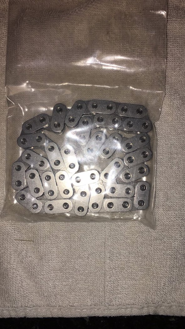

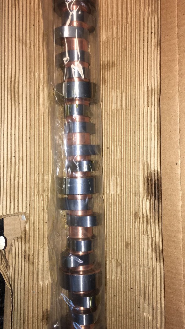

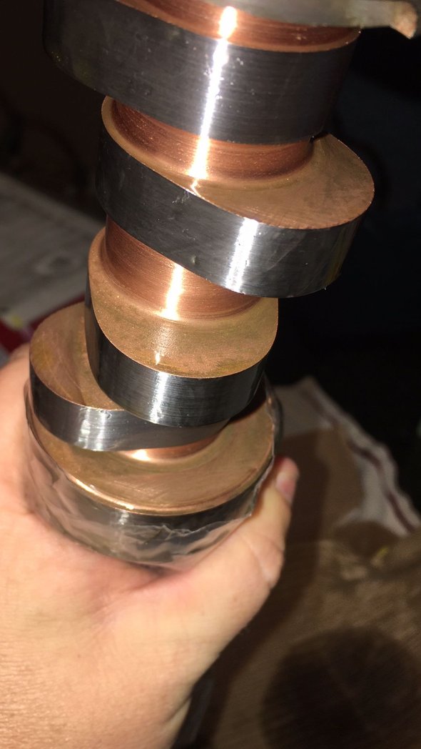

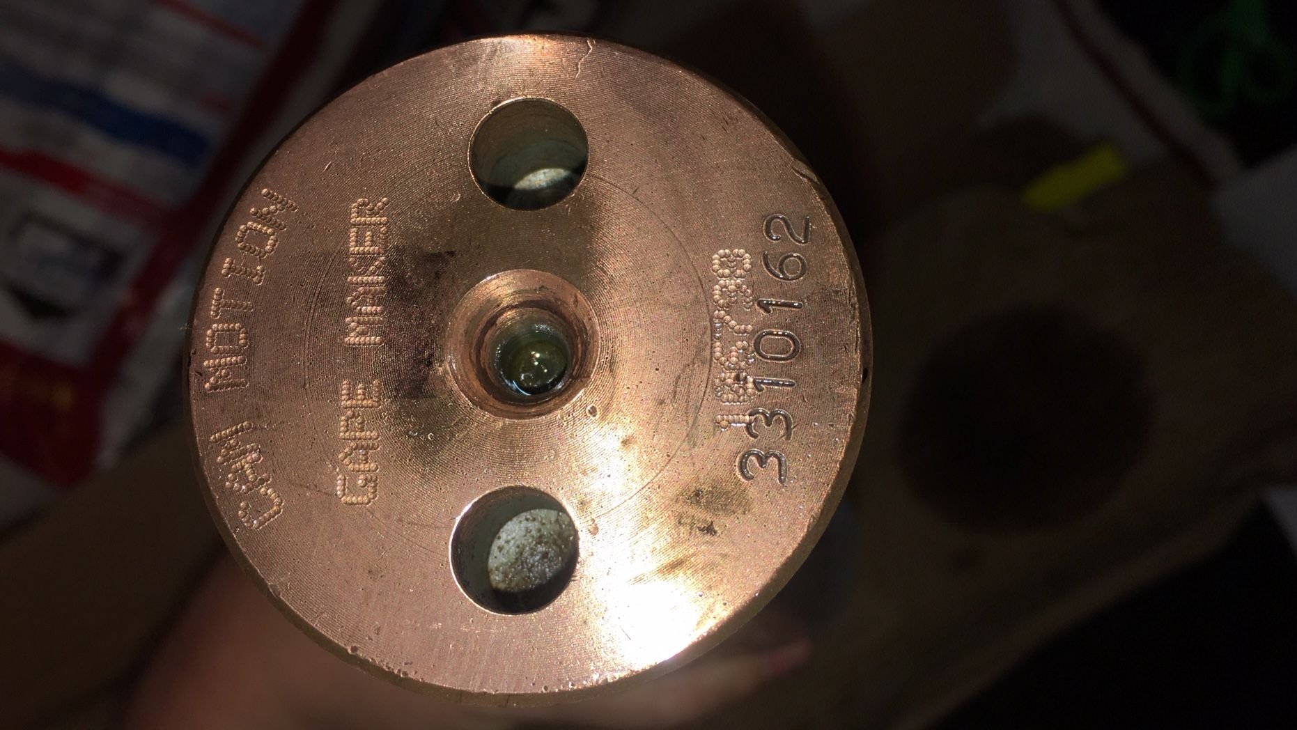

Goodies starting to arrive. Cam card says 1.7 RR, but actually using 1.8. Gross lift will be .747/.729. Nice looking lobe profile too. As high as that lift is, it won't be too abusive.

Originally Posted by bortous
Looking good Darth.
Did you end up getting the morel or crane axle oiled lifters?
I like the Gapemaker.
Reminds me of a vagina for some reason.
Damn that is some high lift.
Do they heads flow at that lift?
Thanks, mate!
I"m not sure which make they are, but I bought through cam motion. Likely the cranes. The heads reach their target flow (for me) at 700 lift, and do not stall until 800 lift. The real reason I wanted 750 lift was for duration at 700 lift to be more than an instant. I'm planning to run about .002 lash cold to slightly reduce seat to seat timing without impacting 050 timing. This should make for decent vacuum even with a monster cam. This thing is going to BARK at idle. Might have to name the exhaust note "Window Breaker"
