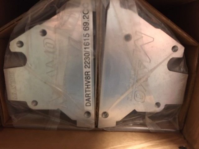

Get your tissues ready...... Parts **** Ahoy!!! When you see the 69.2cc, I have 2.5 CC domes on the pistons. Would have been milled to 66.7 cc without the domes. Typically you see people think in 1.0 or 0.5 cc increments. Tony obviously put a lot of thought into hitting our CR target as closely as possible.

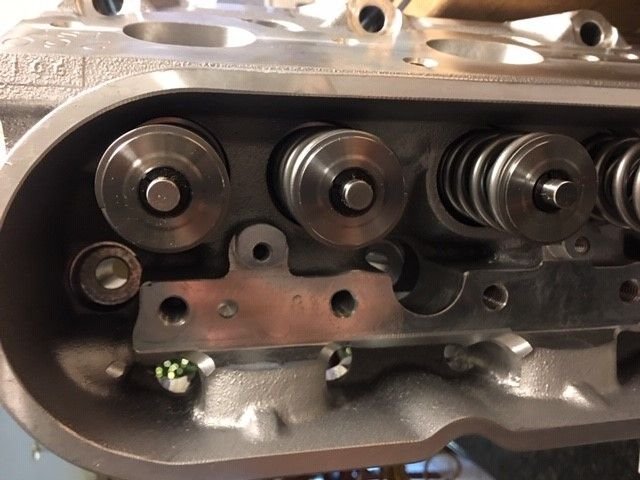

I tried to get it to show up, but if you know where to look you can see the hardened tips on the Titanium valves. I'm waiting for confirmation from Tony, but it appears as though I will not need lash caps

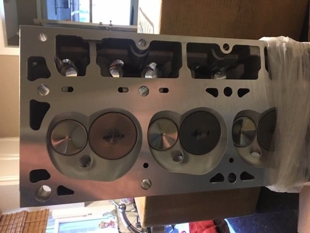

I took this picture focusing more on the tool marks. The flash makes them look pronounced, but to the touch, they are very subtle. Smoother than if the surface were knurled, if that makes any sense.
Combustion chambers. The pics do not show the intake valves very well. In person, they are enormous

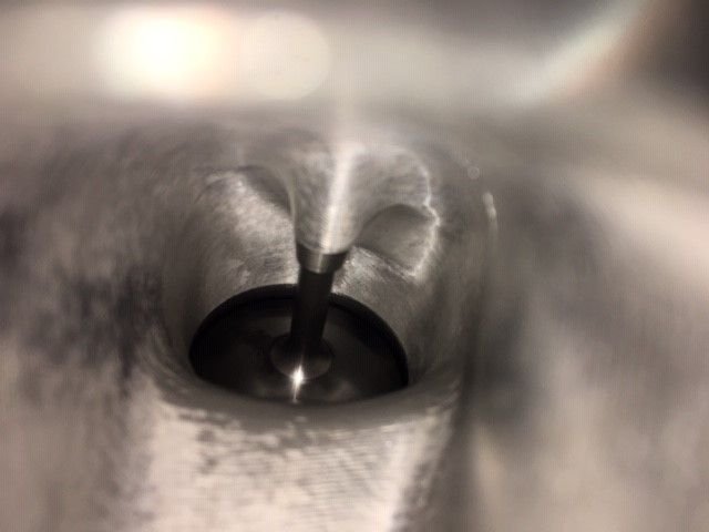

AA Battery for a size reference. Valves are massive.

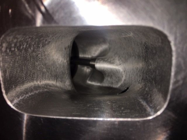

You can almost see the entire valve from the top of the port. Line of sight on these is amazing. Far better than what I had on the 220' cathedral heads, and I was impressed by those. You also can see the short side radius is much gentler than the cathedrals.

no lash caps needed sir
