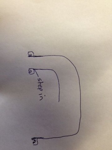

Originally Posted by Mickyinks
I bought these ones and they didnt fit
If the rocker cover doesnt step in like my hand drawn pick i couldnt get the holley talls to fit
Mickey -- wanted to post up, the sniper covers step in. They do the job well, they're just so crazy tall.
Old Jan 8, 2020 | 06:01 PM
  #442
Mickyinks's Avatar
Joined: Sep 2019
Posts: 818
Likes: 261
From: Melbourne, Australia
Thanx for letting me know. Ill buy some due to the covers im using i had to drill and tap to fix coil brackets to it.
They have the Ls1 bracket mounts built in
