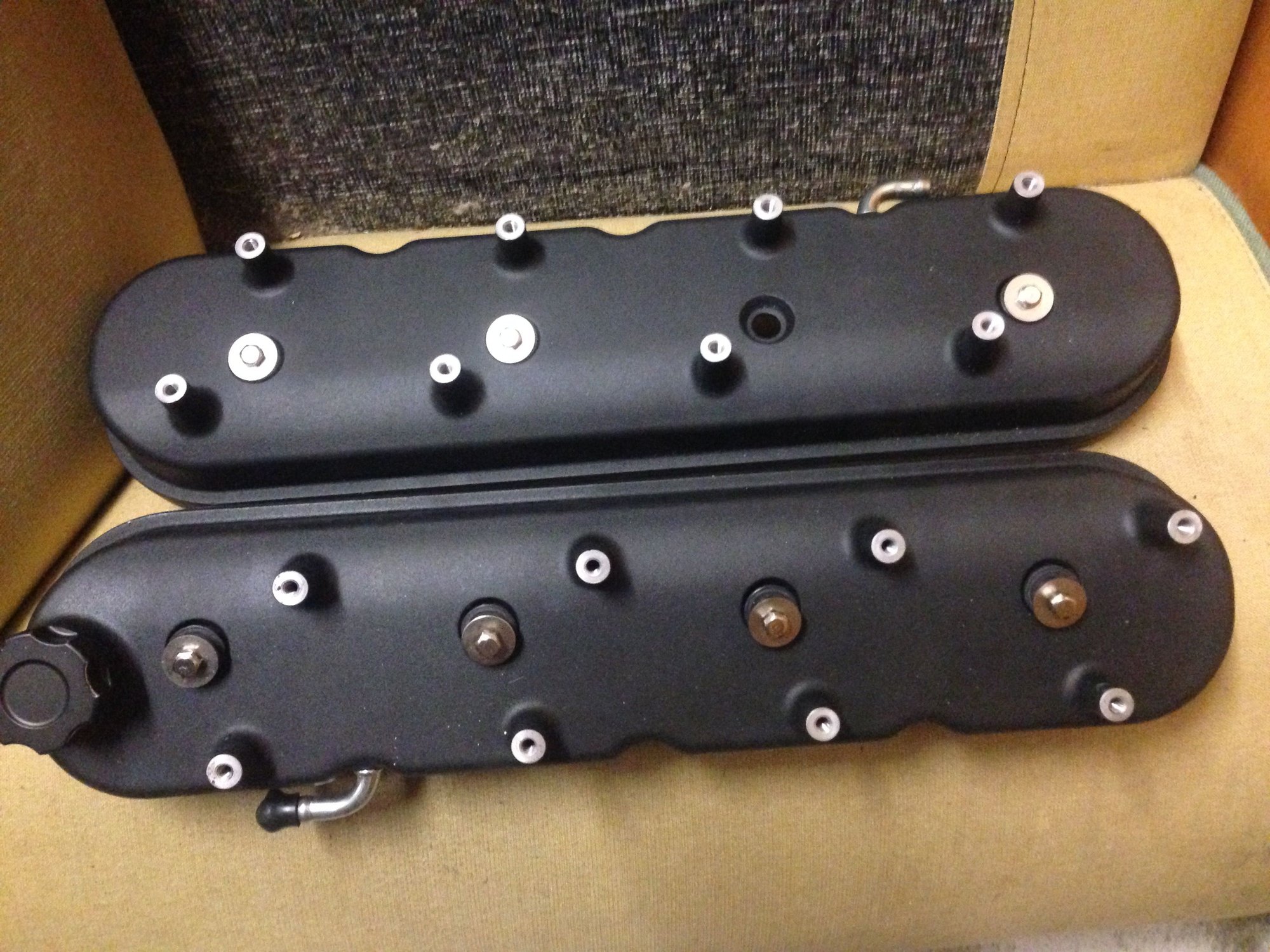

Old Jan 3, 2020 | 08:45 AM
  #420
98_WS6_M6's Avatar
iTrader: (18)
Joined: Sep 2002
Posts: 1,296
Likes: 98
From: NW Indiana
The thick YT gaskets and stock valve covers didn't work for me on my LS7 with adjustable YTs. It wasn't tall enough. I think Darth ran into the same issue because he had some thick gaskets I'm pretty sure. I reused my LS1 billet covers I had made for my YT's on that build and got lucky and they fit. Precision Metalcraft made them and I just got their tallest version. They fit really well. They made my intake for my boosted car too. Good company. Only issue with mine is they say LS1 lol
