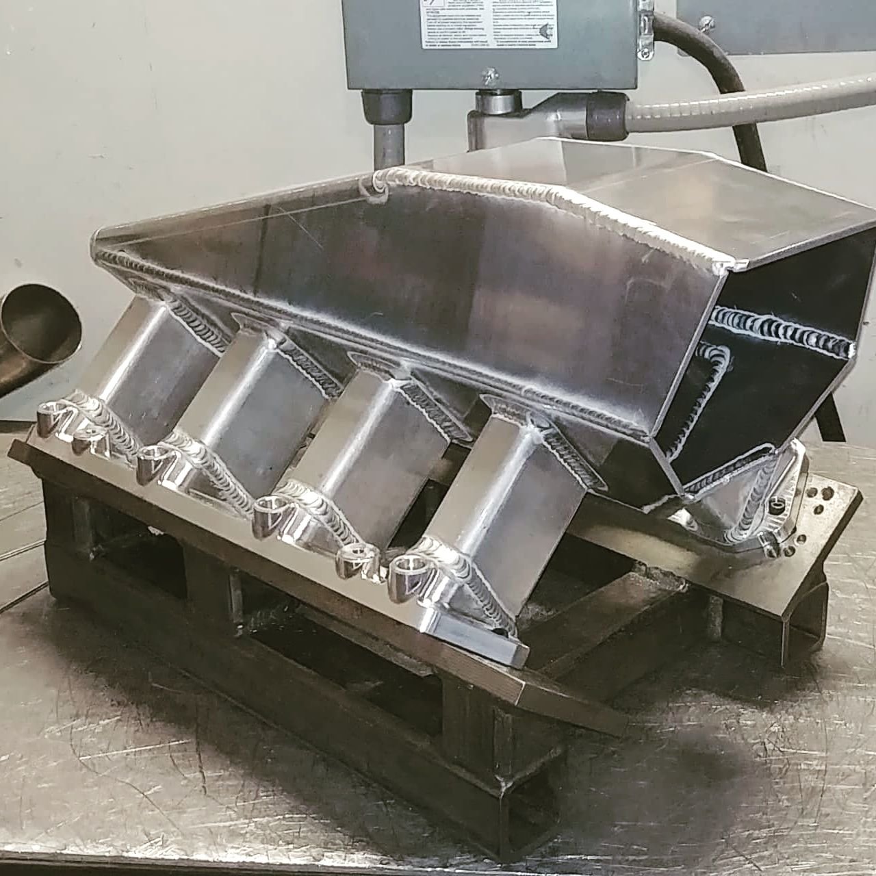

A CID and 4500 will walk the Dog on a ported by Anybody plastic intake. Fact! How? Read the above selection. Self explanatory! 4500 vs Whatever. If the intakes so great Y is it that Eric of HPR has told me and Qoute this.....MSD can not feed 400+ cfm. His 468 thru 528 cubic inch motors need a CID because a Plastic limited intake with a110+ mm Can Not supply the demand. If you believe anything other than that .......4500 flows more than anything you got so mores available. Besides the runner area. Measure and compare the area of 1 runner with a Fast,MSD,etc against a baseline of the listed port of the Holley. 1 problem we know you can't fix. The amount of air that we can make available 4500 vs whatever TB placed on front of any intake listed.

Good intake for what it is, but leaves cards on the table.

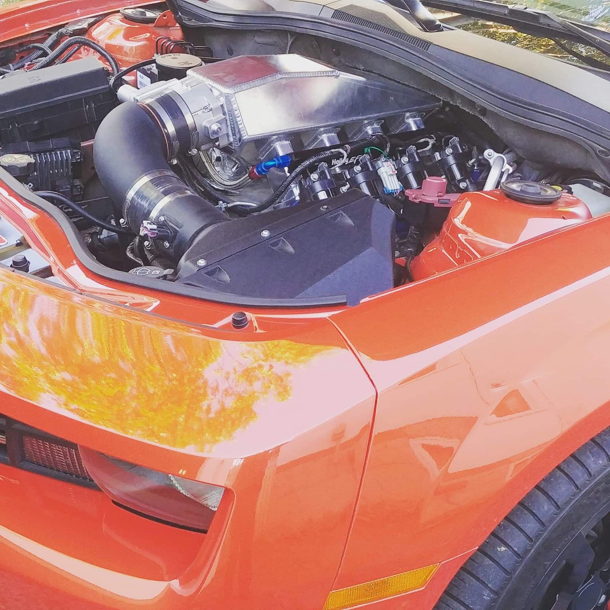

Just to put this out there. When I ordered my Mamo MSD from Tony I really wanted to at least put on a 105mm TB on it to try to get more air in as I do agree with Smokey on this. He told me with all his testing my motor didn't need any more tb and that my 102 was enough? I wanted him to port the opening to fit something bigger and would have paid extra. Now I wouldn't think he would want to turn away money but that was the response I got outta the conversation. I have a 13:8 compression 440 with Mast 305 black labels with a fairly large cam just for reference. You sure would think I would be a perfect candidate for more air! I sure wasn't going to question Tony of all people on airflow. LOL

Understandable.... 102 to a 110 will have a slight differences in cfm that's provided. 200 CFM. The young man with the 468 with intake testing speaks volumes.... remember what Eric the builder said. 528's thru 427's if the heads R flowing 400+ ...CID intake testing pending with a 528. Flat lining / gasping for more, 4500 to the rescue.
BTW nice intake.

People want exact #"s but this is as close as it gets use what's between your ears. CID intake with a 92mm does all the intakes listed #"s. Once a 4bbl is introduced game over. You may not want to face it but .....
