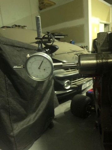

These are what clearances im running. Do you allow more for alloy blocks?
Mick, an aluminum block will grow .0010ish, where as a steel block will usually grow .003-.004. on average.

Thanks Scott, So would you think im a little on the tight side being iron block and running .0025 mains , rods are .0027
