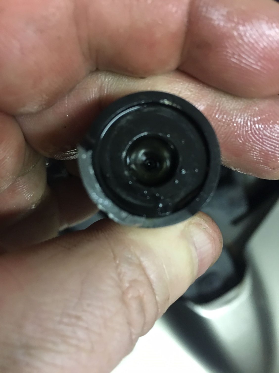

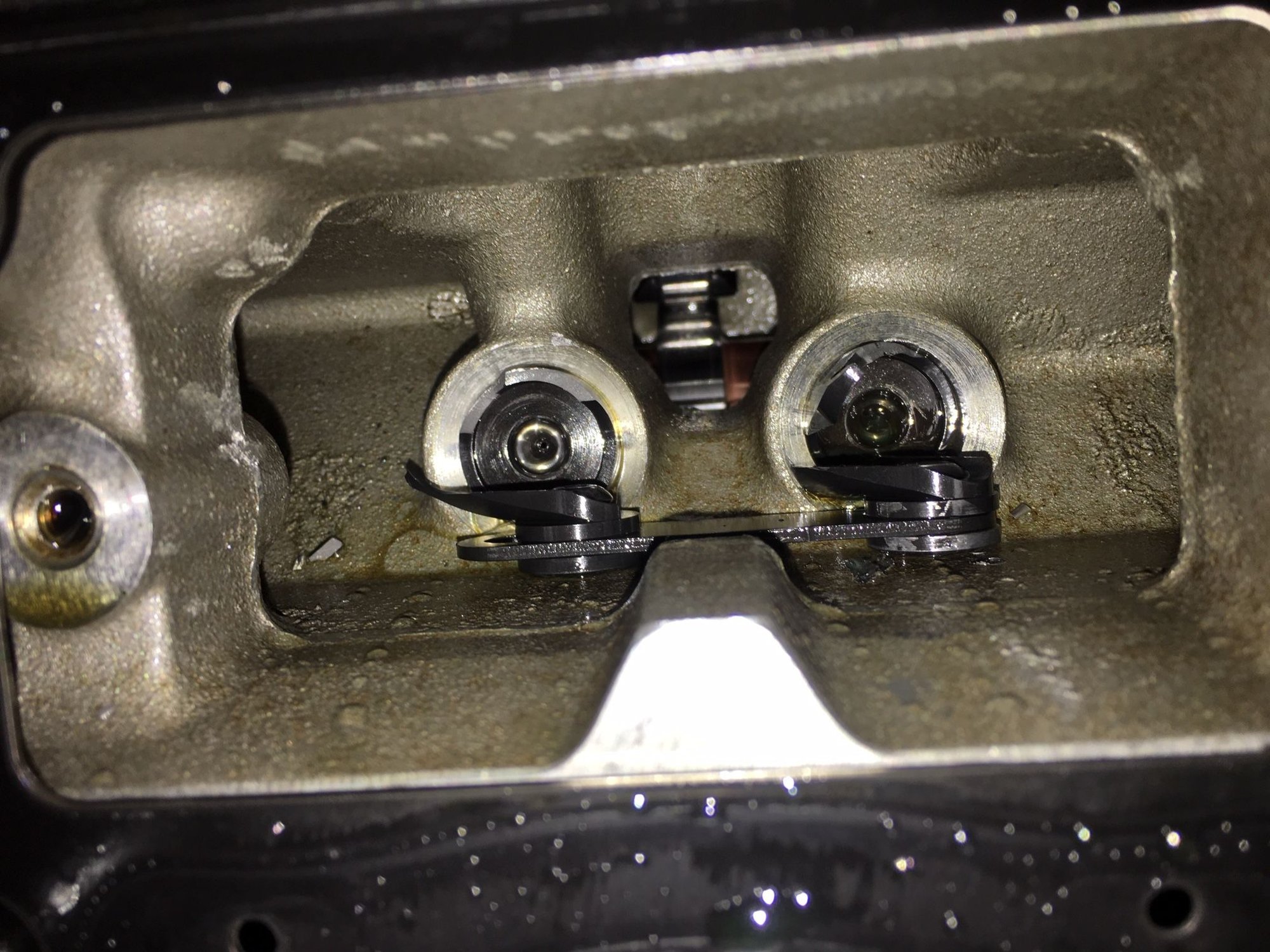

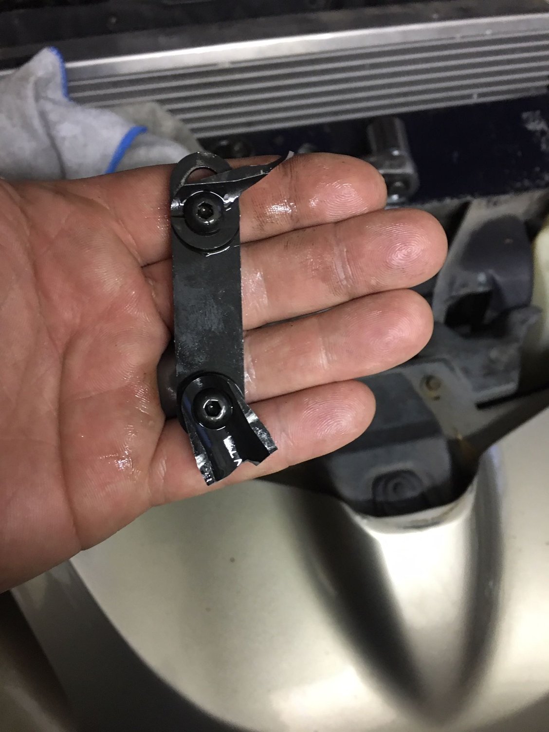

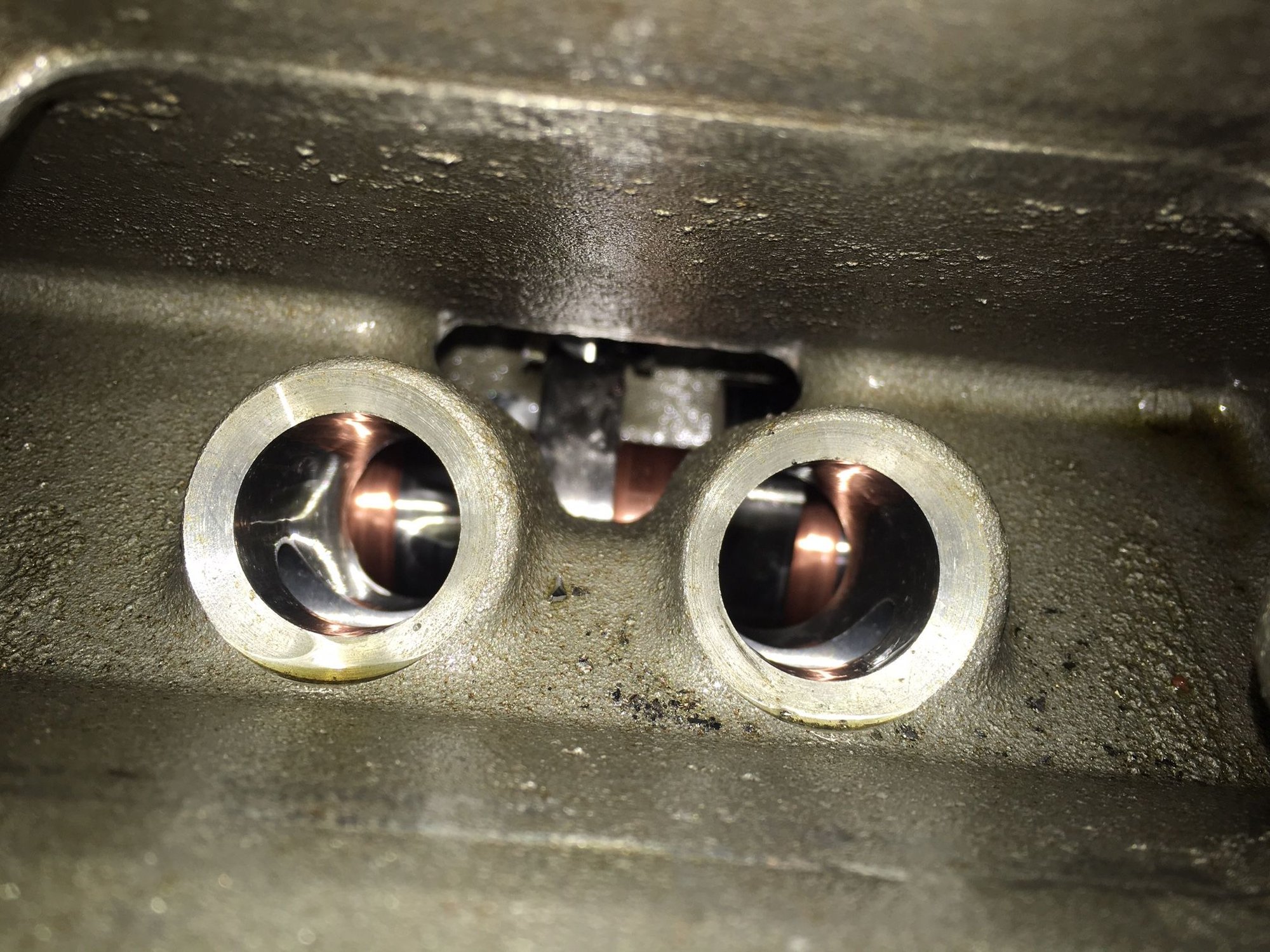

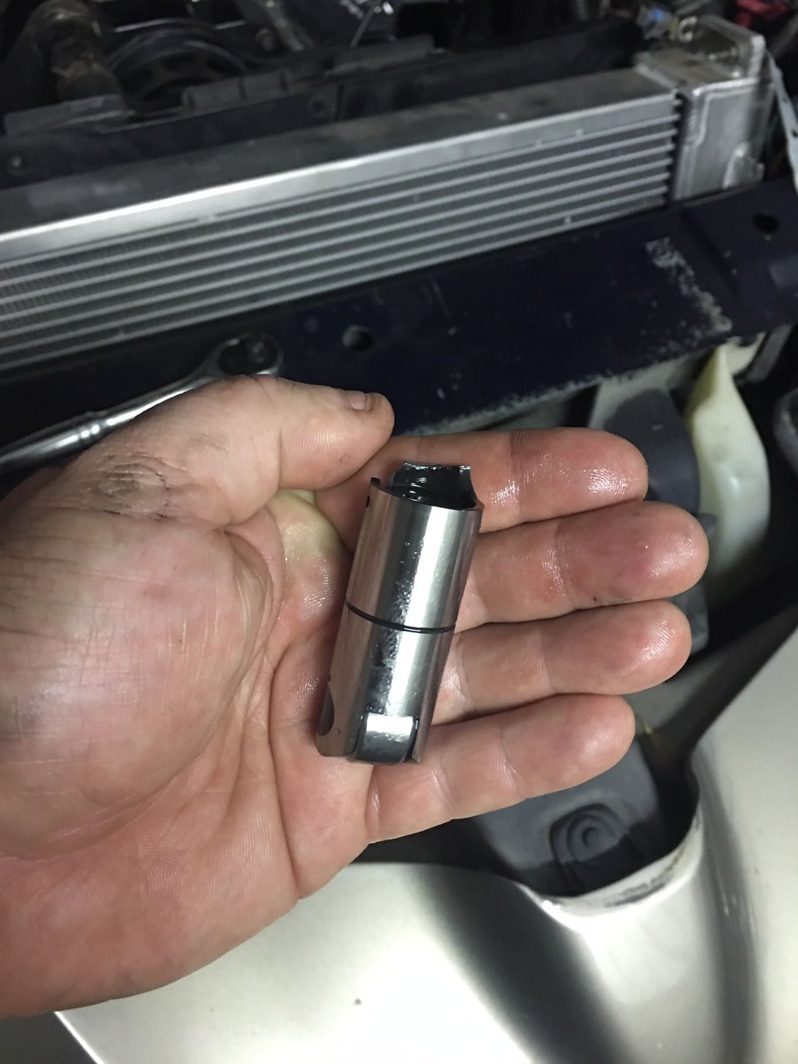

OK, so update time. It is on me. I am positive I got the pushrod up on the ledge. The pics will make sense. Everything is collateral damage from the pushrod. I should have pulled the head as soon as it happened, but I didn't. That said, here is the carnage now that I know the fault lies with me. Motor should come all the way out tonight. Cam Motion worked out a deal with me to help out, even though it's on me. They're a great vendor for sure. So, order of events....
1. Pushrod set up on the ledge, not in the cup
2. Pushrod comes out and goes between the link bar and lifter
3. Link bar binds up, and this pulls the lifters inward and causes the lifter body to break under the link bar rivets
4. Lifters not free to rotate and the exhaust side scrubs the lobe badly until it gets worn enough to knock the roller off.
5. You can see through the window in the block on the last pic that the lifter was hit on an angle, not straight on, so it definitely happened after the link bar separation, not before.
I can confirm the intake side lifter bore is still pristine. So if nothing got damaged and it's just a clean-up, this may not be as bad as it could have been.

Originally Posted by rkupon1
Totally sux. Whats gunna happen with the cylinder head? Fixable?
Yup. Weld repair. Its not in a structural spot
