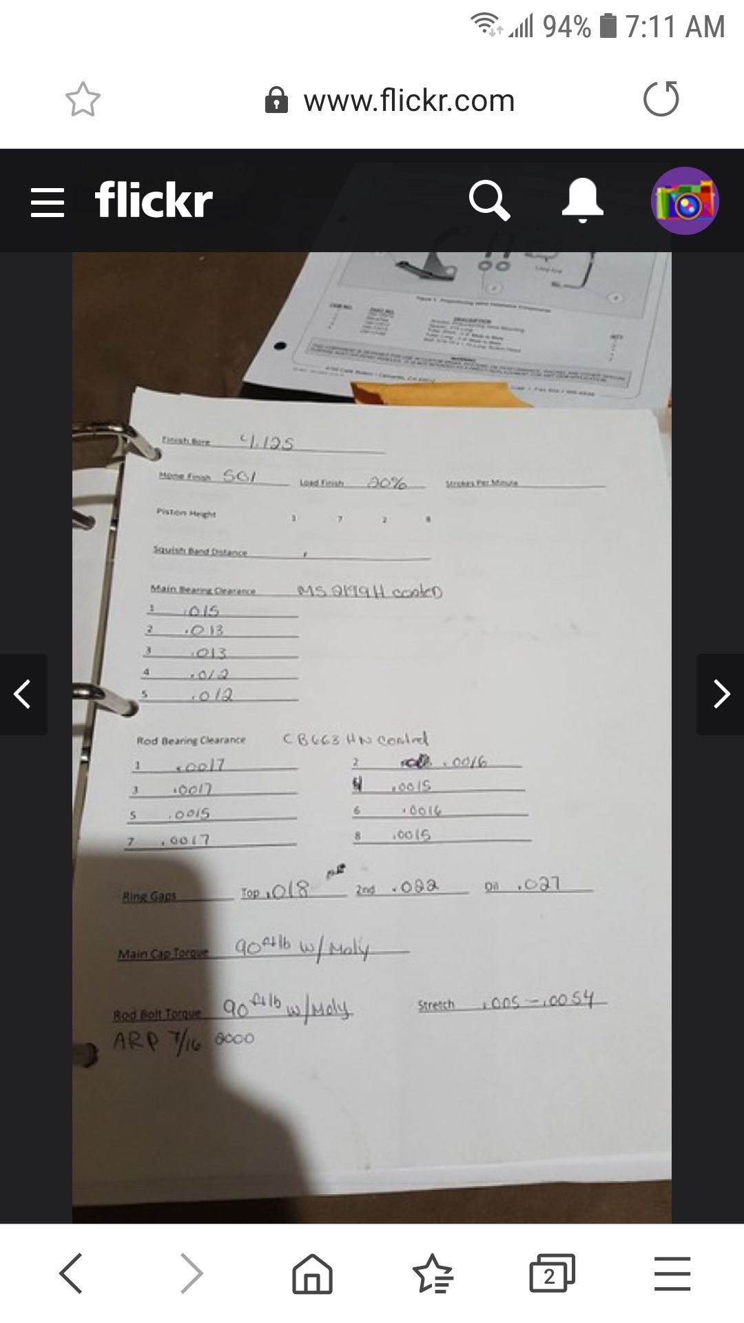

Originally Posted by Mickyinks
Thanks Scott, So would you think im a little on the tight side being iron block and running .0025 mains , rods are .0027
Mick your spot on with the steel LSX block. The block won’t grow like aluminum, but at the same time, it won’t flex like an aluminum block will either, so clearances stay much more consistent. I have the exact same dial bore gauge as you, btw...😜

FWIW, here are my clearances on my 427ci RHS alum. block w/coated bearings

Nice and consistent. 5W30?

Soon as we switch to synthetic I believe thats what he said...For now, we on 2nd Rotella T4 oil change...

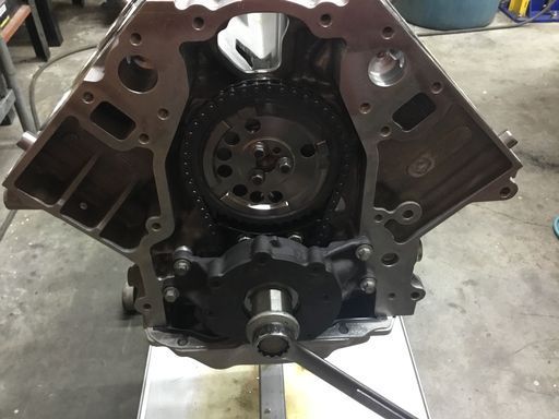

Projekt Lazarus - Numbers Posted!!-photo239.jpgProjekt Lazarus - Numbers Posted!!-photo649.jpg
Motor is wrapped up. Pic of head repair also.
I will try to get some more moteur **** later on.

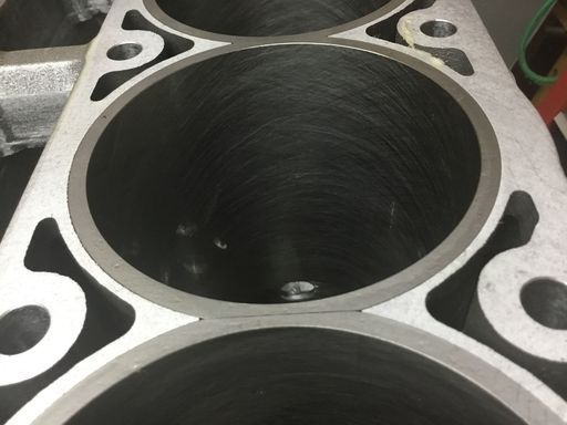

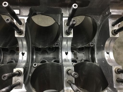

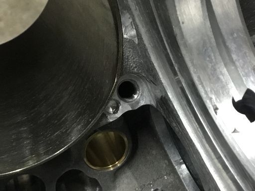

Lifter bushing
Look at those sexy holes!
Hone quality- picture does not do it justice, honestly
Valve is heavy AF, LOL. 2.25" valve weighs 74 grams.
Combustion chamber alignment with bore
Crank Scrapeur
Back side of a slug
Engage gaping nerds!
