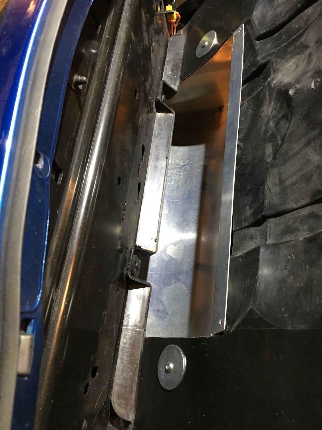

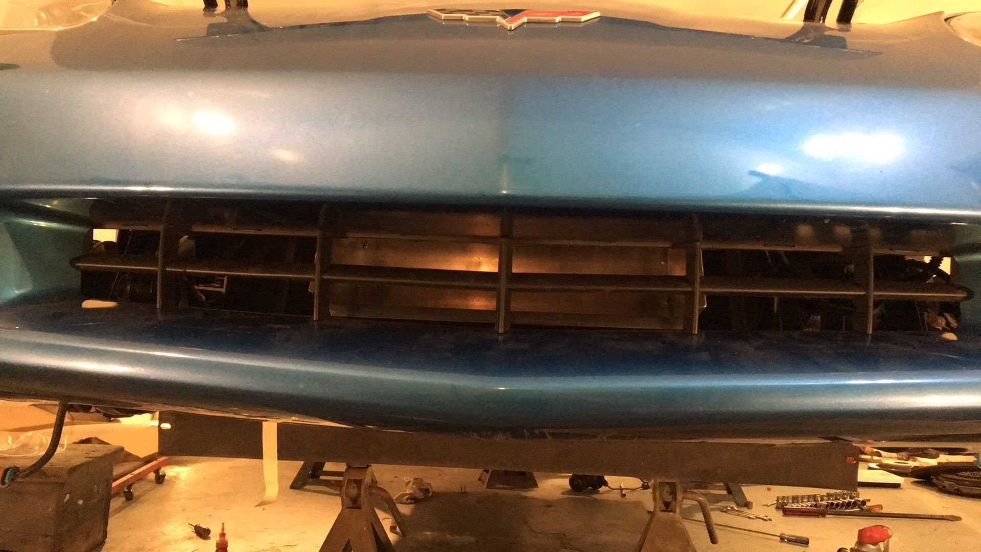

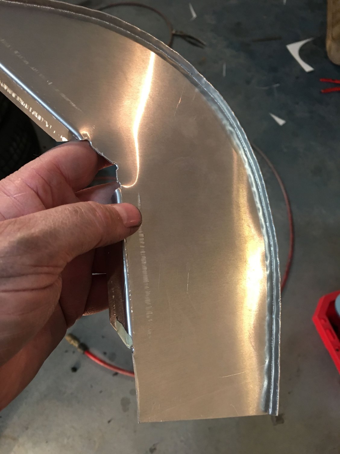

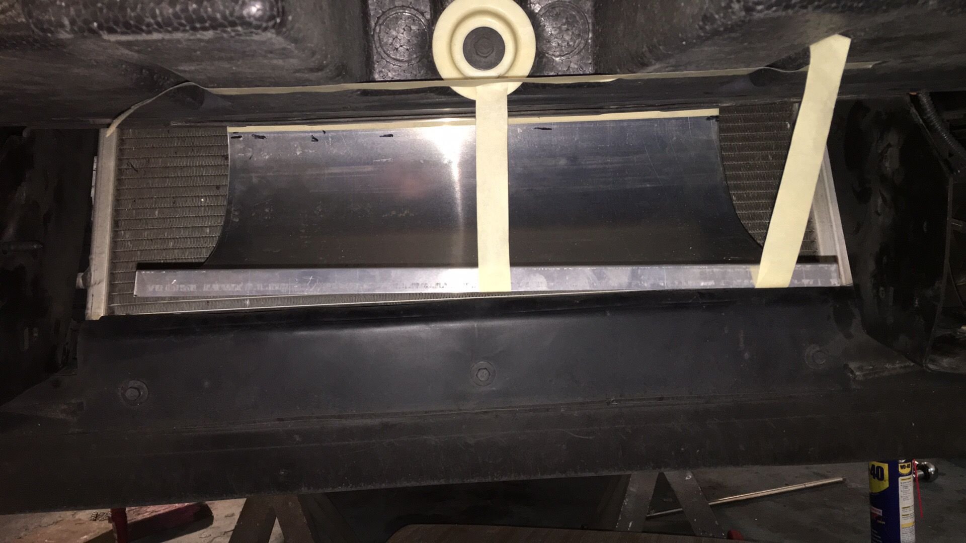

We manufactured my own ram air and utilized the stock filter housing. My car sees 96-101KPA. Vararams work well too

We just cut the silencer off and epoxied it.

Both accomplish the same goal. Depends on how I feel when I get there. Just sheet metal under the shroud?

Hand formed aluminum with some rivets holding it together.

Oh its got more structure than I was thinking. Will probably try and knock this out.

Love me some ram air!

So its basically just a scoop down through the shroud right? Do you have to cut the airbox? Just seal it back up?

Yea basically. I think we trimmed the filter box. Phil probably has some more pics

Sounds good. Itll probably make more sense when im hands on.
