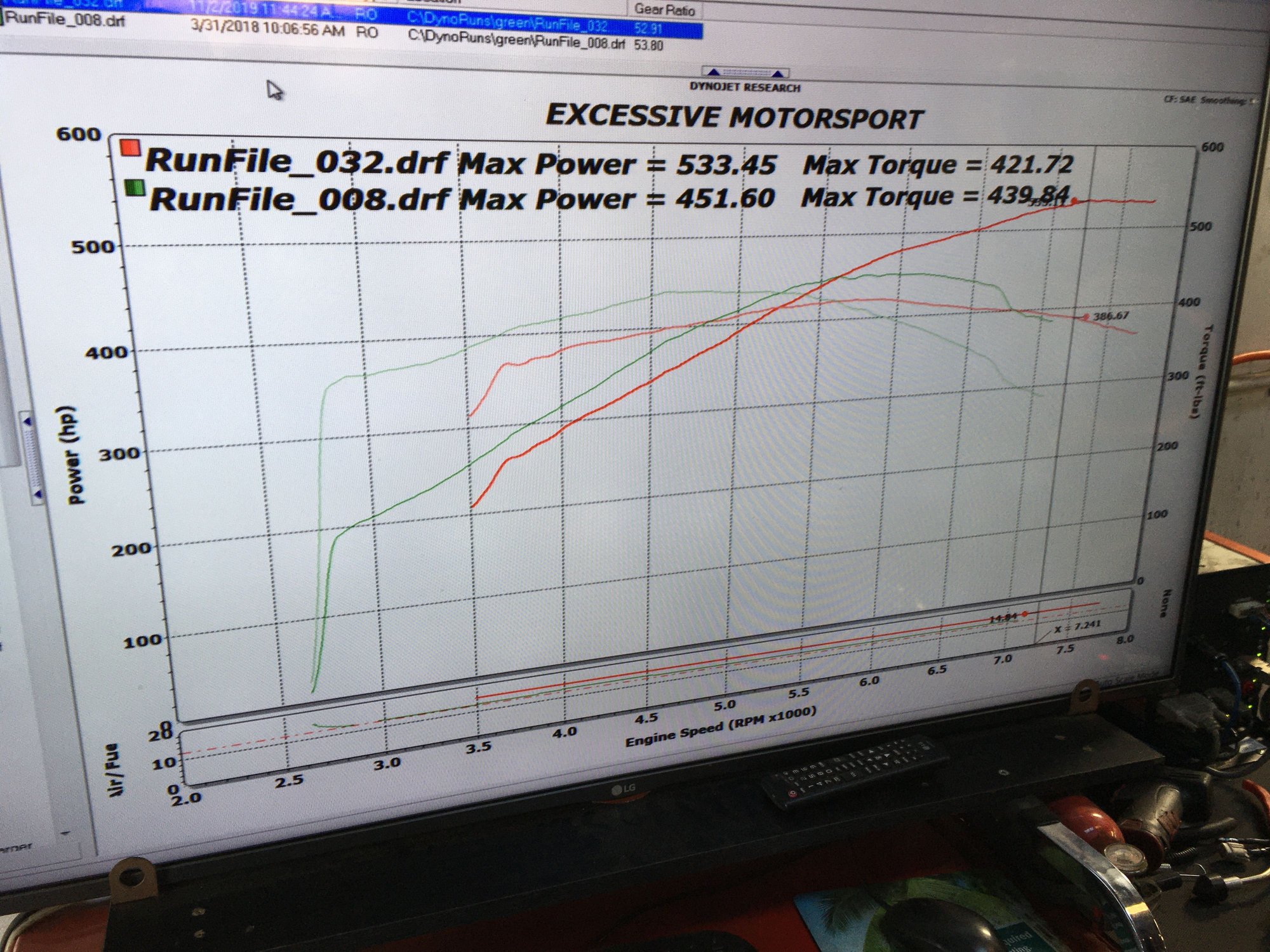

Here is comparison of bolt ons vrs heads cam

Power moved to the right....just a hair
