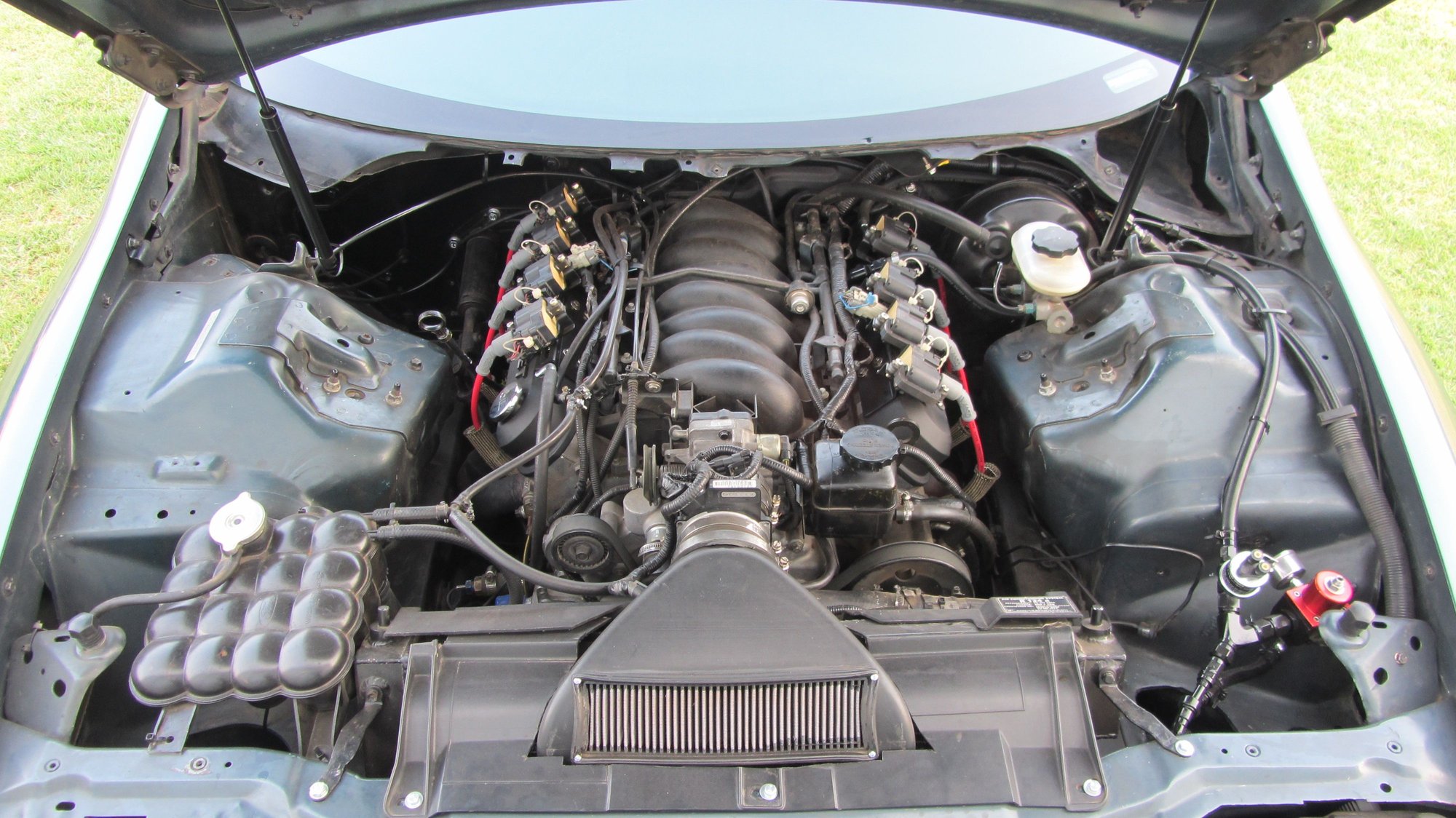

I don't know about you guys but I find it very frustrating working up top in the 4th Gen Fbody due to the air conditioning system and general engine compartment. I'm able to set valve lash from up top but I haven't done a spring swap yet. I'm still a ways off from when that day comes and I'll be dreading it until that day which is the price you pay for running an aggressive cam. I'm currently running a hydraulic but Steve with CamMotion spec'd a LLSR for me. Is it like a night and day difference in the performance between the hydraulic and solid?
I feel your pain. There was just no way I could leave the cowl on my 94 knowing that it was a car I will be modifying, changing engine combinations etc. So I cut out my cowl in one piece when I did the ls conversion, and I fabbed it so it bolts back in when needed, and the wipers go back in and work like standard. It is something that is not very difficult to do, if your engine is removed and you are competent using a 4" angle grinder. I don't want to hijack bort's new thread again too much with all the specifics, but his threads seem to get most of the discussion on here lately. I wrote about it in more detail and pics in Darth's build thread if you want to consider doing it.
The next thing I need to do is get a removable pin on fiberglass hood, not only for the weight benefit but because I've found the hood struts on these cars are also totally in the way of leaning over the engine from the side because the engine is set so far back the struts get in your way.
