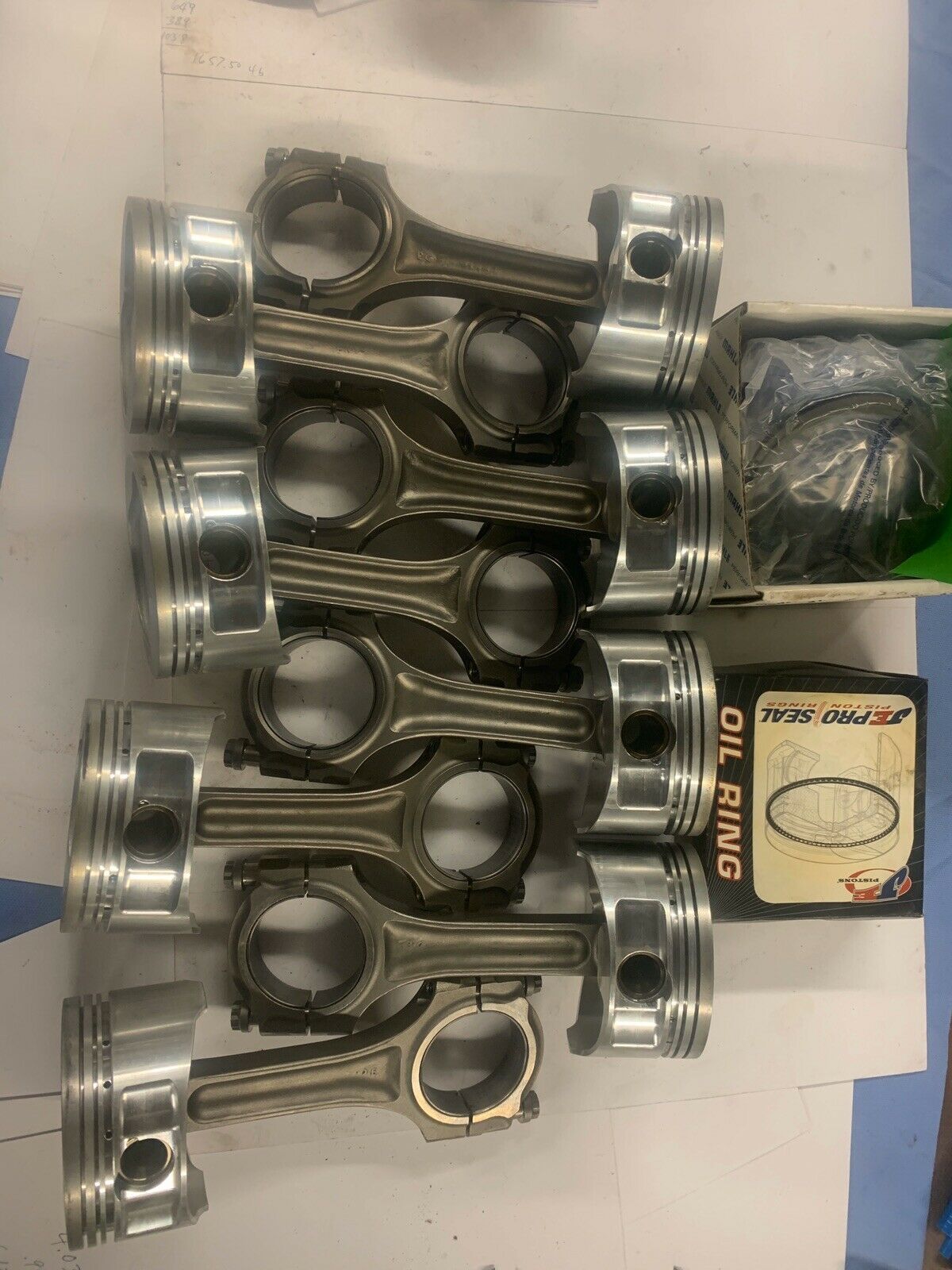

He did say they were only used one race and in excellent condition. Well i bought them, pic from the seller below. He will remove the pistons as he was selling them as a package deal but the pistons are no good to me. Because of our exchange rate and shipping/taxes they ended up $940 of our money so hopefully they are good. ARP also sell a replacement arp2000 bolt kit for these rods if needed, if i find any of the bolts don't stretch/torque properly, which i doubt if they've only been used once. These have the big 7/16 carr sps bolts. Hopefully the rods aren't too heavy and with forged pistons the total weight comes in under the weight of the gen4 rod/stock piston combo.
These are for my LS2 build and i was going to use the stock gen4 rods and run it SBE , but with forged pistons it wouldn't be SBE anyway. I've been holding out looking for a set of rods like this, but most of them that come along are honda size rod journals and the wrong width, typically not wide enough. These are a bit of a unicorn as they are the correct standard SBC dimensions, and 6.125" long. If there's a chance these rods might save me from grenading a long motor at 8k rpm versus a stock gen4 rod, they are worth the money.
I bought King HP bi-metal rod bearings a while ago but not sure if i should use those or something better. If anyone has any opinions on those.
