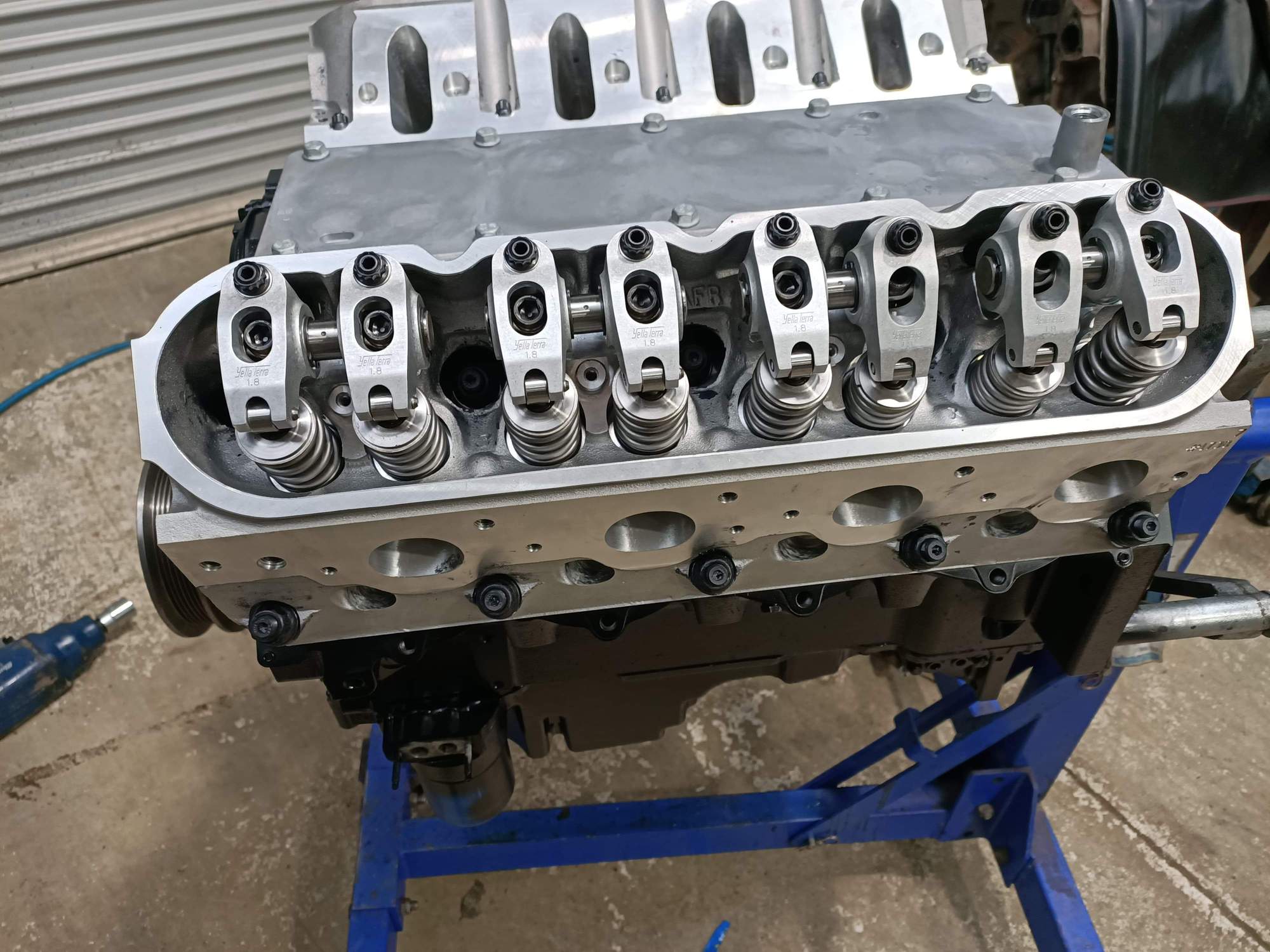

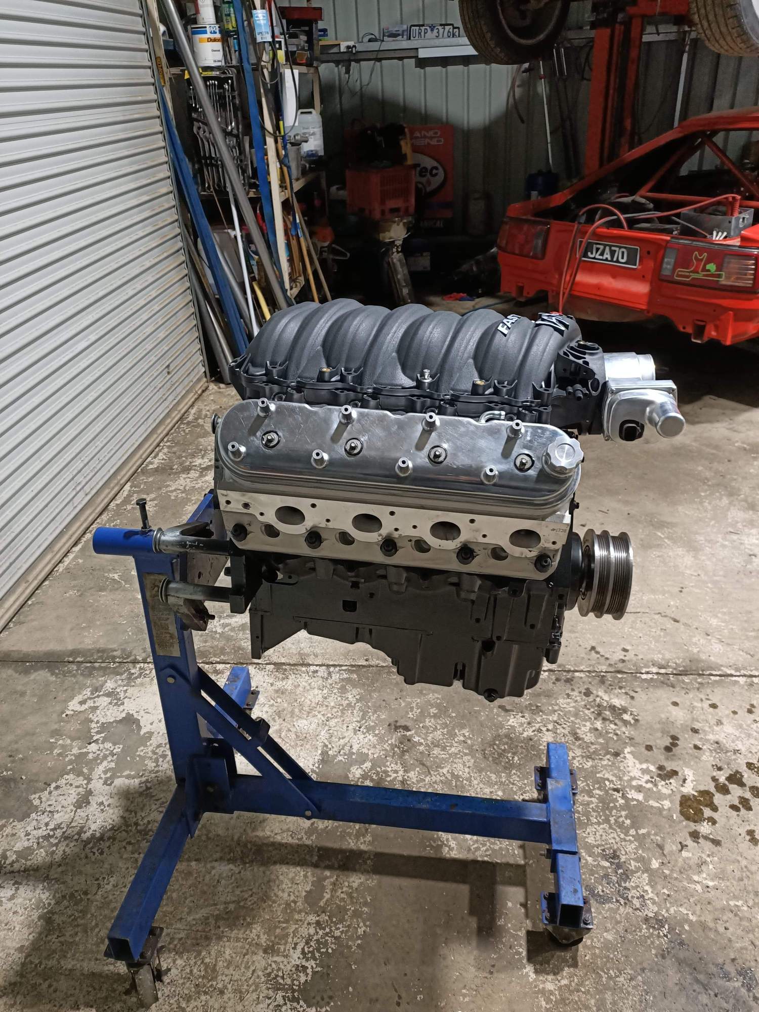

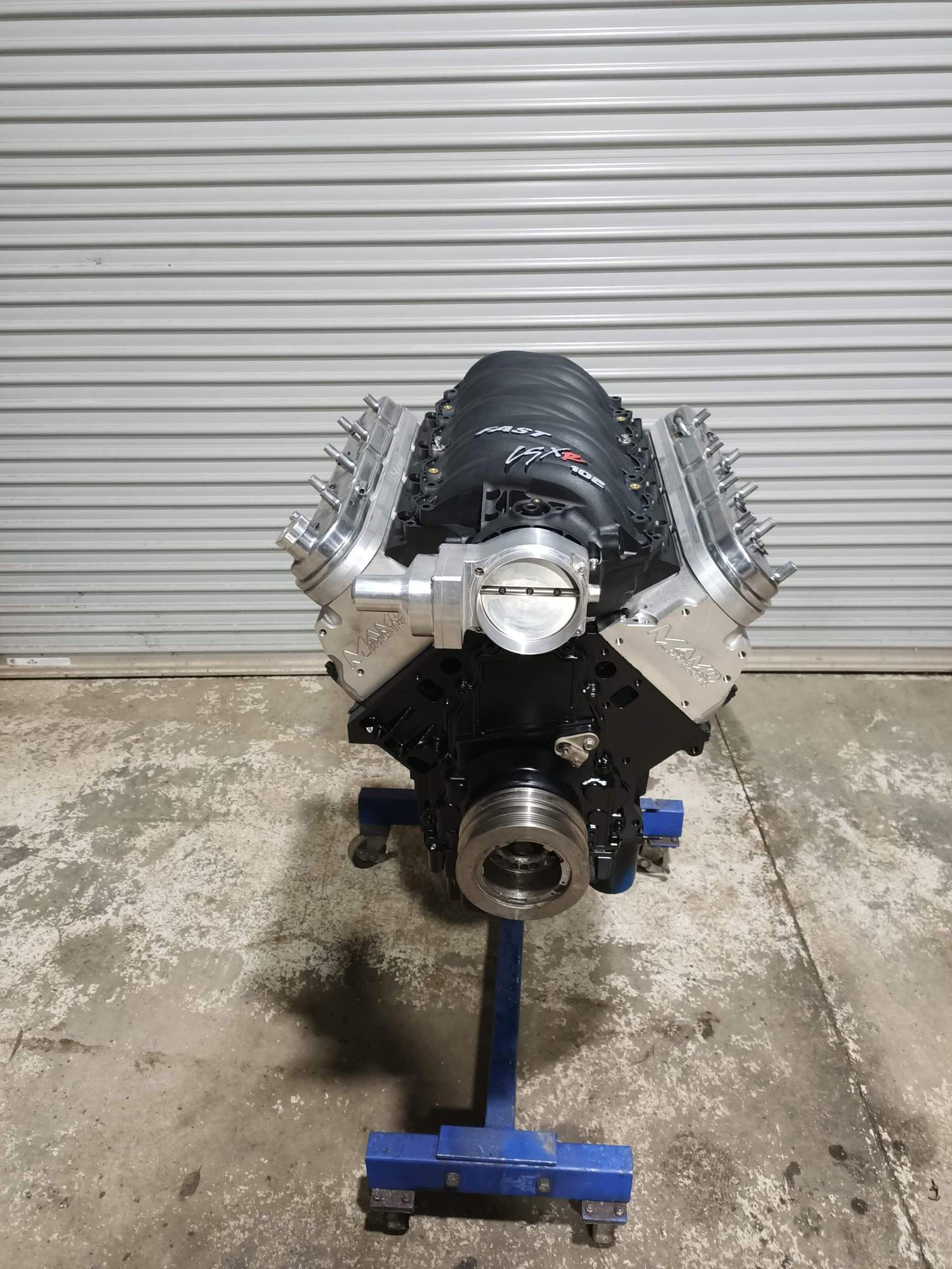

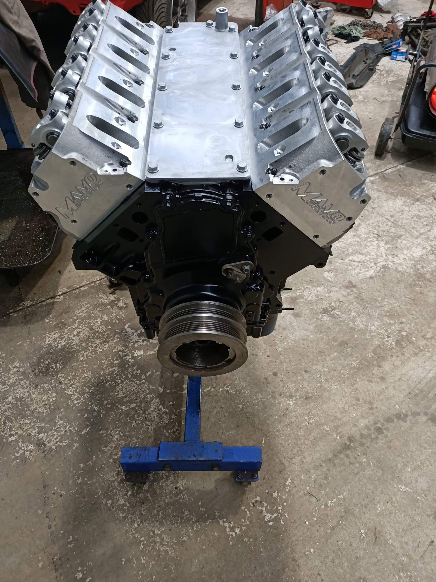

Guys, I have an update.
To my surprise the engine was painted a nice high gloss black to prevent rusting.
The job was really well done.
Also, the intake manifold in the pictures is not secured.
It's only on for the photos.
Engine will be in the car next week.
