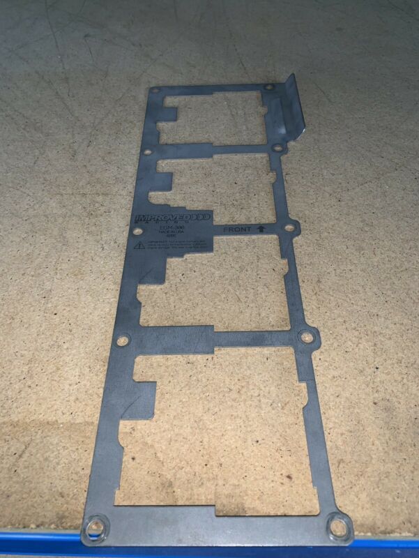

Good one on installing the oil pan baffle. You didn't end up doing a crank scraper also? One could be worth 5-10hp @ 7000rpm.
Improved Racing no longer sells their simple crank scraper only last time i checked.
I managed to find a new old stock one a while ago here locally. I saw it for sale on gumtree for $200 so i grabbed it... this is to suit stock stroke only though.
Looks good launch.
Yes a crank scraper is also installed.
There was also one on the old 408 engine too.
