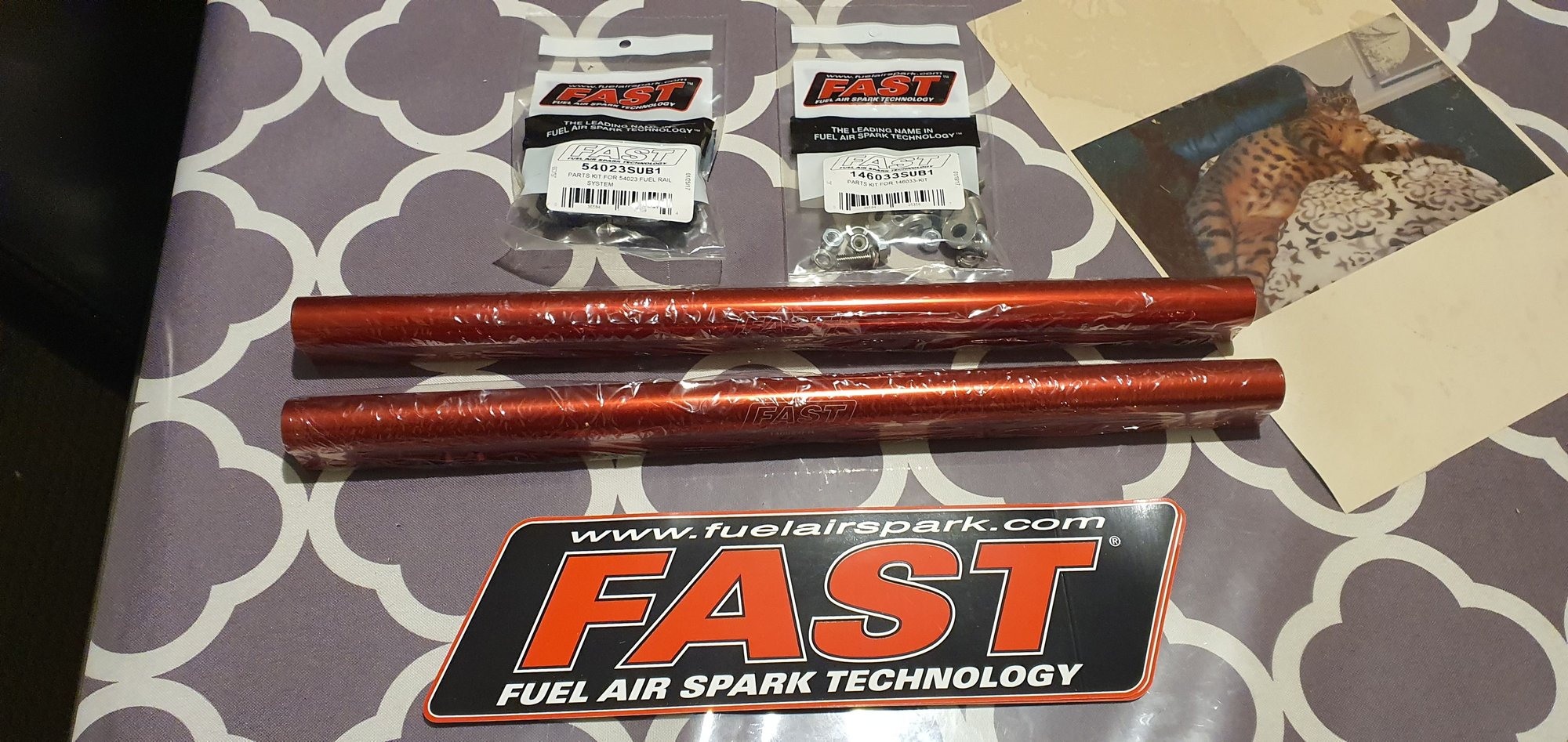

Hey guys.
Another part has arrived:
To compliment the FAST 102mm intake
The intake from Tony is also being delivered tomorrow too.

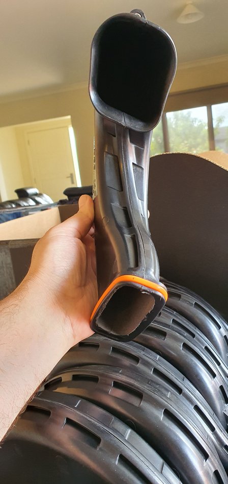

The intake is here too.
Tony's port work is quite impressive.
Very precise and even.
I had a bit of an issue with manifold today thanks to my inexperience.
I took out the runners to ensure there were no plastic shavings inside.
I cleaned it all out and put it together and then the top shell wouldn't close.
I realised that the cylinder number 7 runner has a slightly different angle and this needs to be at the rear.
Once I did that, I thought all was good until I realised I had mixed up the runners so the ports were mismatching a little.
I had to slowly and carefully figure out which runner went where so I was glad I got down to the last 3 and everything turned out well. Everything was once again matching.
I put the two bolts at the front and the three bolts at the rear and I noticed that the two shells were not completed sealed shut. There was a slight gap.
I messaged Tony and he said it's normal till the rest of the hardware/bolts go on and then it will seal perfectly. I was relieved.
Been a stressful day and this was my first ever experience doing this.

Tiny microscopic shavings won't do any harm. Your good.

Bortous, post a picture or two of these so called plastic shavings. With Tony’s attention to detail, and his super clean assembly program, I don’t see how a single piece of plastic made it to you.
