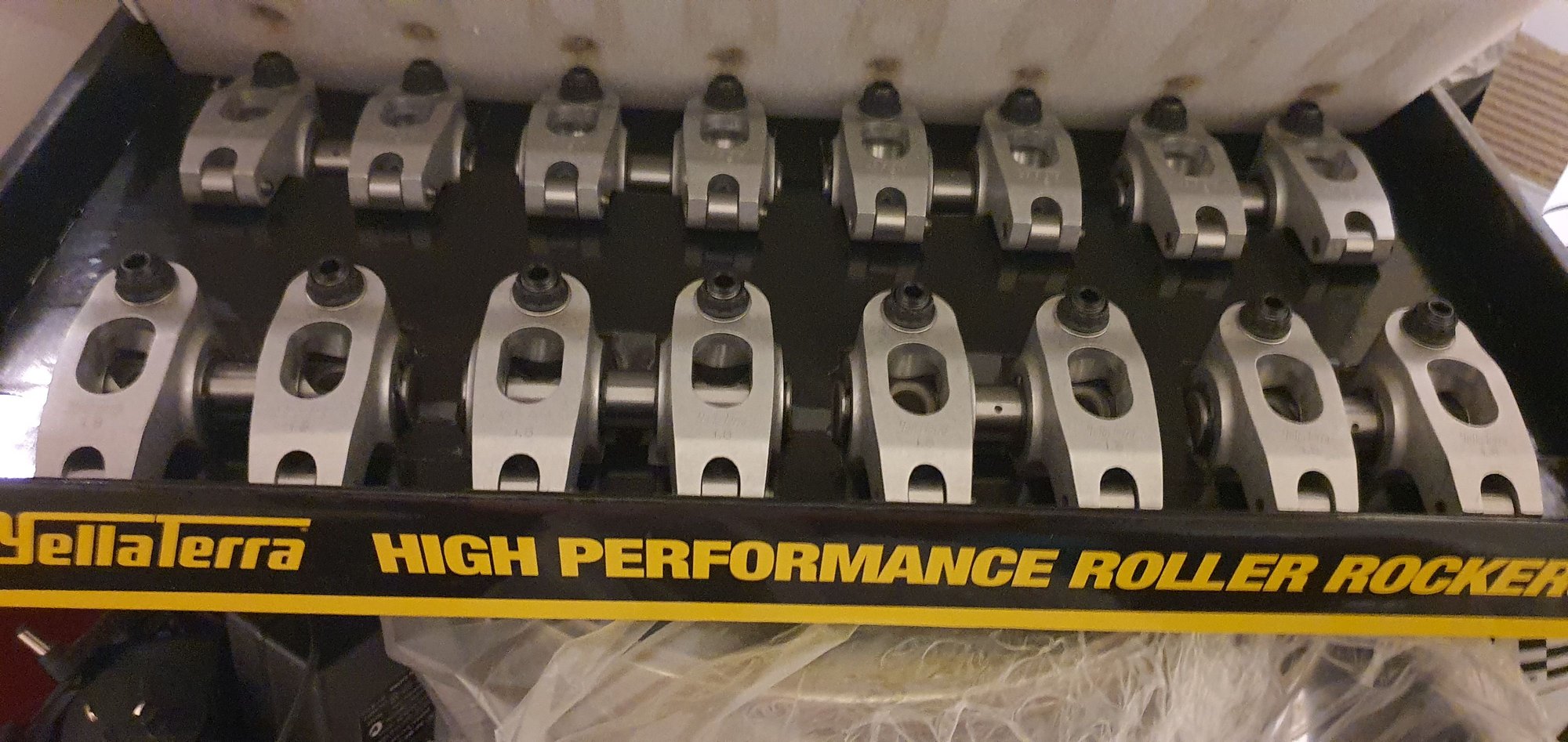

Guys another part has arrived for this build:
MMS 1:81 rockers 10mm

Been curios to know how well these hold up when running solid cam and lifters. Anyone running YellaTerra with solids on LS7 style cylinder heads?
I did for twenty minutes or so....
These are running with cathedral heads.
No issues as long as you don't exceed 600lb open pressure.
I will be at 500lb open so all good.
Darth and Mick are using these for their ls7 setups.
Old Mar 25, 2020 | 08:45 PM

I've been running them on a ls3 build with the 8mm bolts for over a year. Shifting just shy of 8000 rpm . Other than getting them to.fit under valve covers ,they are great
I had my ls3 yella terras for 9 years and no issues.
These were the version 2 not the 3 which came out two years later.
I’m running them.

I've always heard horror stories of aluminum rocker arm failures so I've been skeptical.
There was at least from YT a bad issue with their first generation parts. Their third generation parts, I don't hear of many failures at all. I will admit I was a bit concerned about taking the aluminum ones to 500 lb open pressure. The pros are very different from the ultralites in terms of what they can tolerate. I had zero issues with the ultralites on my 5.7 with LLSR and .653 lift with 1.7 rockers.
Darth, if you have the pro street version these are rated to 600lb of open pressure so you will be more than fine.
What is the part number for those rockers you got?
Most of those failures were in the generation 1 days.
If you don't exceed the max open pressure they are fine.
Yella Terra told me all about the issues.

Adjustable yella terra for tickflow ls7 heads are rated at 480lb, I'm at nearly 530lb open and no issues
