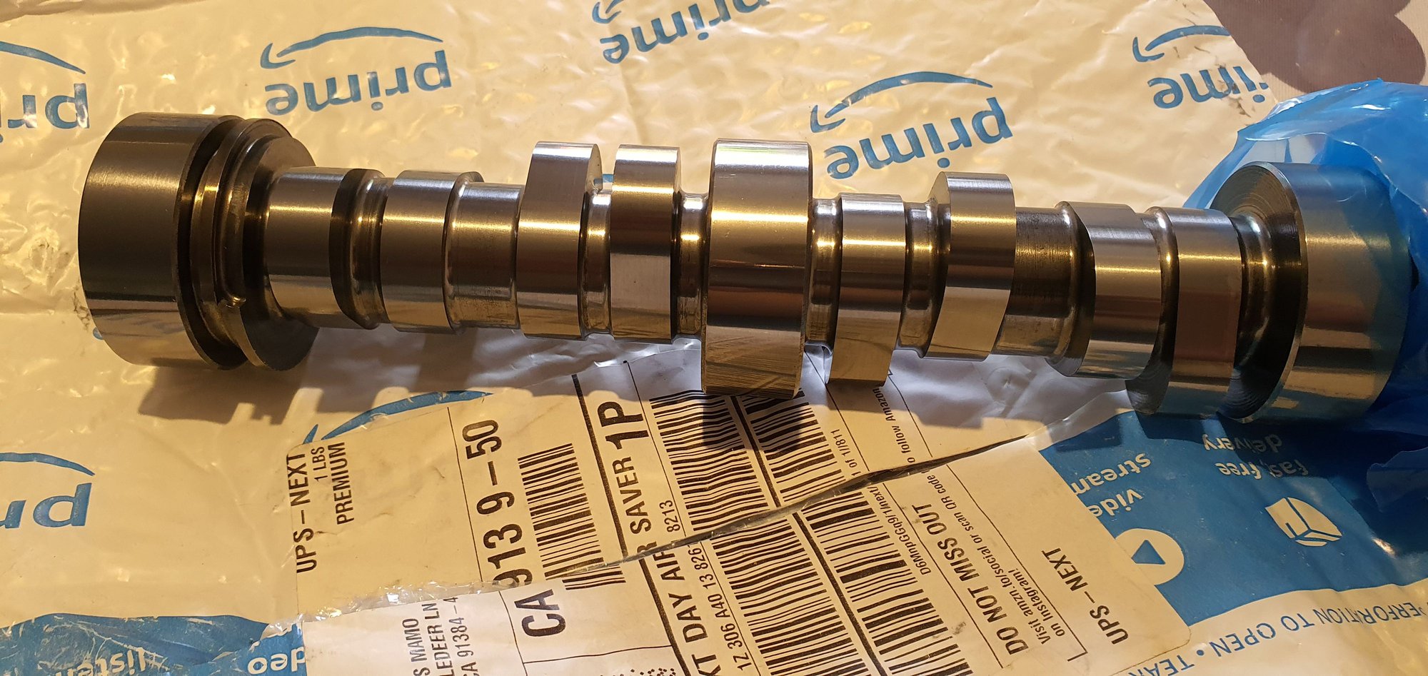

Camshaft is here too:
Parts **** is where it's at:
Lift specs are for 1:7 ratio.

A lot of cam for someone who wants mild street manners
Old Mar 20, 2020 | 04:34 AM
  #389
bortous's Avatar
Joined: Sep 2010
Posts: 2,898
Likes: 467
Remember its a 249/255 when converted to hydraulic.
Also remember you need more camshaft timing for cathedral heads vs square port.
It's not too big?

From: VA
Should be explosive off idle with the 3500 stall.
Old Mar 20, 2020 | 06:55 AM
  #391
farts can he explosive too
Should be with a nice tight 3500rpm stall converter.

Originally Posted by bortous
What is that?
That's the lobe information from your cam. He has your intake lobe PN highlighted

And that cam is probably a touch too big for a streetable cam with a 3500 stall. It would do better with a 4000+.
