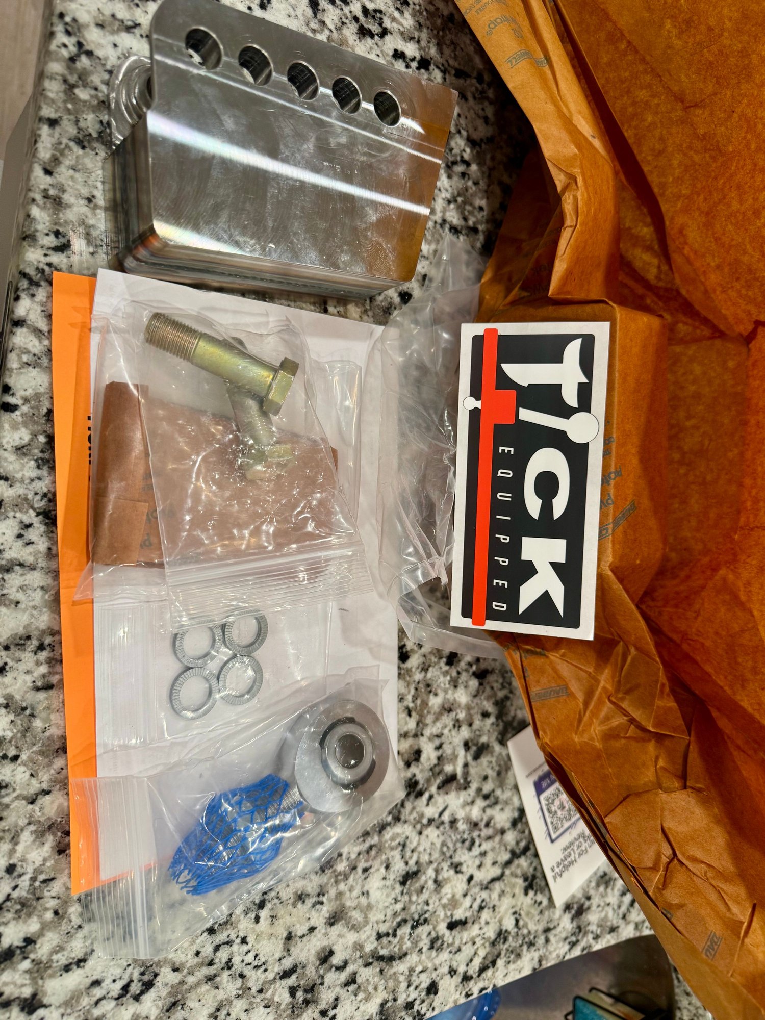

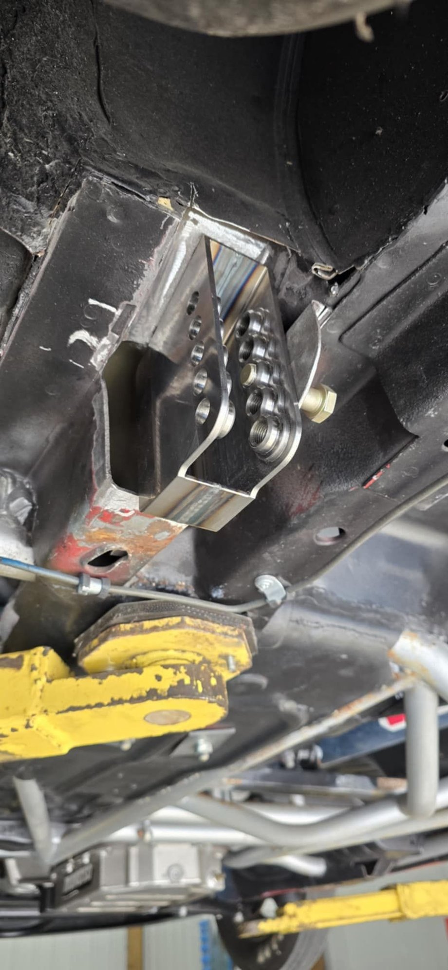

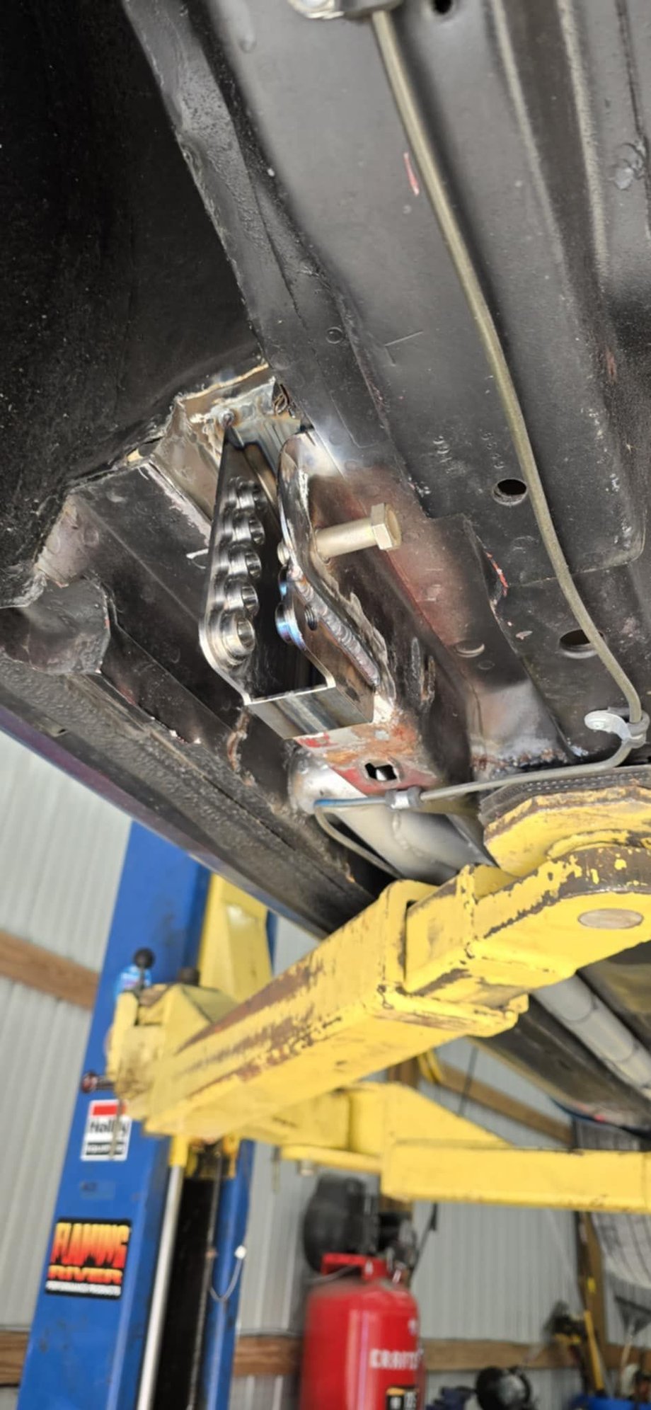

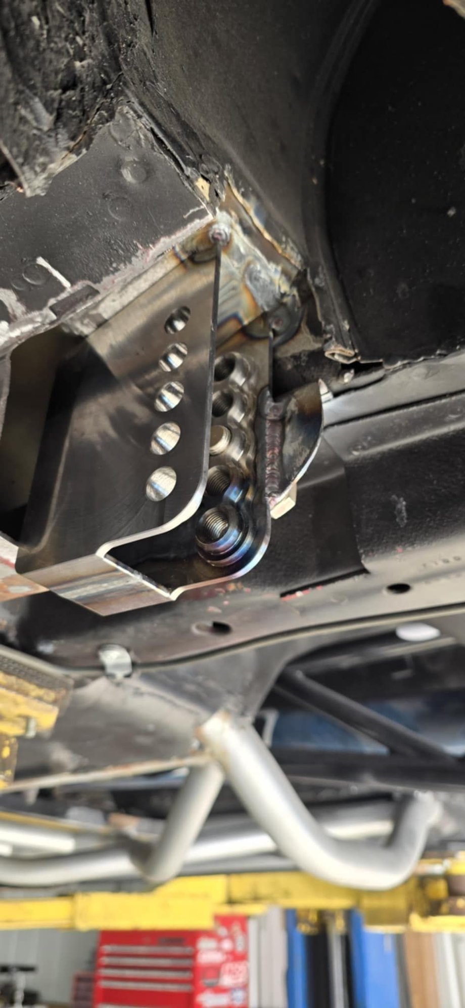

Yea nothing crazy but I get the Tick Performance torque boxes and got them installed! But other than that the car has been siting a lot.

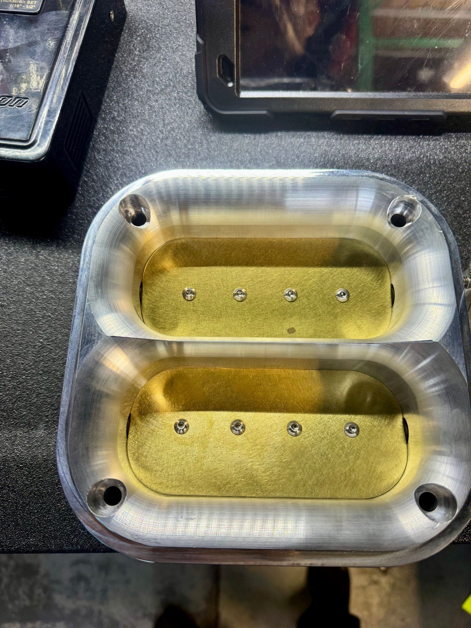

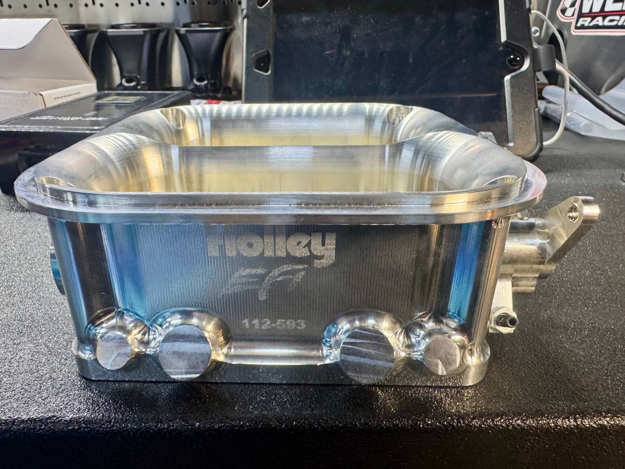

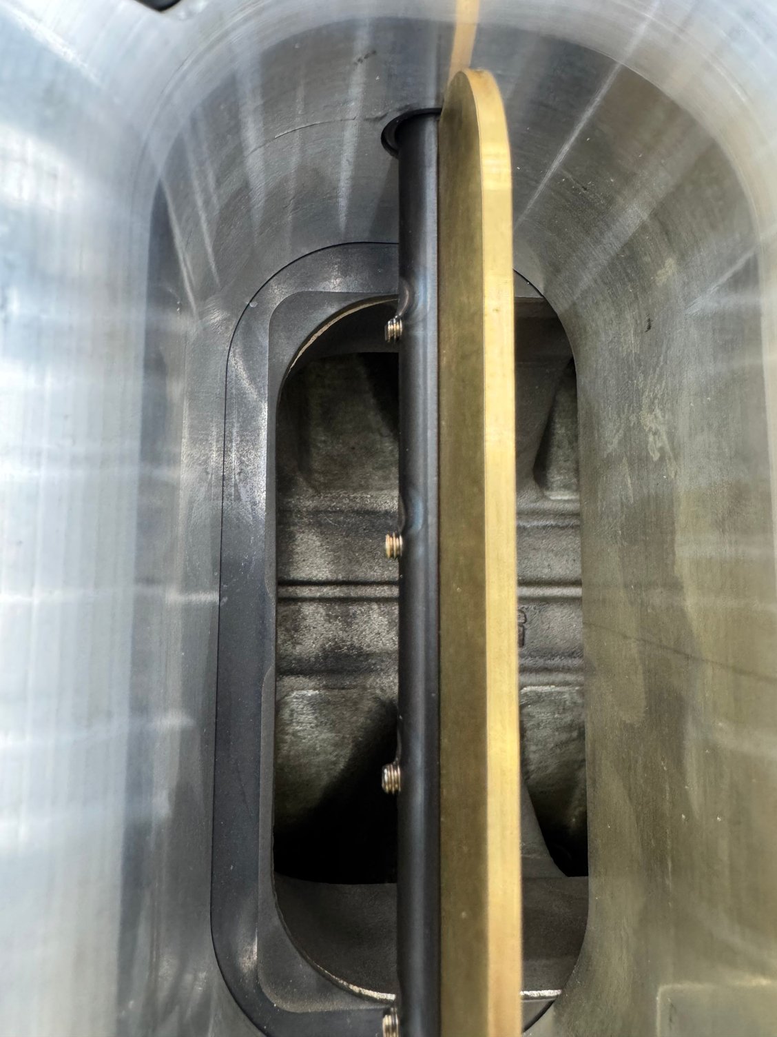

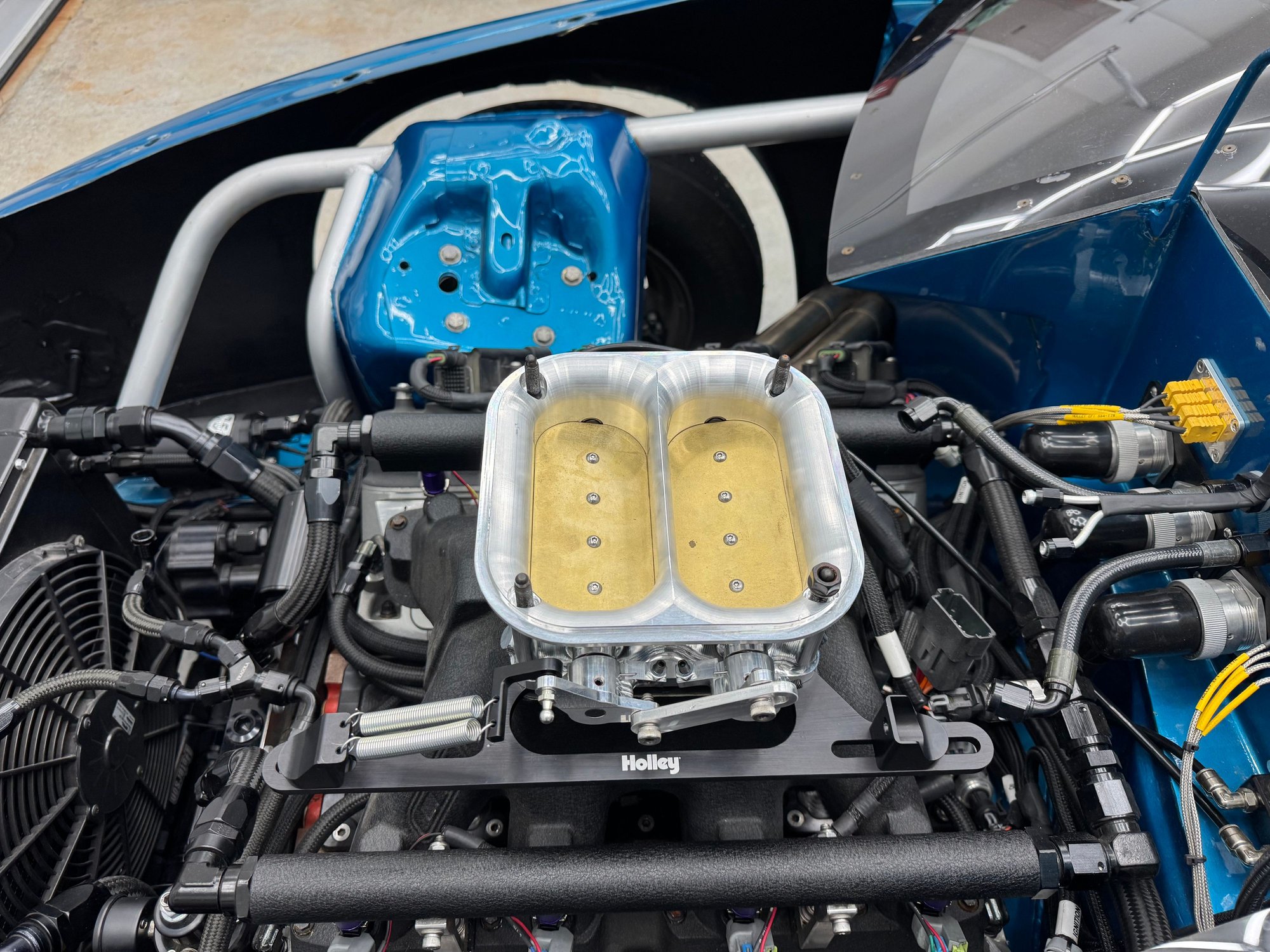

It’s been pretty quiet here lately but I have started on some updates/ upgrades. We are going to do some back to back testing on the dyno in the quest for more power. 1st is the Holley Dual big bore throttle body, it just looks massive in comparison to the Accufab 4500.
Just like everything it’s not as simple as bolting it on, the throttle body opening needs quite a bit of work and the base of the throttle body needs to be milled so I can mount the cable bracket.

Any reason for that vs something like an Accufab 6500 or higher? Interested to hear. Looks like a nice piece!

You still have to mill the intake to fit a 6500 or 8500, would have went with the 8500. Also there are couple of well know guys running this TB with success. Plus the Holley was almost half off over Christmas.
