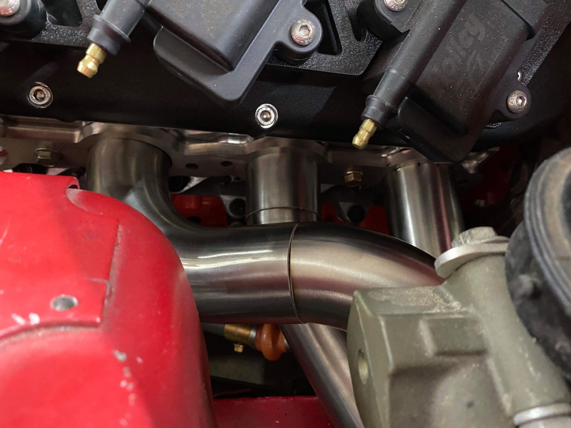

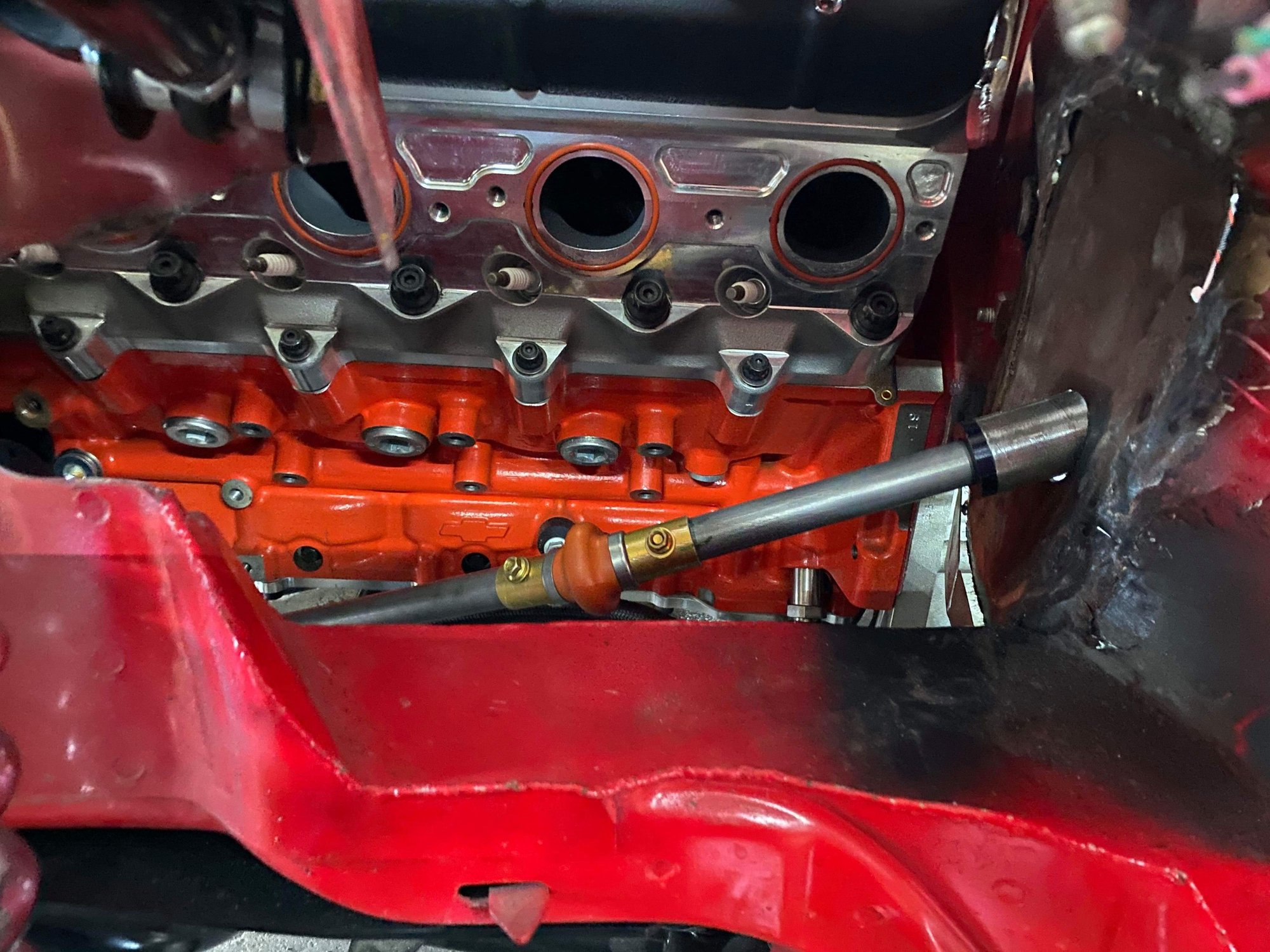

Felpro 1208-3 works for intake gaskets.

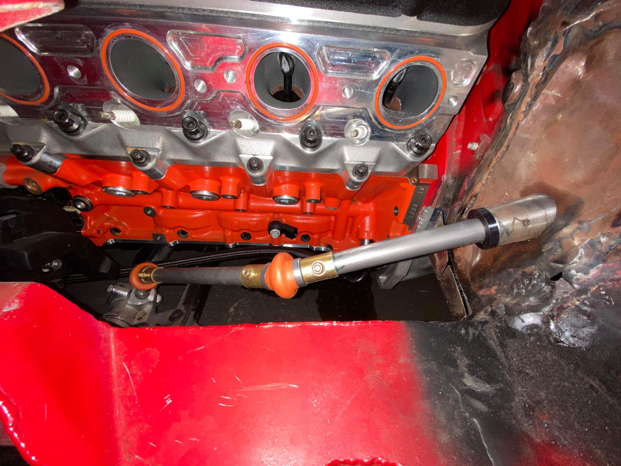

Why are those exhaust seats so rusty appearing, looking at that steering column pic? What fuel are you running?

The motor was Dynoed with C16, I have noticed this and was hoping it wasn't going to be a issue

Also in for if the rusty valves are ok??

Oh I know I would, I'm really just impatient as **** lol! I am starting to get concerned about the motor from it sitting so long, even though I have spun it over. The motor was sealed and always in a climate controlled place, my shop is AC as well as the first fab shop. The motor is coming back out when the car gets painted so I could always pull the heads and have the valves cleaned, that wouldn't do anything for the seats tho

Car's looking good. Just a tip with the exhaust ports (what i do on engines and/or cylinder heads that might be sitting for a while), spray a good amount of some anti-rust lube in all of the ports to coat the valves / seats. I use CRC 5.56 or similar, something that isn't sticky and will just burn off on engine start. If the engine is still on an engine stand and can spin it upside down i spray enough so it even runs down the valve guides. Starting a fresh engine like that with totally dry valve guides and seats, even though it'll most probably be OK it just makes me cringe a bit.

Good to know, I will spray them down before I start it up.

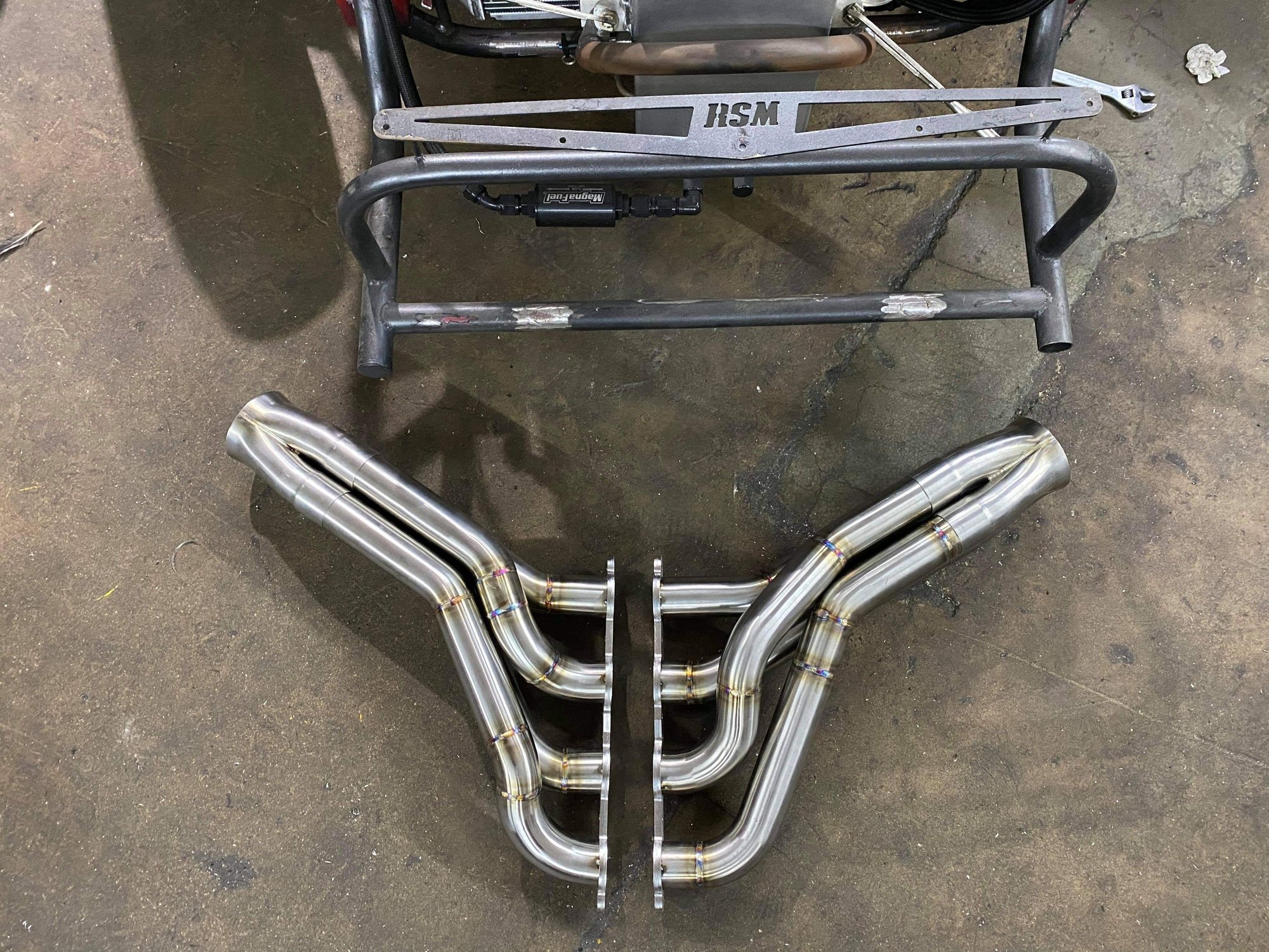

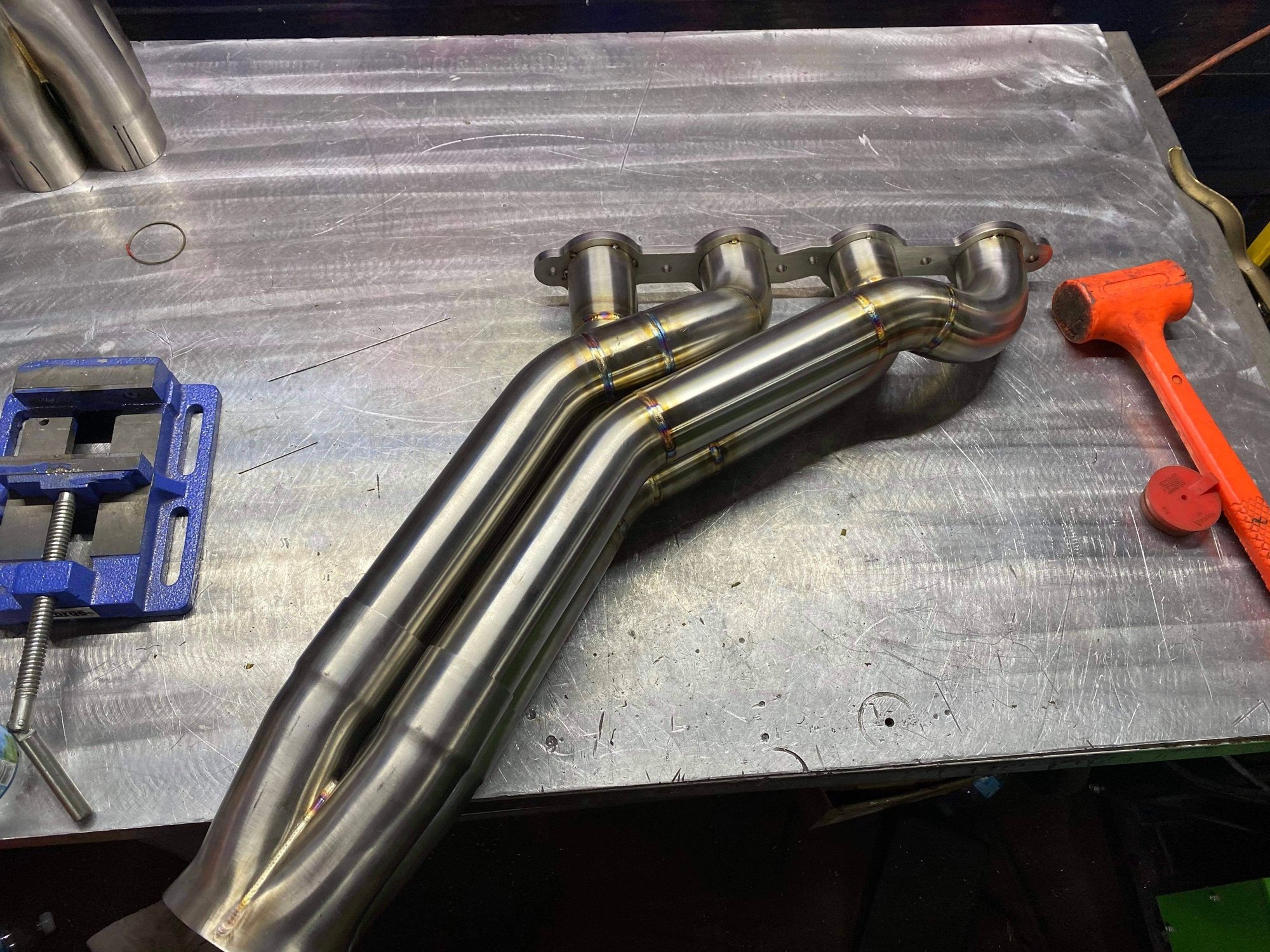

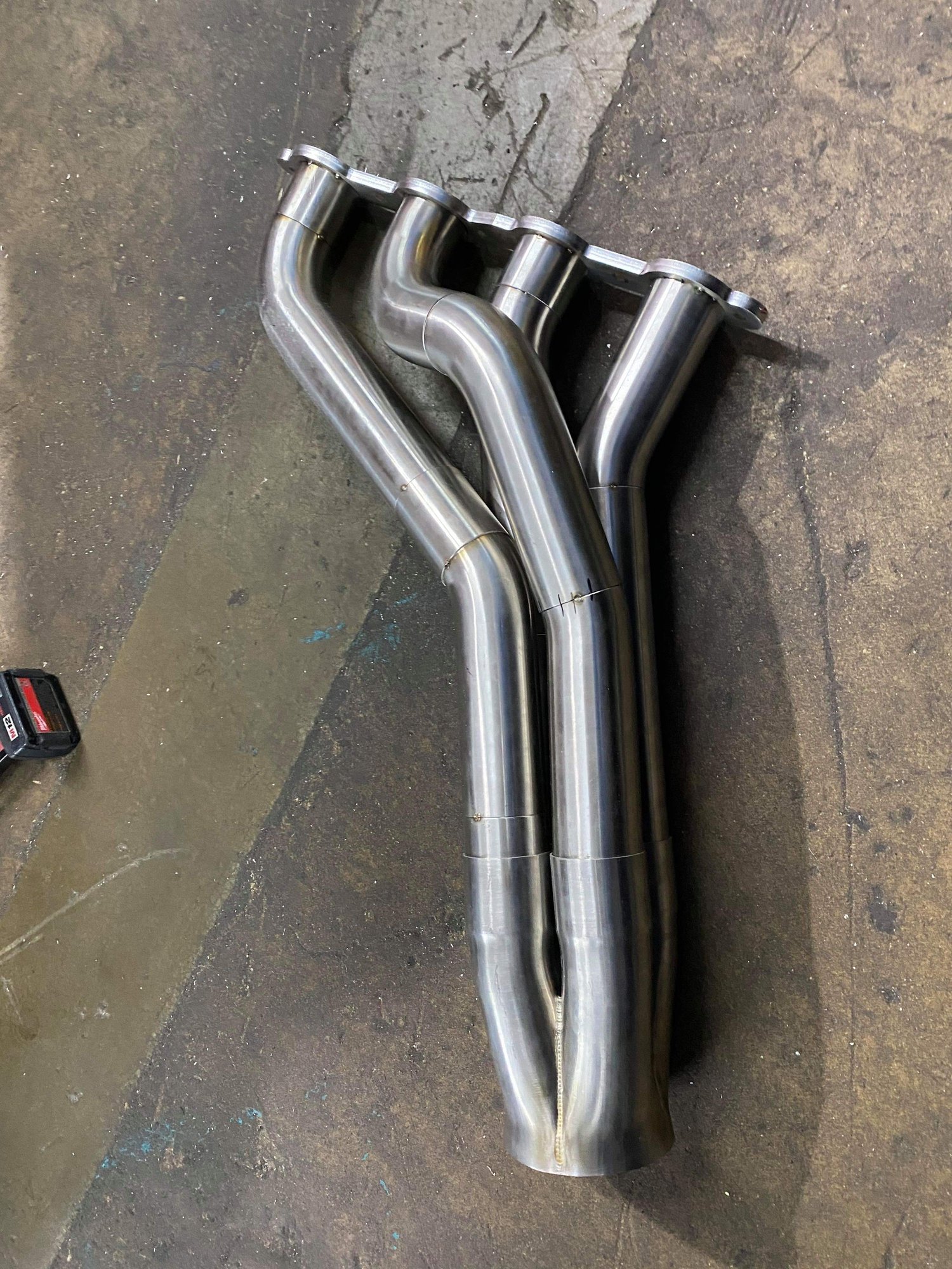

Finally starting to get somewhere on the headers, fab shop say they driver should be done by the end of the day.

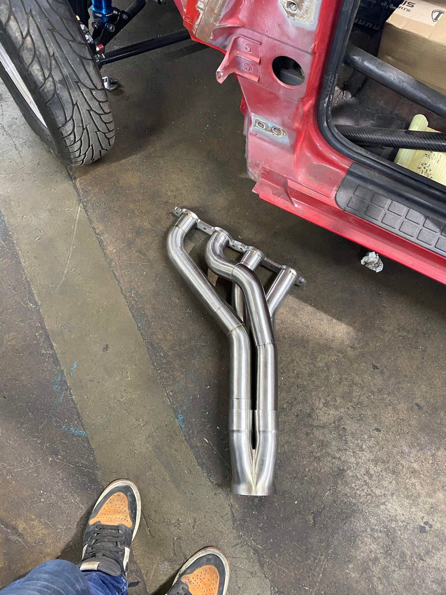

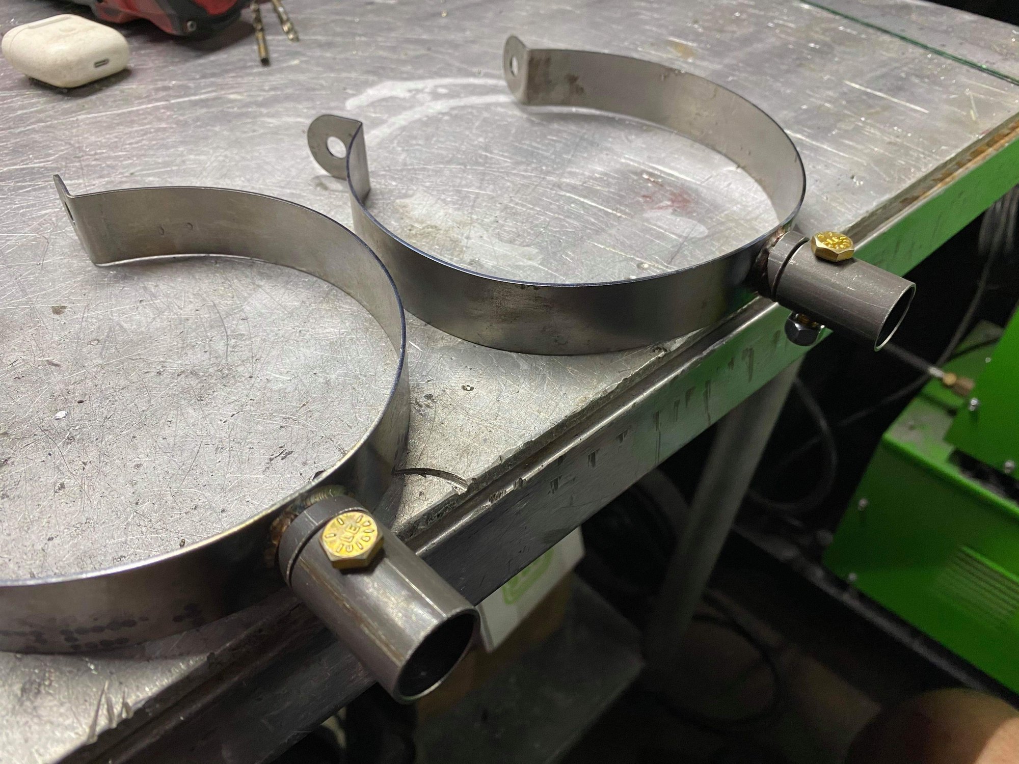

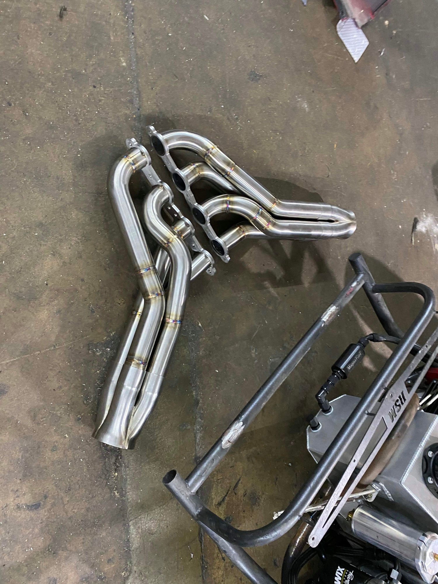

So the fab shop killed it yesterday and its looking like the headers will be finished up today. He is adding the EGT ports and V bands to the end of the collectors so I can run flush tip or I can do bull horns, this makes it an easy swap! He has a couple of small things to finish up ( rans mount, TA mount, seatbelt tabs, carbon doors) but hope to pick the car up next week!
