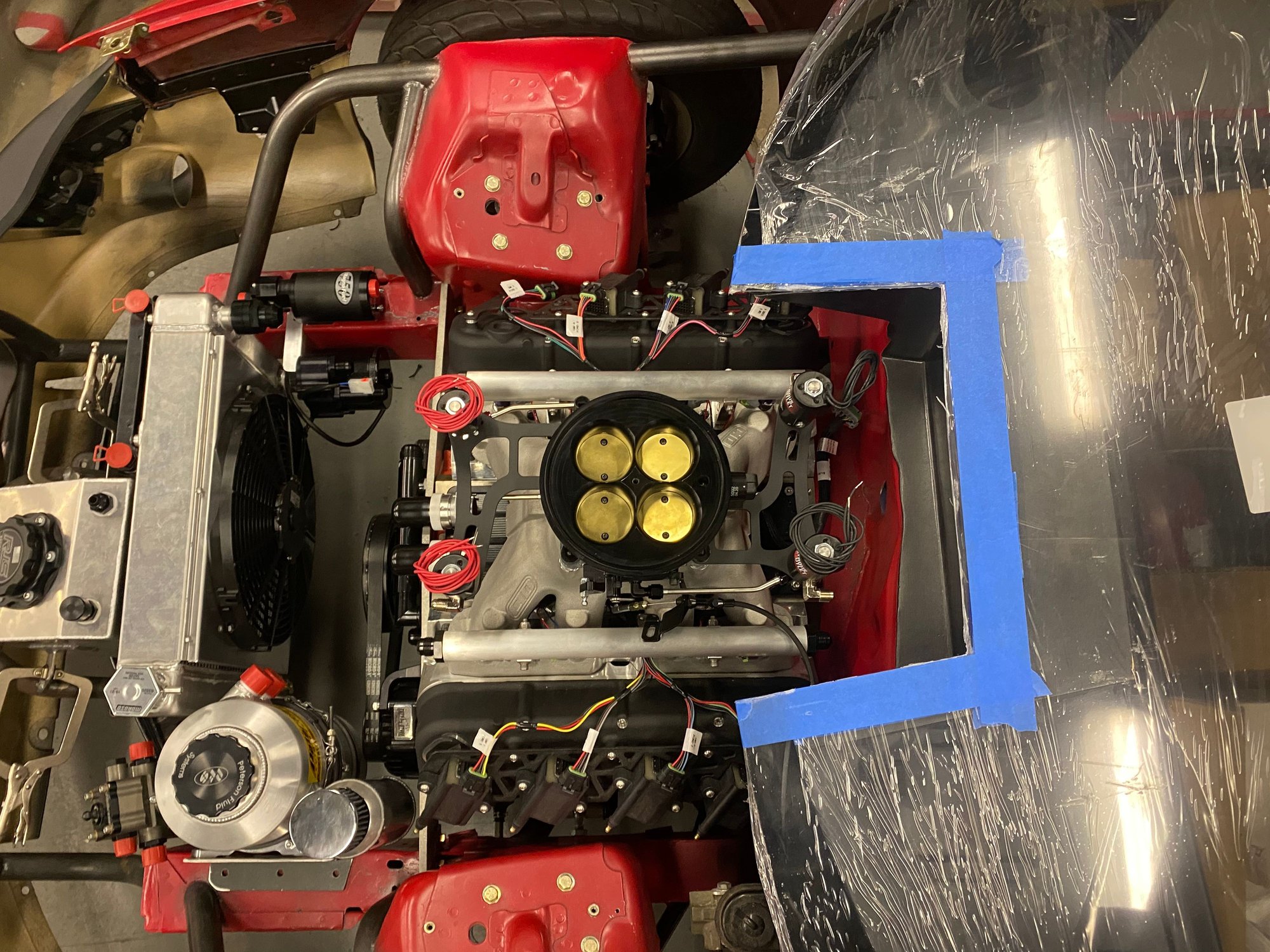

is that the cid 5.0? how is the port alignment?

yes it is, great from what I can see and feel

2 stages huh. Nice!!!!

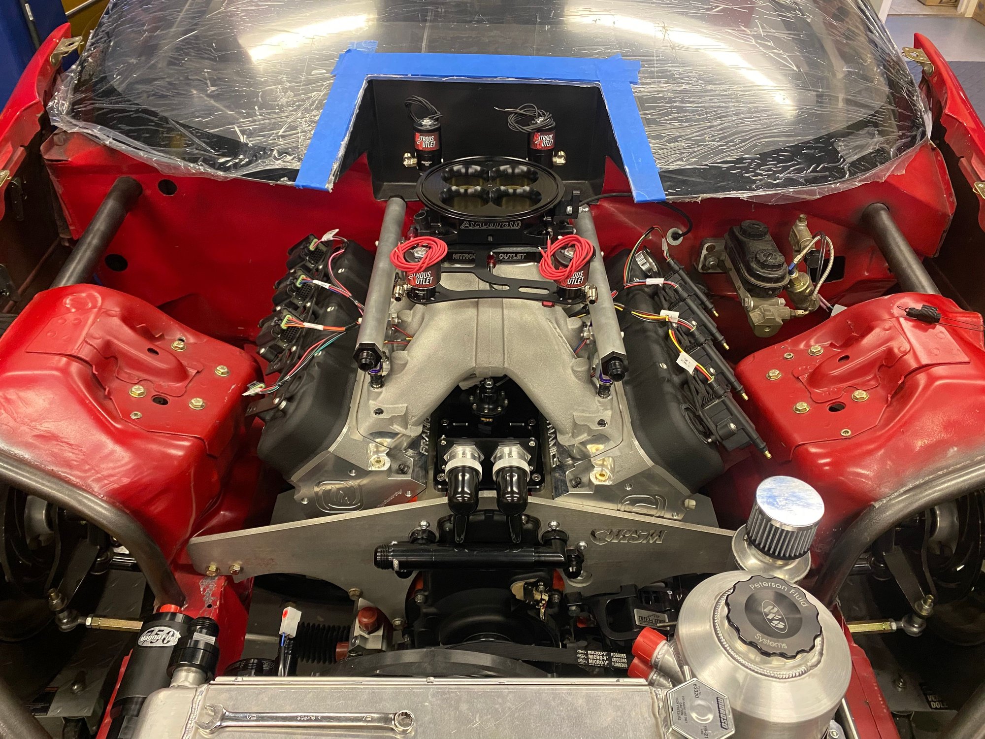

Is that the Hornet 3?

LOL yea we are trying to party!! Yes it is, I wish the bracket was a little lower but with the new 6.5" Sunoco it will clear.

Oh you are going to do some partying alright. Lol Can't wait to see the results, if you bless us with them. That beeotch is going to fly. Now I understand. Might have to add weight back to the front.

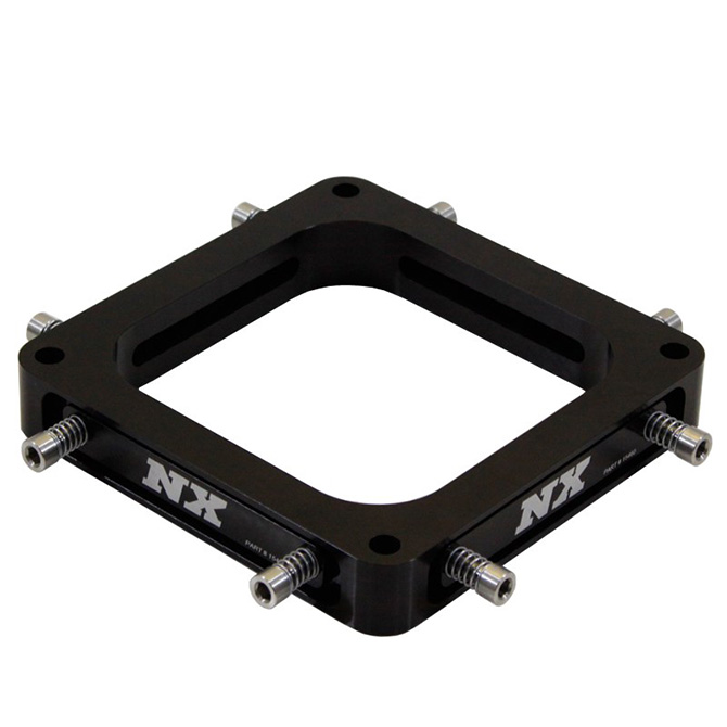

Do yourself a favor and get a plate style burst panel to go between the throttle body and nitrous plate. Will save your throttle blades in case of a backfire.
This is the one we use. Resets itself so you don't have to replace panels. Works great. Keeps you in the game in case you get a small fart that might take out a fixed panel and take you out of doing a pass. We bent the solenoid bracket into an offset. Didn't take much. But we went with braided stainless lines. IS has them too.
I'll post the results on here, the car wont be a secret for very long when i start running it. Thanks for the heads up on the blast plate, yes I have a Holley Dominator for the car.

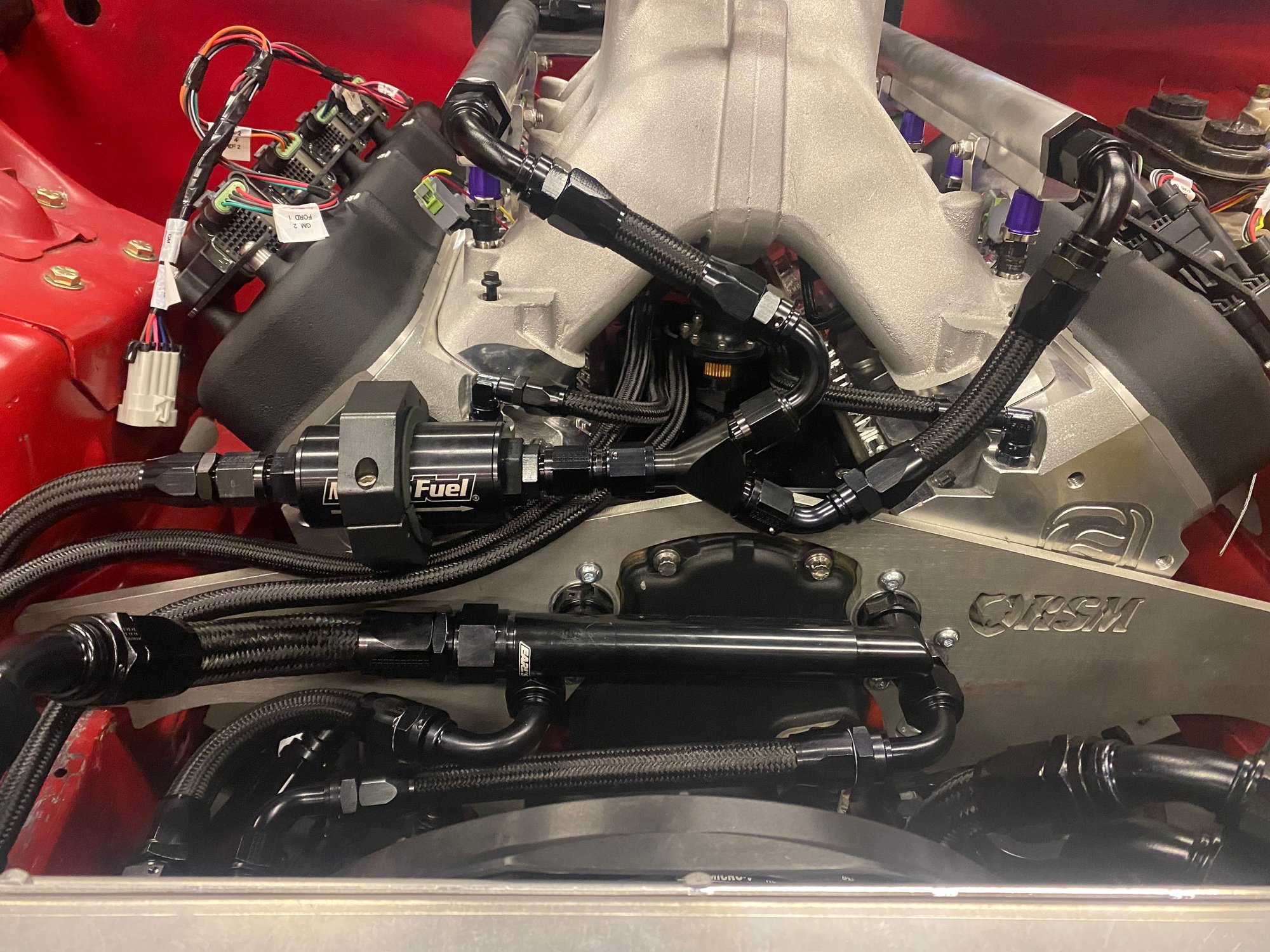

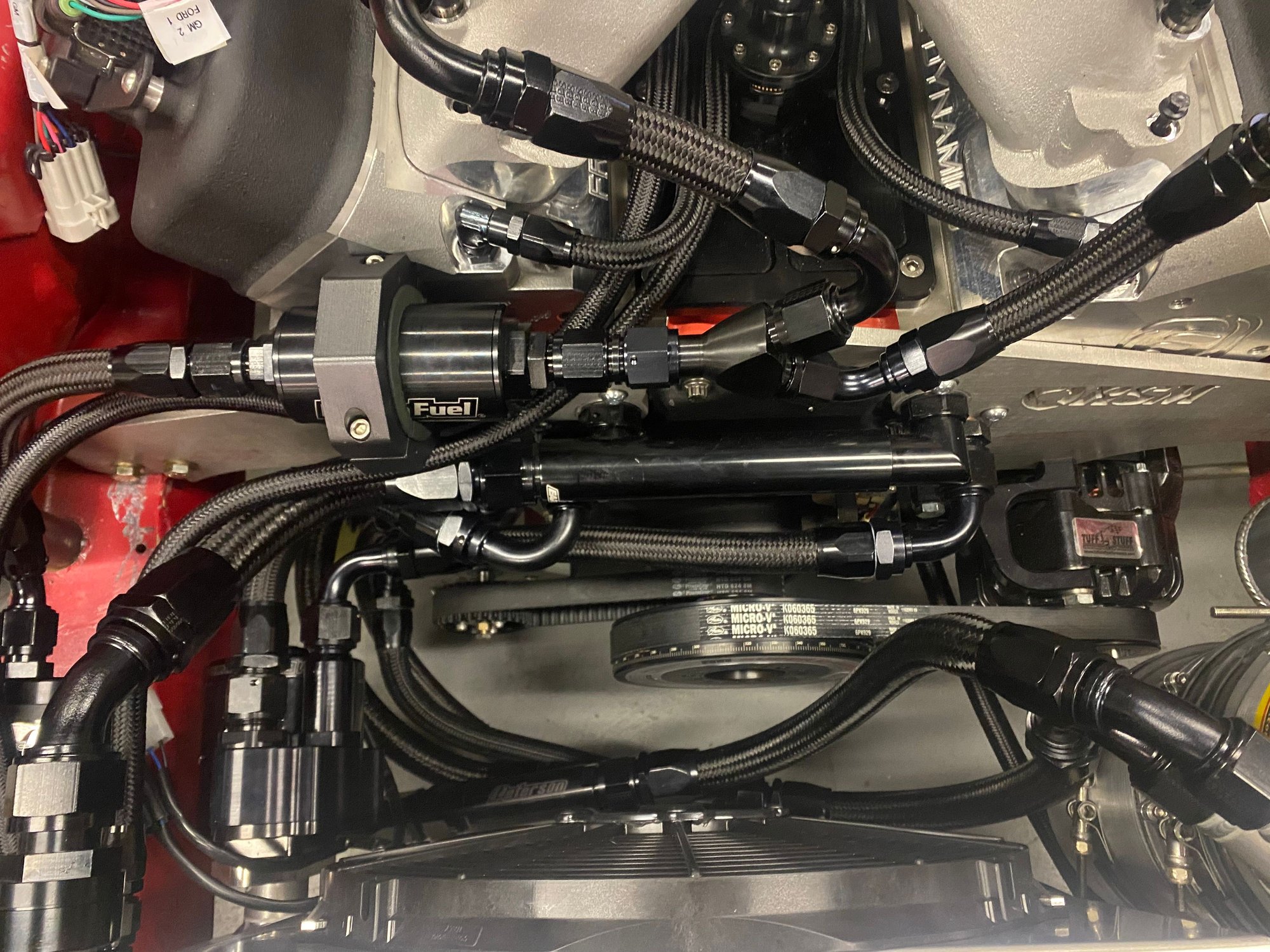

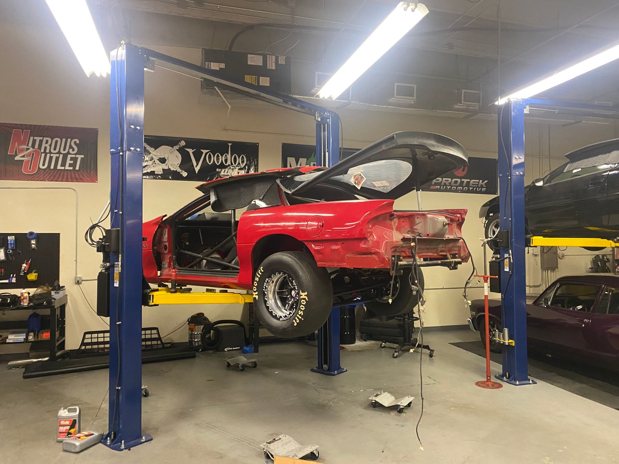

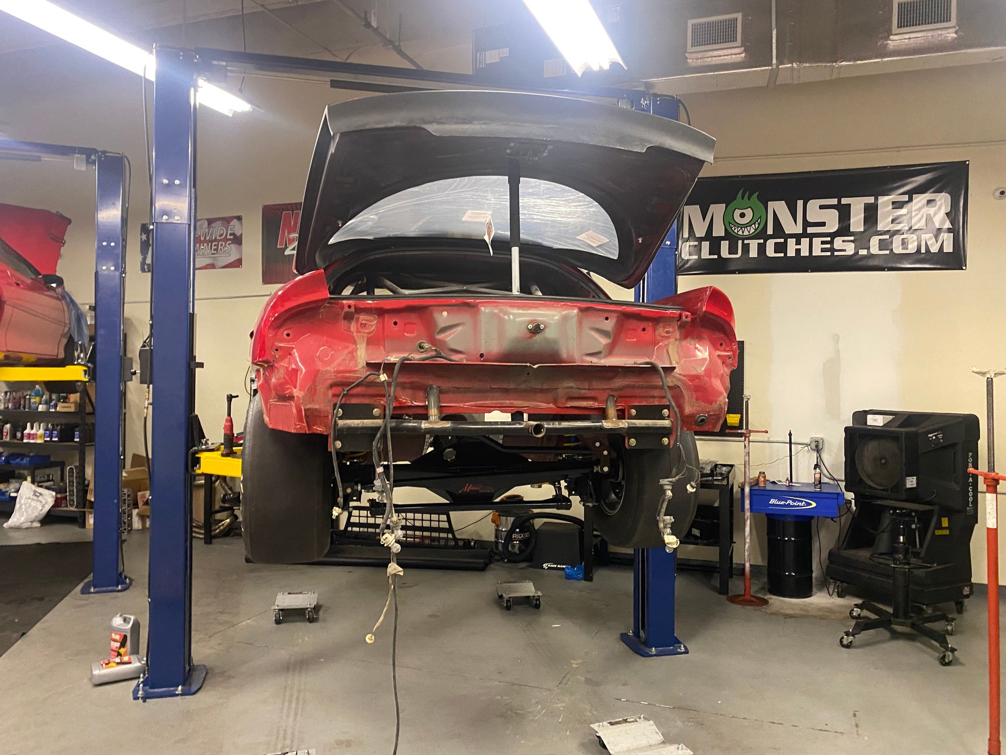

I got what I think is all of the fittings and line ordered to plum the car this weekend. I got one line made last night with stuff I already had at the shop. Also the fab guy sent me this picture!! Car will be headed there next week to have the headers made, steering column, seat mounted, front end with head lights, trans mount and TA mount.

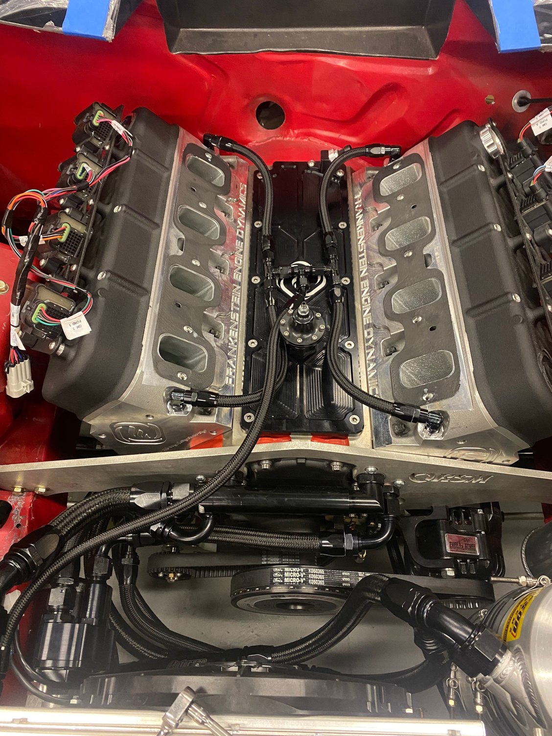

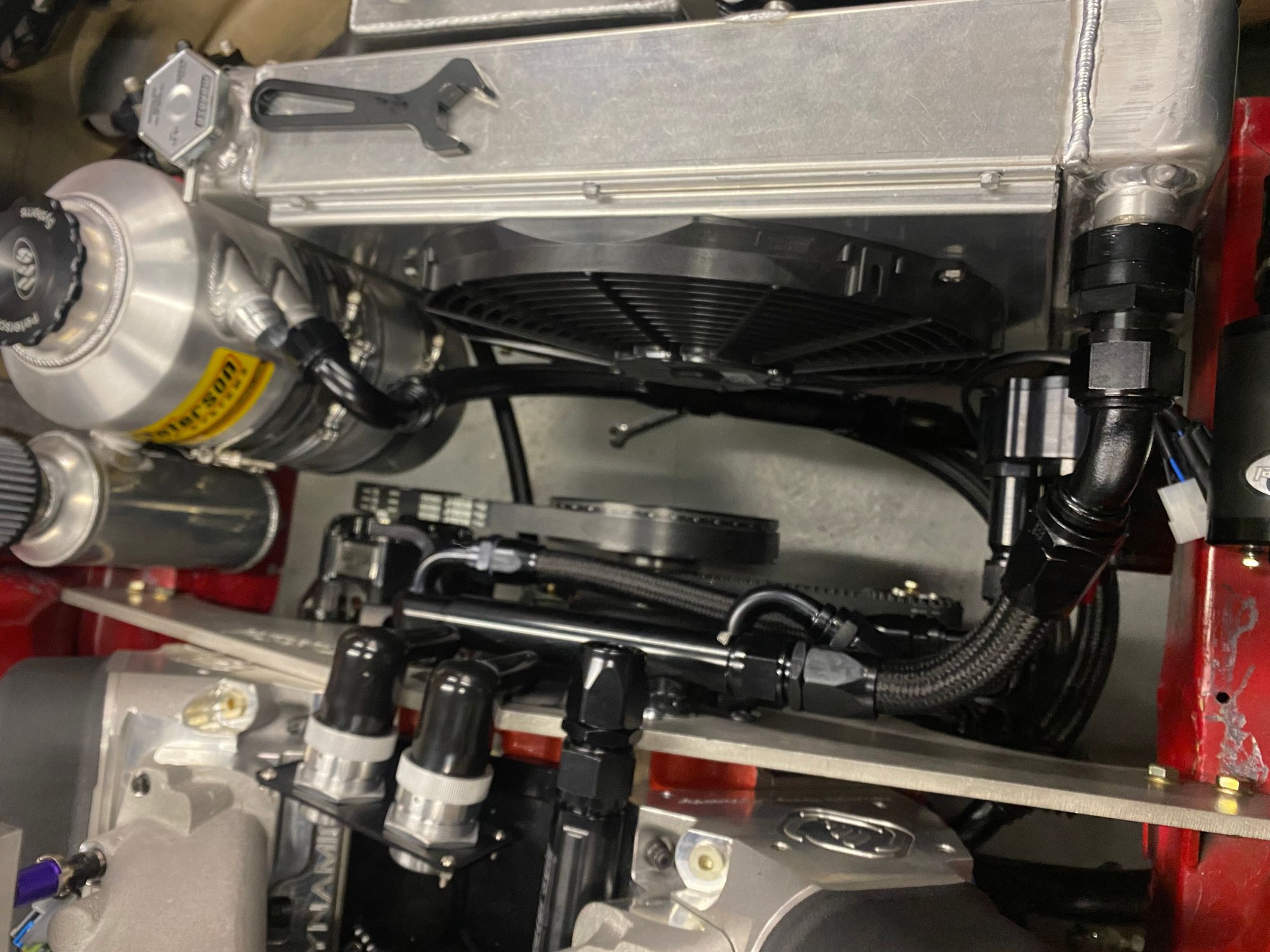

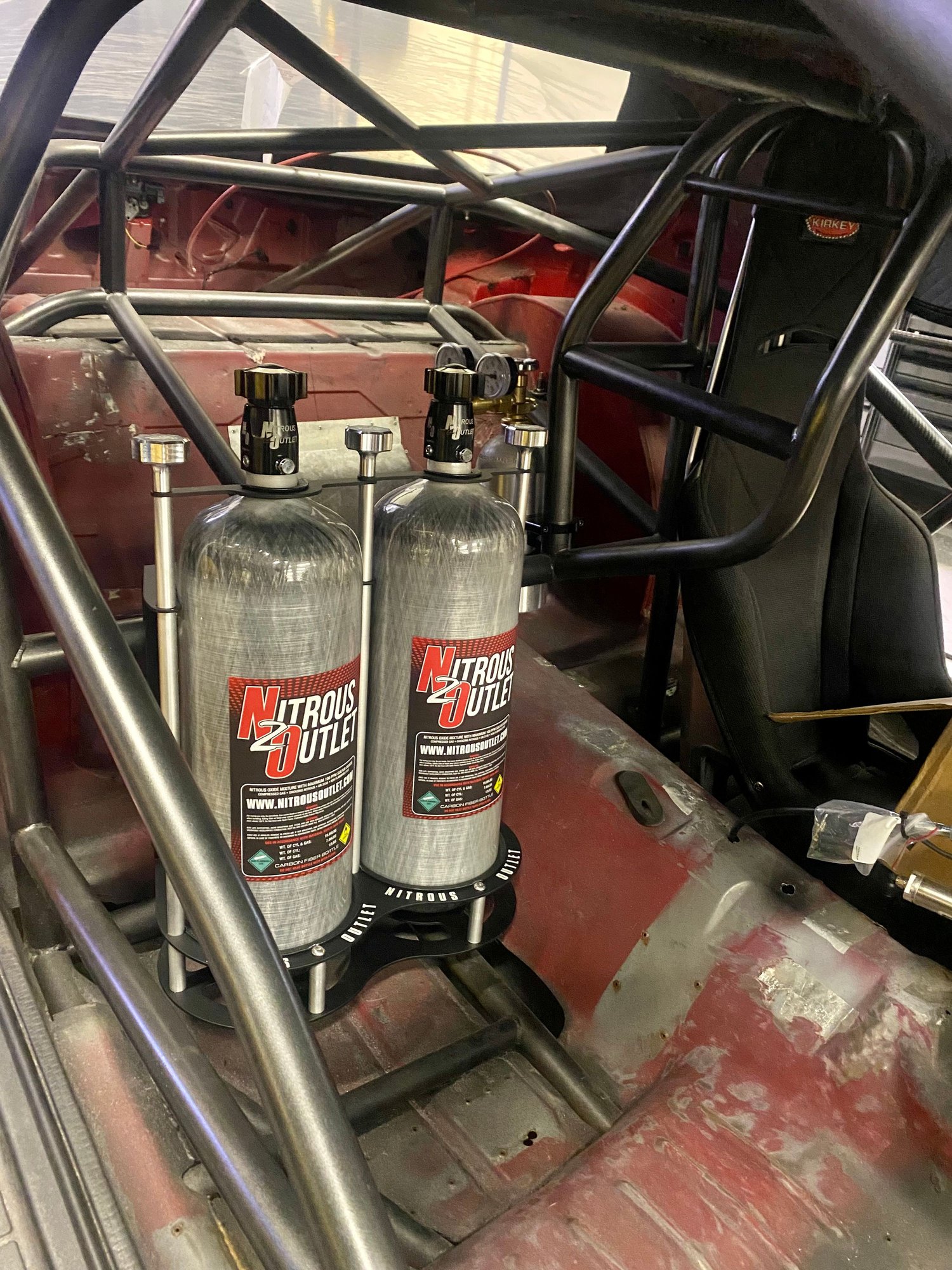

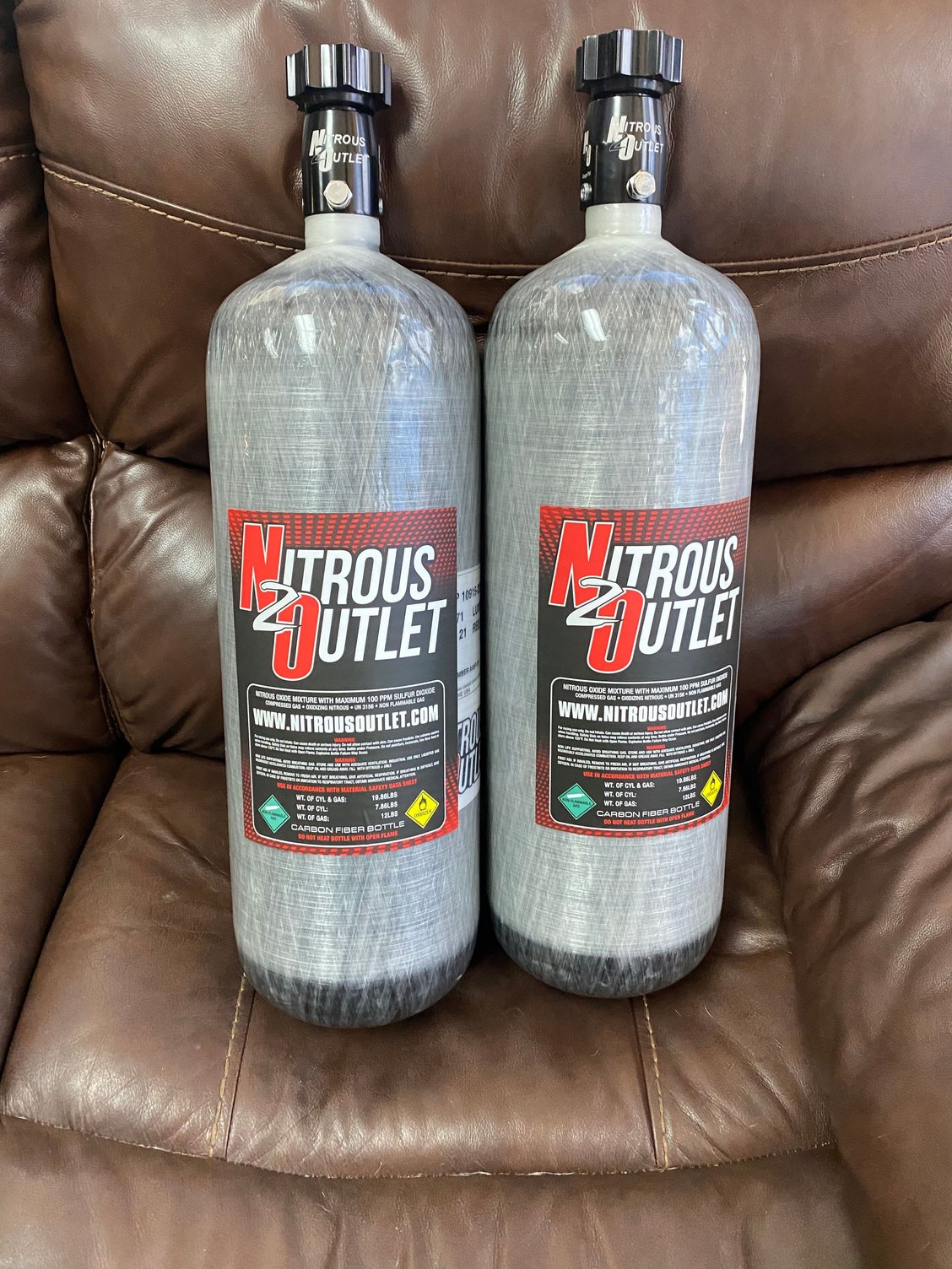

Got the car 90% plumed up, tested the oil primer and we have oil!! I is still have to secure the scavenge lines, I’m going to get it on the lift tomorrow.

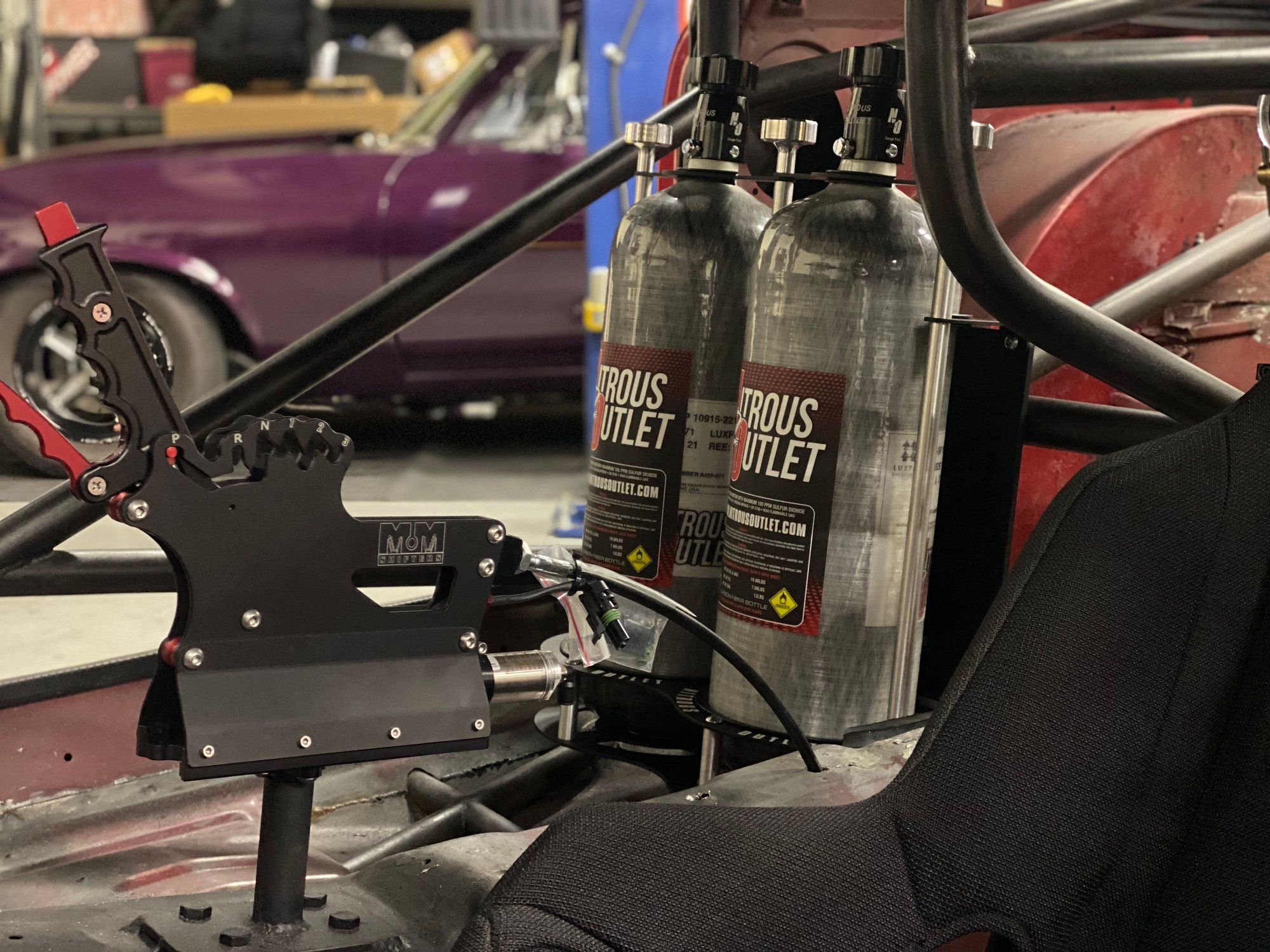

Also got the new Nitrous Outlet bottle bracket in and built, thing looks killer!!

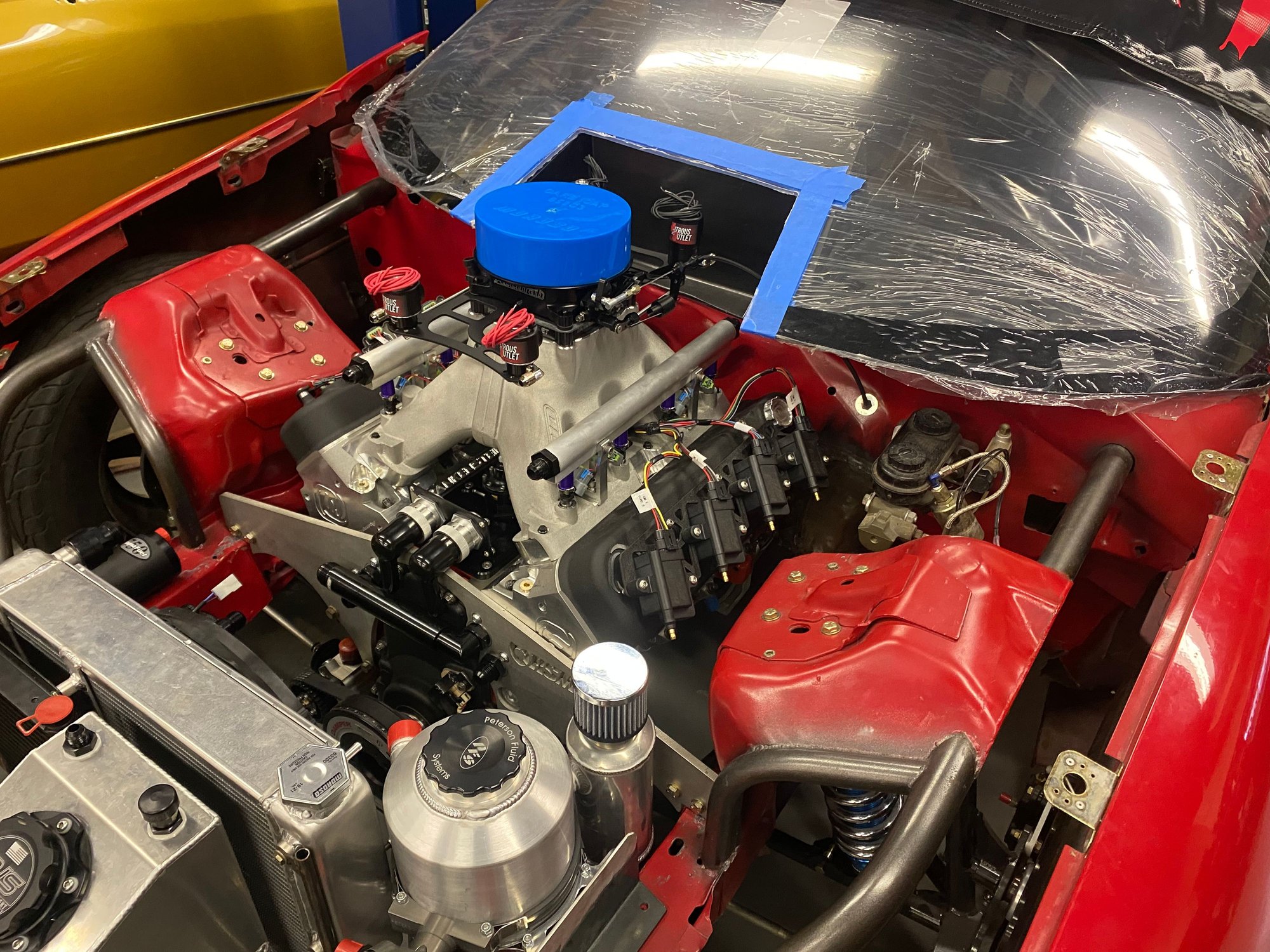

got a couple of small things done on the car, test fitted the new rear bumper, mounted the nitrous bottles and installed a trans dipstick. Just keep chipping away at the list!!

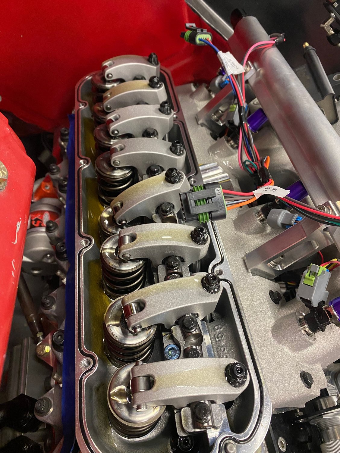

I am not sure how much you are spraying it but the F710's need some pretty significant chamber work for a hard hitting N20 effort. They have a VERY fast burn rate. with your 14.5 static and the 10 degree chambers is tuning window is going to be very narrow.

The plan is to still run the car NA for the time being, when I do start to spray it it will be VERY easy on the tuning. The goal is not to blow this thing up lol will prob start with a 150/200 and add 200 later, we will see what the motor likes/ what I feel is safe.
