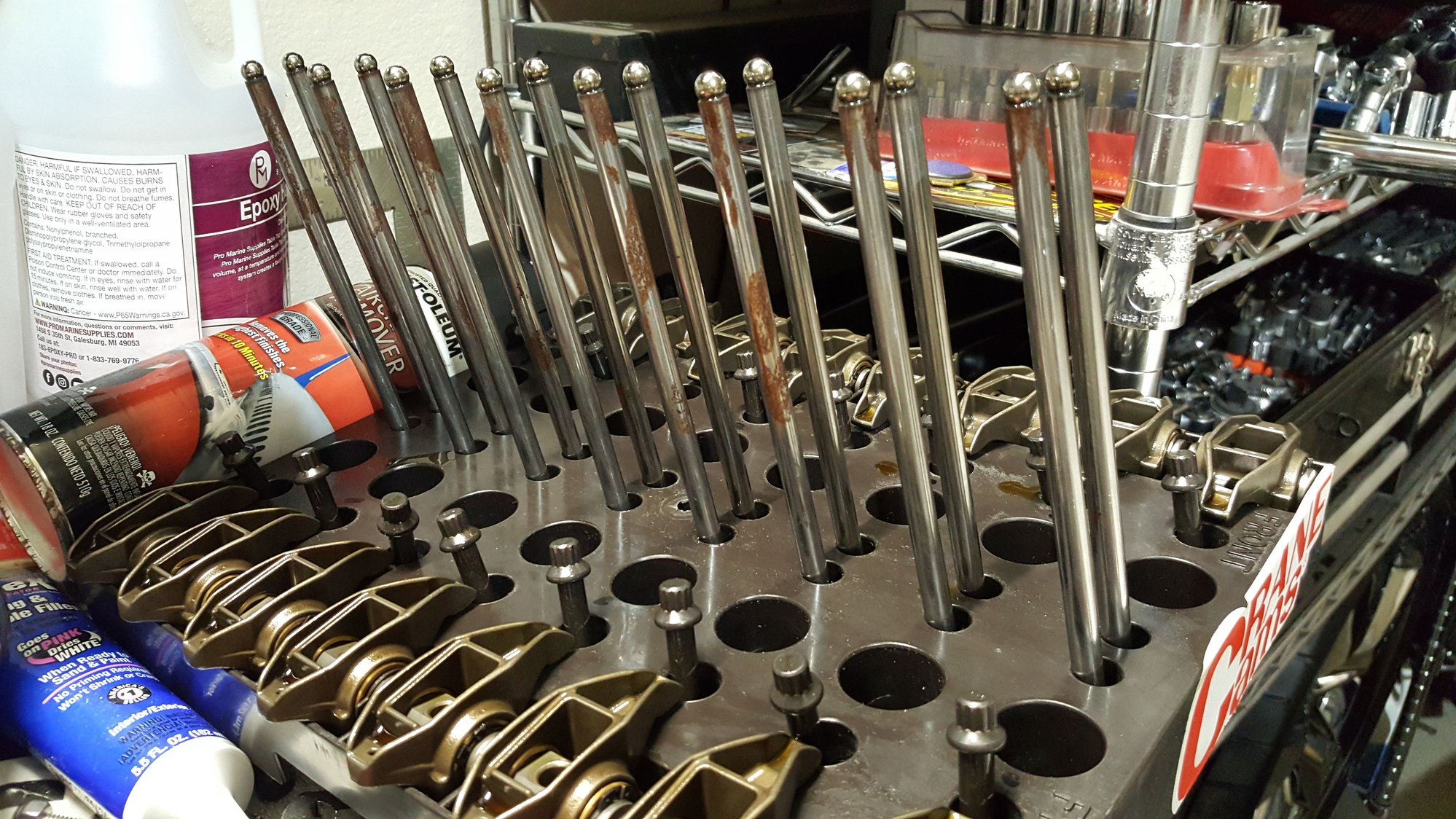

Last year, I took the heads off my 05 gto to replace the lifters. It was warranted, 6 lifters were collapsed from what I could tell. I put it all back together with felpro bolts and head gaskets. Seemed fine, but I don't have an angle wrench adapter, just eye balled it with a breaker bar as best I could.
After a few drives, I had residual smoke in the tail pipes after a drive. Every time, it was never excessive, but a little wisp as I walk around the car. I put around 2k miles on it, pretty easy miles with no hard pulls. Finally, I decided it's time to address this. I bought ARP head bolts and some acdelco head gaskets.
I pulled the heads off yesterday. On the way down, I took the valve covers off and nearly fell over. The pushrods all had rust. The spring retainers all had rust. What in the world? That's all new stuff, new pushrods and new springs/retainers when installed a year ago.
my question is, can running with bad head gaskets cause this kind of rust? I don't plan to use that stuff again, and the cylinder walls look unmarred. I know moisture can cause rust in an engine, but to this extent?

IF it’s a headgasket leak, you’d have to be running straight water for that to happen. Coolant contains corrosion inhibitors that won’t allow rust to occur with years of direct contact to metals that will rust.
Maybe this was flash rust from the build, and you waited a little while before first start-up?

I like the organization tray, by the way.
This...or. I've also taken apart engines from high humidity regions (condensation) that sat a while look like that....
The first time through WAS outside in South ms. And it happened over about a month after work on weekdays. It was a 50/50 mix of dexcool and distilled water.
Thanks! A Christmas gift from my lovely, understanding wife...
it has been sitting a while from COVID, but nothing more than a week at a time. It was doing the tailpipe smoke well before the COVID issue. It was my fault for putting it off, but life gets in the way. New job, new location, new house, etc. I'm just worried about the extent of rust. I mean, every retainer and all those pushrods, all so young...

If it's just discoloration, the rust can be washed off with weak chemicals that would do no harm to the parts. Or just leave it if looks aren't a big deal. Oil splashing on it will get rid of it eventually.

Did you put your sweaty hands on them and leave them out without wiping them down with oil? I know that's what happens to them when you do something like that because I've done it!

You can almost make out thumb prints on #4 exhaust pushrod. I’d say it’s flash rust from exactly what your saying.

I'd be more concerned with an actual blown head gasket.
You tore it down due to smoke out the tail pipes and not using a torque angle gauge.
Well now you have the head gaskets in your hand. Are they blown or leaking? If not no kind of head gasket and ARP studs are going to fix it.

The pushrod rust does look like fingerprints, or where they would have been touched.

Man, I hope yall are right, I'd be tickled if those parts were only rusty because I did the work outside and touched them with sweaty hands. As for the head gaskets, they didn't look awful or strongly suspect, but several places on the blue lining around each opening looked to be missing little chips. I found them on the underside of the head for the most part.

Also, this round is all happening in a garage and I'm using a good bit of liquid wrench on cs surfaces in between work. Awaiting the heads now, new parts are in the house until ready for install.

rust somewhere where there is lots of oil...is pretty weird.
Nothing looks wrong with that gasket though. Why are you saying they were blown ?
Massive coolant loss, some residual tailpipe smoke when I get to my destination. No apparent coolant leaks in the engine bay, new water pump, not wet under the car except at the back (rear main seal). I kind of thought the same about the head gaskets, didn't want to believe it...

If there is "massive" coolant loss, and it is not external...then it should be very obvious internally when you have it apart.
Certainly that gasket you posted looks fine, but the plugs, pistons, bores/chambers or perhaps other gasket should have obvious signs of an issue.
