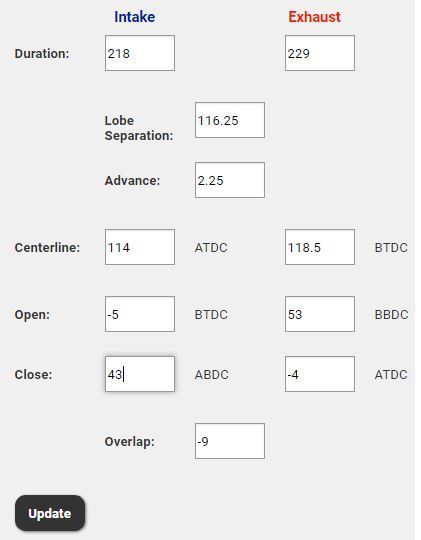

This is an interesting conundrum. First, we think the move to 9.5-10:1 is a good idea. LSA pistons are used in marine applications similar to towing and do a pretty good job at holding the power, yet quiet etc. We plugged some events into our calculator to set the behaviors. We went -5 (ATDC) intake opening for some civility but still have some character. We closed the intake at 43 abdc which is later than LS1 or LQ9 for instance to move the power band up and bleed a bit of cylinder pressure. We opened the exhaust at 53 bbdc which is a good average all around-er for mileage and power then we closed the exhaust at -4 (BTDC) to limit overlap to -9. The resulting cam is a 218/229 116 + 2. We've looked through the offerings of all of our vendors and don't see anything quite right. We could do a custom with you through Cam Motion or the cam company of your choice and set the lift for .600 to work with a TFS-16918 beehive spring for instance.

Absolutely! We sell Comp, BTR, Cam Motion and most of the others as well. If there is a good cam solution in a stocking grind that performs well and saves folks money, we recommend it - but this one was not one of those cases. Steve pops on here quite often and we do customs with them when the need arises. We and Cam Motion often prescribe nearly the same valve events for given combination.
