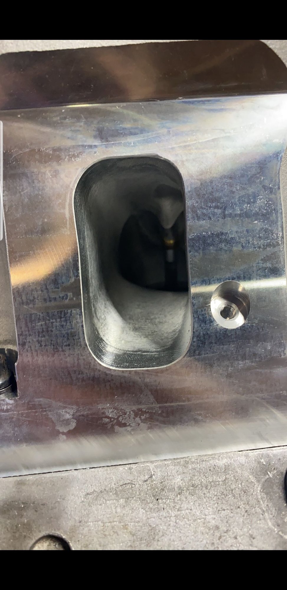

Sneak peak of the heads.. Who knows that these are? 🤔 Weird feeling i just bought squares cause im hardcore Cathedral port mafia 🤣

  #168
LaBLKv6Z's Avatar
Joined: May 2010
Posts: 1,372
Likes: 215
From: Lafayette, Louisiana
FED's?
Looks like you forgot a bolt there
Old Mar 16, 2021 | 04:25 PM
  #171
Mavn's Avatar
"I MAID THEESE"
Joined: Jul 2011
Posts: 2,757
Likes: 701
From: Houston
Not my engine or heads. These are just pics they sent me so I could post the ports 🤓

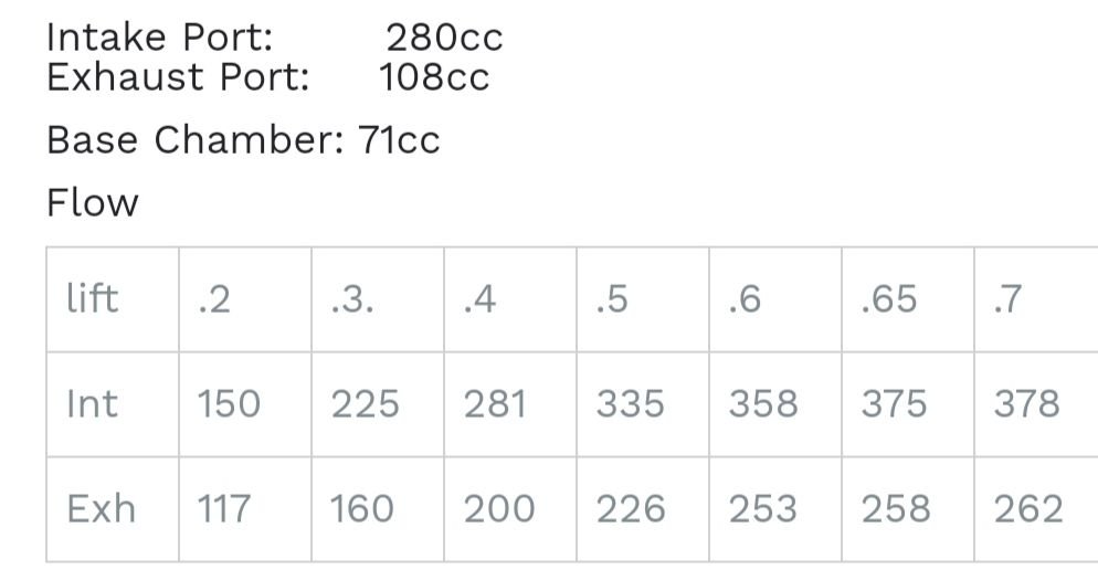

Some more info on the heads . Sorry for the tease . Im hust having fun lol

  #178
spanks13's Avatar
Joined: Oct 2008
Posts: 1,425
Likes: 621
Dart Ls3?

Need to make that chamber a lot smaller!
Flow chart is same as these: LSXceleration XF3 LS3 280cc/68cc 11° CNC Cylinder Heads - Stainless Intake, Inconel Exh, 0.660" Lift, Ti Retainers 15-361233-2
