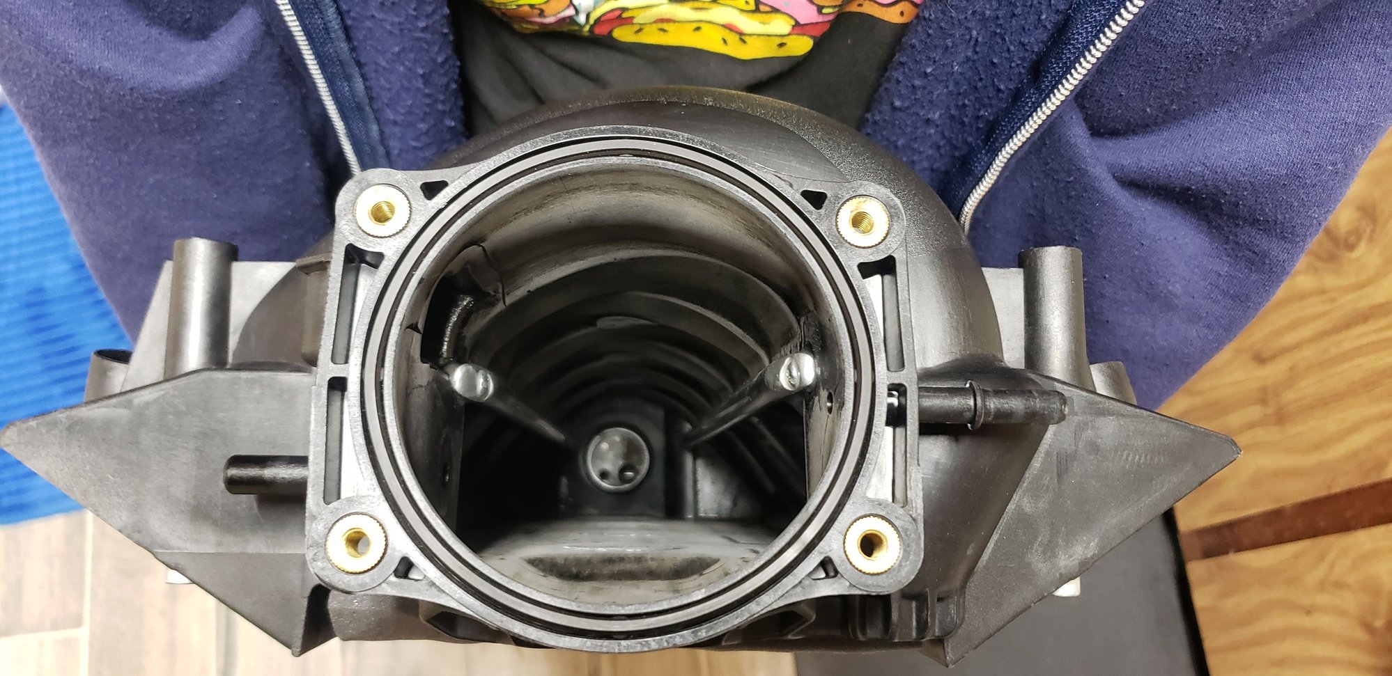

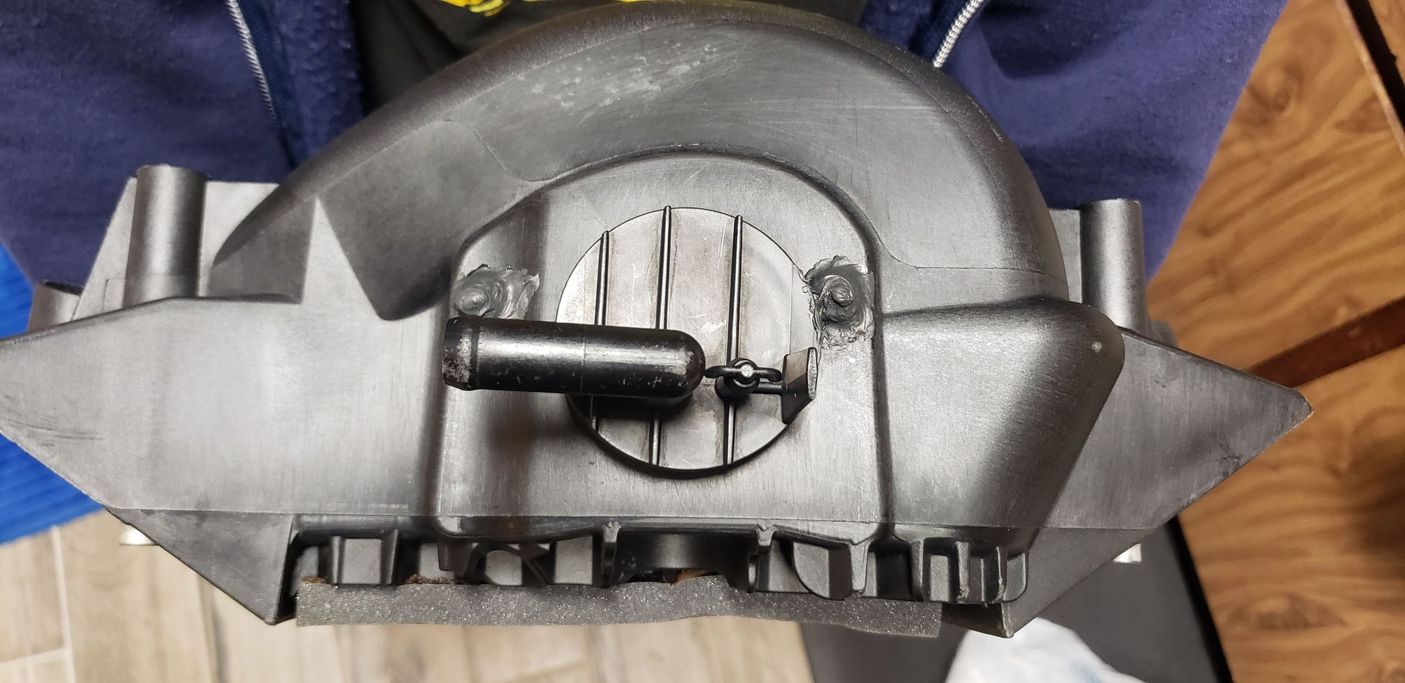

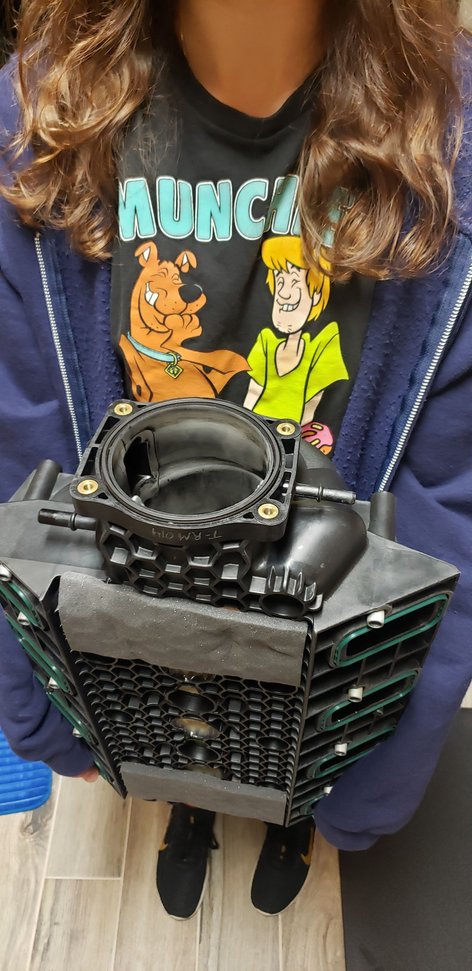

Rod modded Intake Received ! This is going on tomorrow with some e85 and some @subeone sauce

1hp gain 😂
Old Mar 12, 2021 | 12:41 PM
  #133
LaBLKv6Z's Avatar
Joined: May 2010
Posts: 1,372
Likes: 215
From: Lafayette, Louisiana
No doubt, I’m baffled but data is data. I’m sorry for the time involved for little to no gain on this great performing setup guys.
Old Mar 12, 2021 | 01:04 PM
  #134
Mavn's Avatar
"I MAID THEESE"
Joined: Jul 2011
Posts: 2,757
Likes: 701
From: Houston
Well the rod mod only gained 1 hp . Sucks it only made 1 more. But it is what it is! Time for some PRC 260s!

Pretty unexpected result there. Looks a bit flatter on the top end? The 469 pull looks like it is rolling over more at 160mph. Typically the rod mod intakes really start doing their thing above 6000+. I have heard some people become timing limited with them. Maybe the E85 will help.
I thought the injectors from the blown cars have different spray patterns that don't work as well in NA applications? Maybe hearsay, but it made sense when I read it.
How's the manifold vacuum at high rpm?

I dont tune , so not sure about the manifold vacuum @subeone would know.
