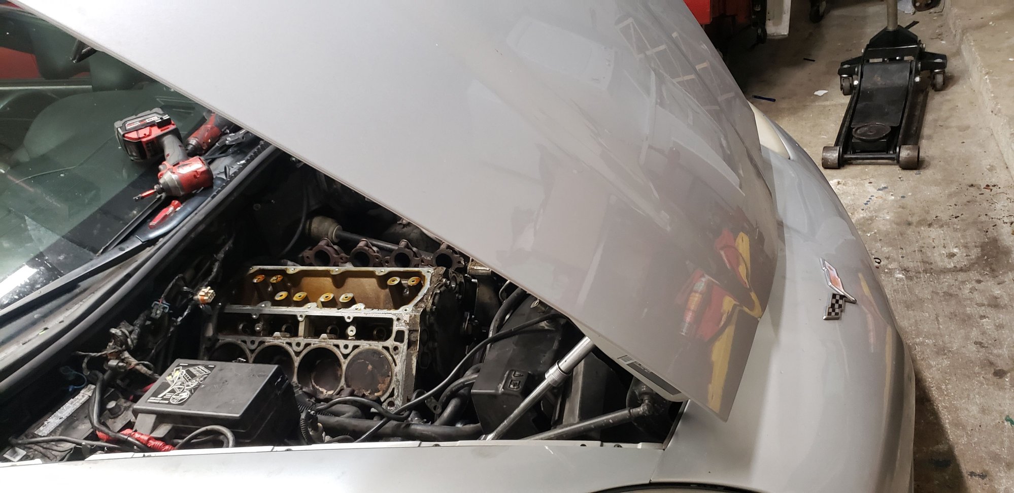

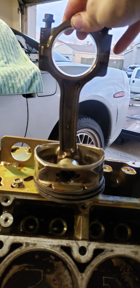

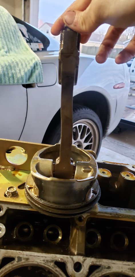

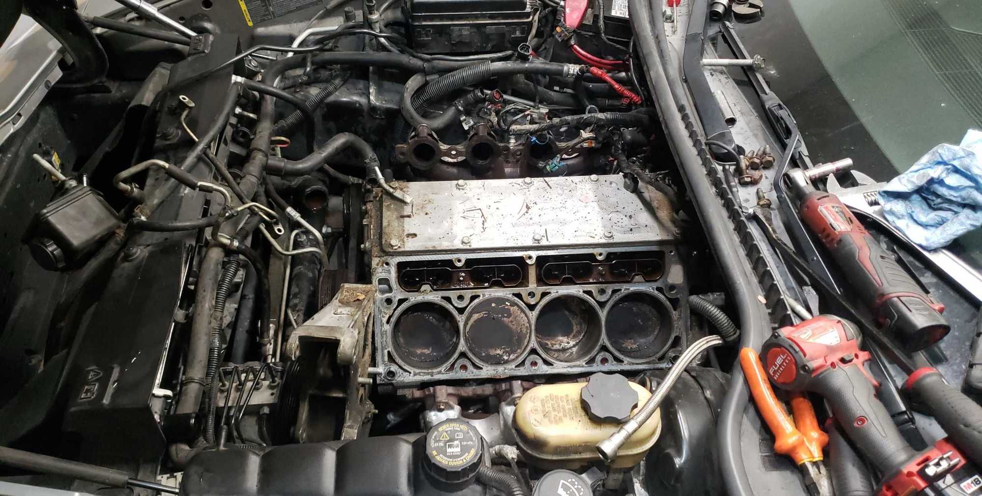

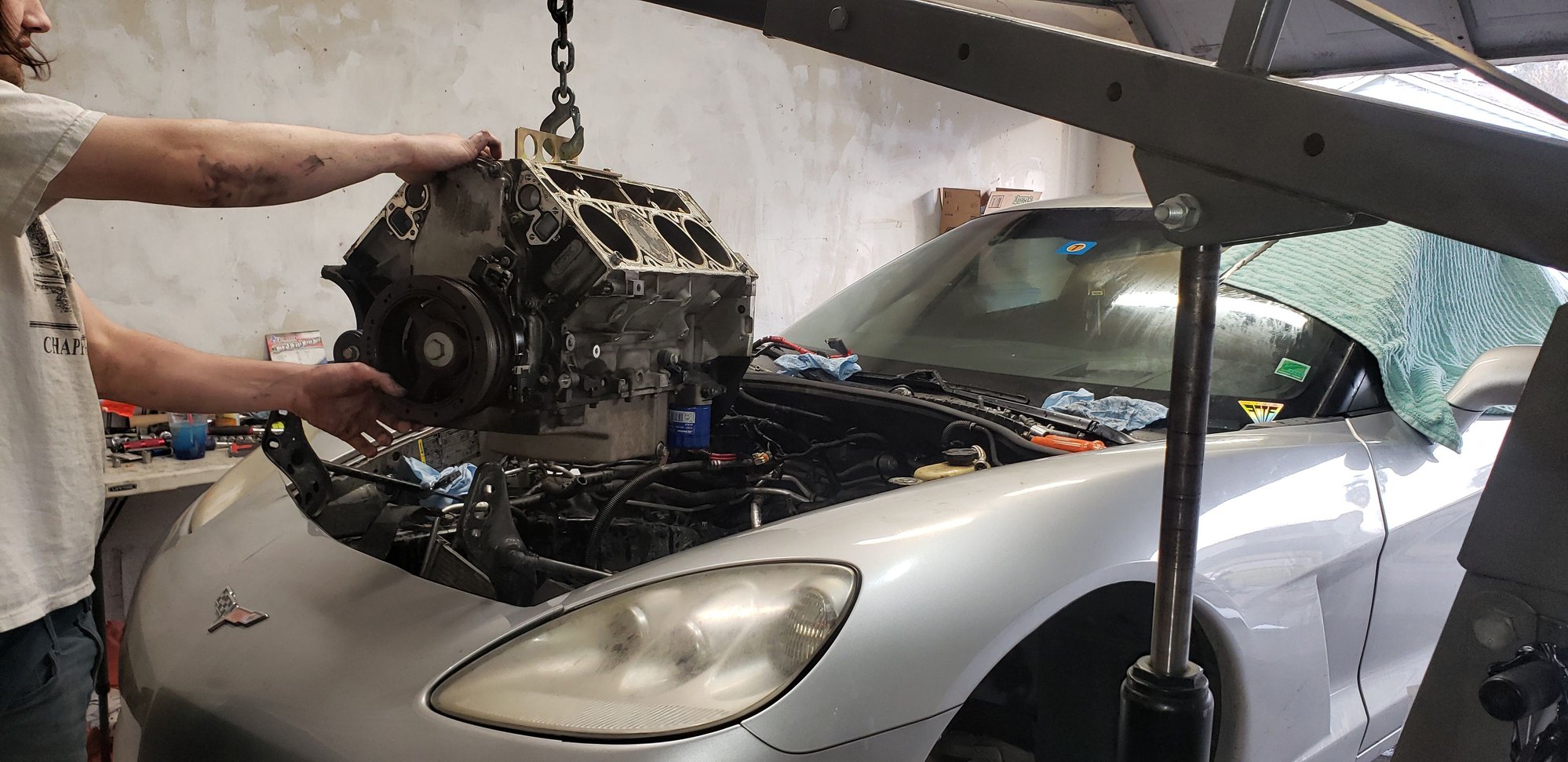

Wasnt planning on building my Corvette yet, but my wife hit water and hydro locked it and bent #7 rod. Soooo lets build this thing .
Heres the plan: it can go 2 ways..
Put a rod in it, and send it. Shortblock looks good besides mr S shaped rod.
Clean block up
summit stage 1 ghost cam
PAC .660 dual springs
Ls9 head gaskets
ls7 lifters
Pushrods
now to the heads...
Mill my stock ls3 heads .030 with a valve job .
stock ls3 intake
Orrrr....
Put my PRC 220cc as cast cathedral 62cc chamber heads on it. And put a MSD atomic manifold.
thoughts???
Both same cost. Sell my heads and intake for close to what a a msd atomic costs. Or pay $300 for mill and vj on ls3 heads
speed engineering headers
Keeping factory converter . And npp exhaust
Heres some pics!!
