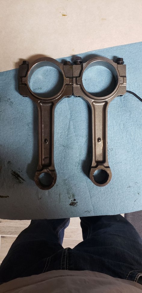

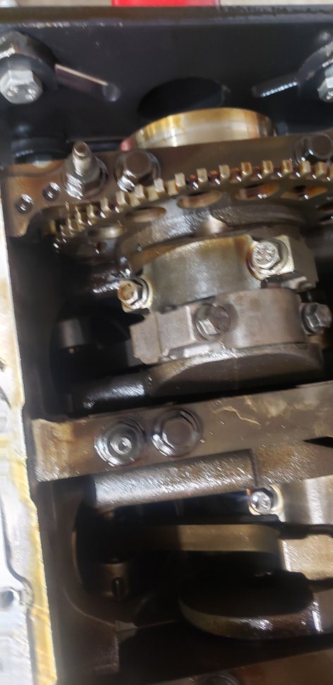

New used gen 4 boi
Bendy
Swapped outttttt

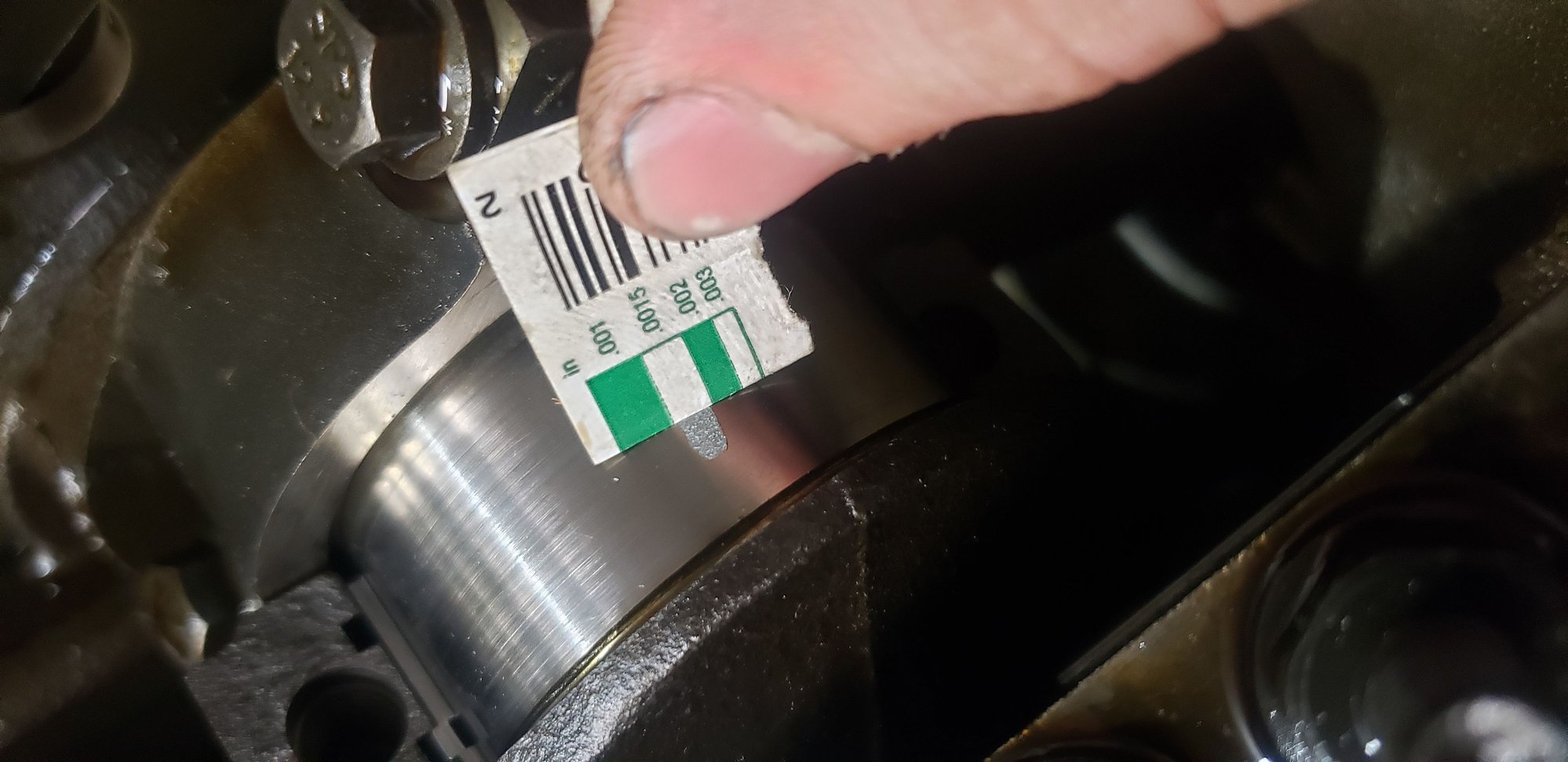

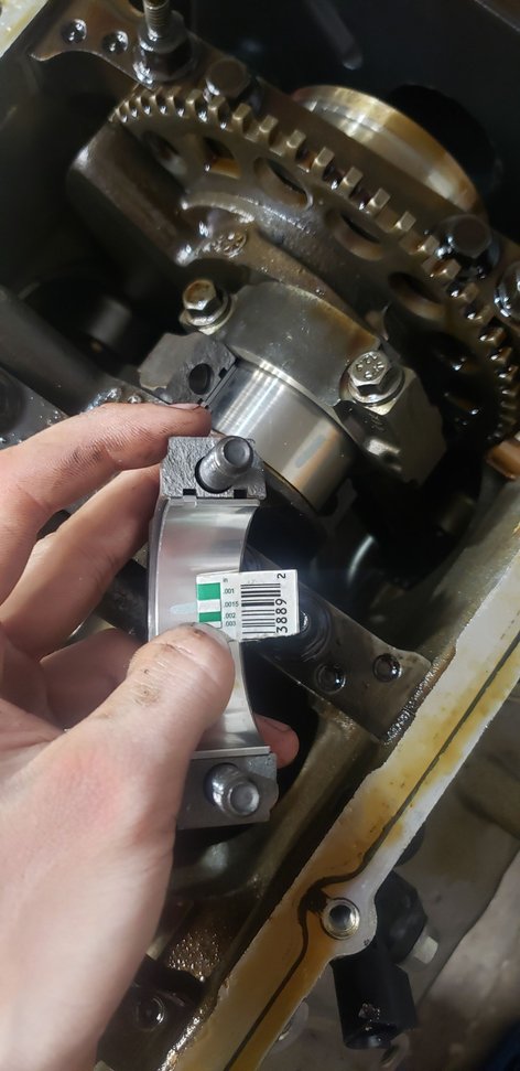

Plastigauged perfect with the oreilly mahle bearing

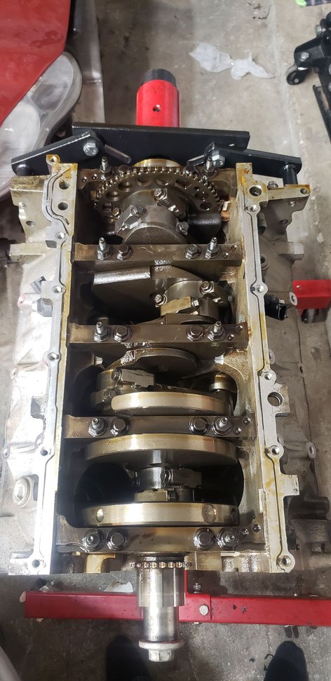

All back together
Purtyyyyy

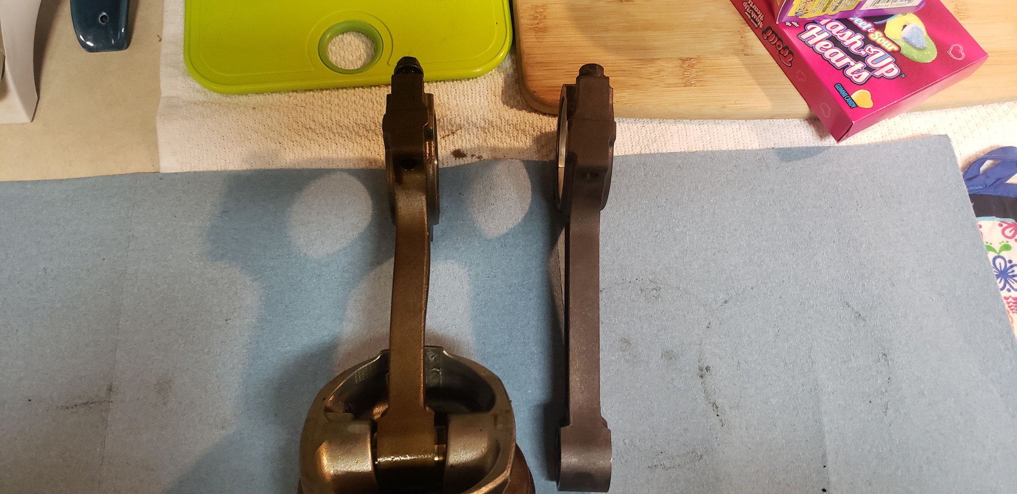

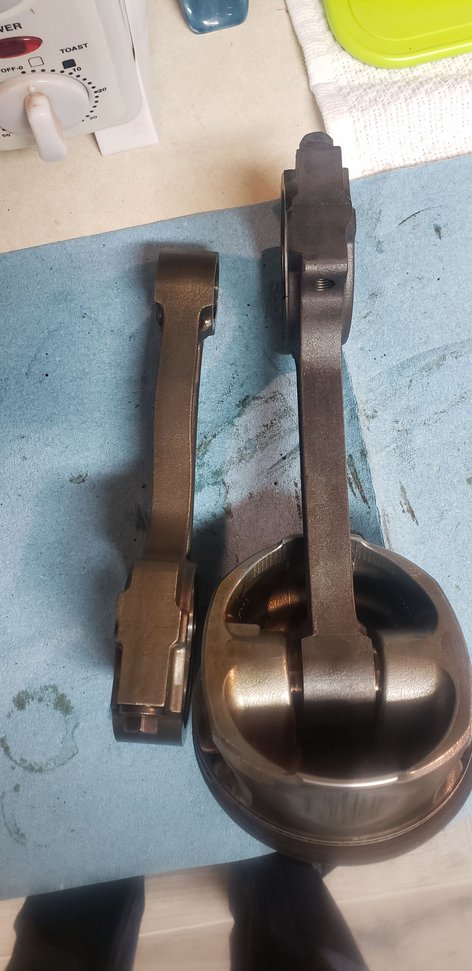

Got sold a 4.8l rod . 😑 backwards steps

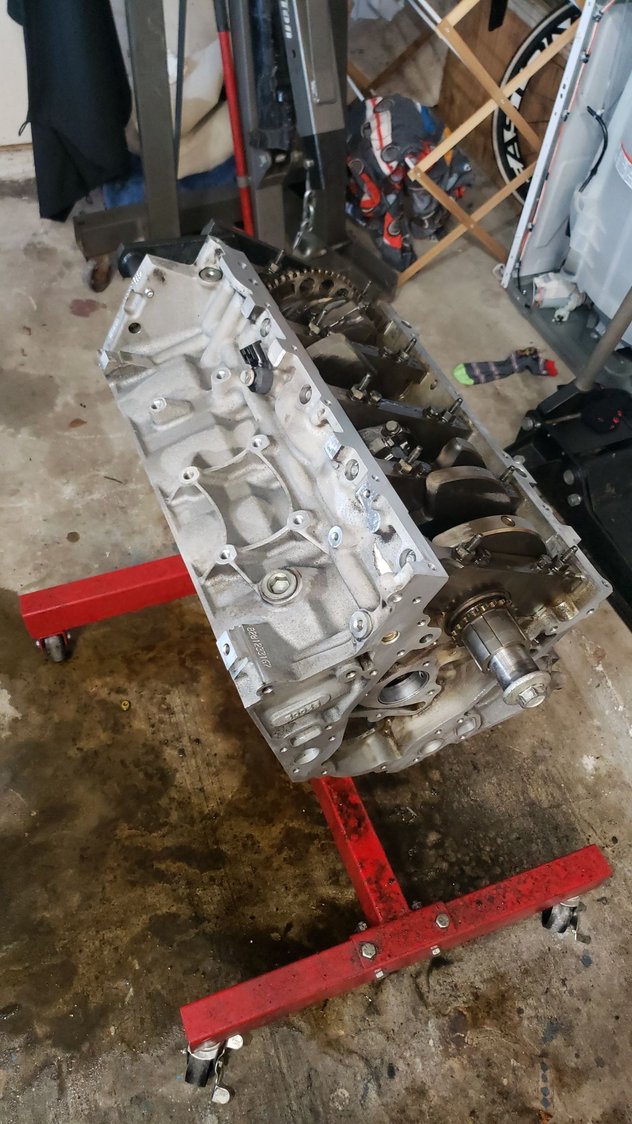

Got the block pretty clean tho

Quench be a bit tight in that hole lol might need to port the chamber a bit or just mill off the piston top OOOOps (joking)

Surely some forum member reasonably close buy has a spare Gen 4 rod?
If not, PM me as I have a few from an LS3

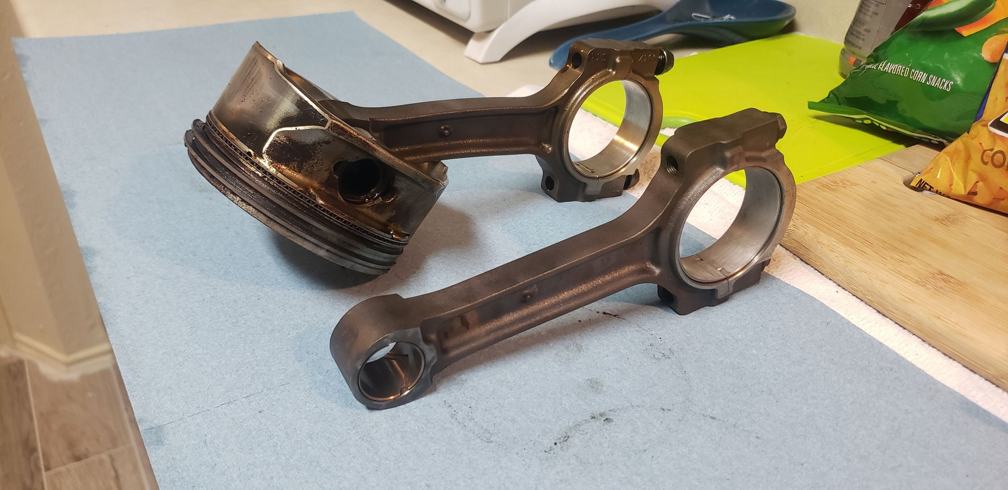

What's going on with the top of #1?
And thanks for the good laugh
Old Jan 6, 2021 | 04:19 PM
  #35
Mavn's Avatar
"I MAID THEESE"
Joined: Jul 2011
Posts: 2,757
Likes: 701
From: Houston
Scraped numbers on all the pistons with a screw driver when i pulled it out . A few went theough the Carbon build up 🤷🏻‍♂️🤣

The correct rod has been acquired... assembly this weekend
