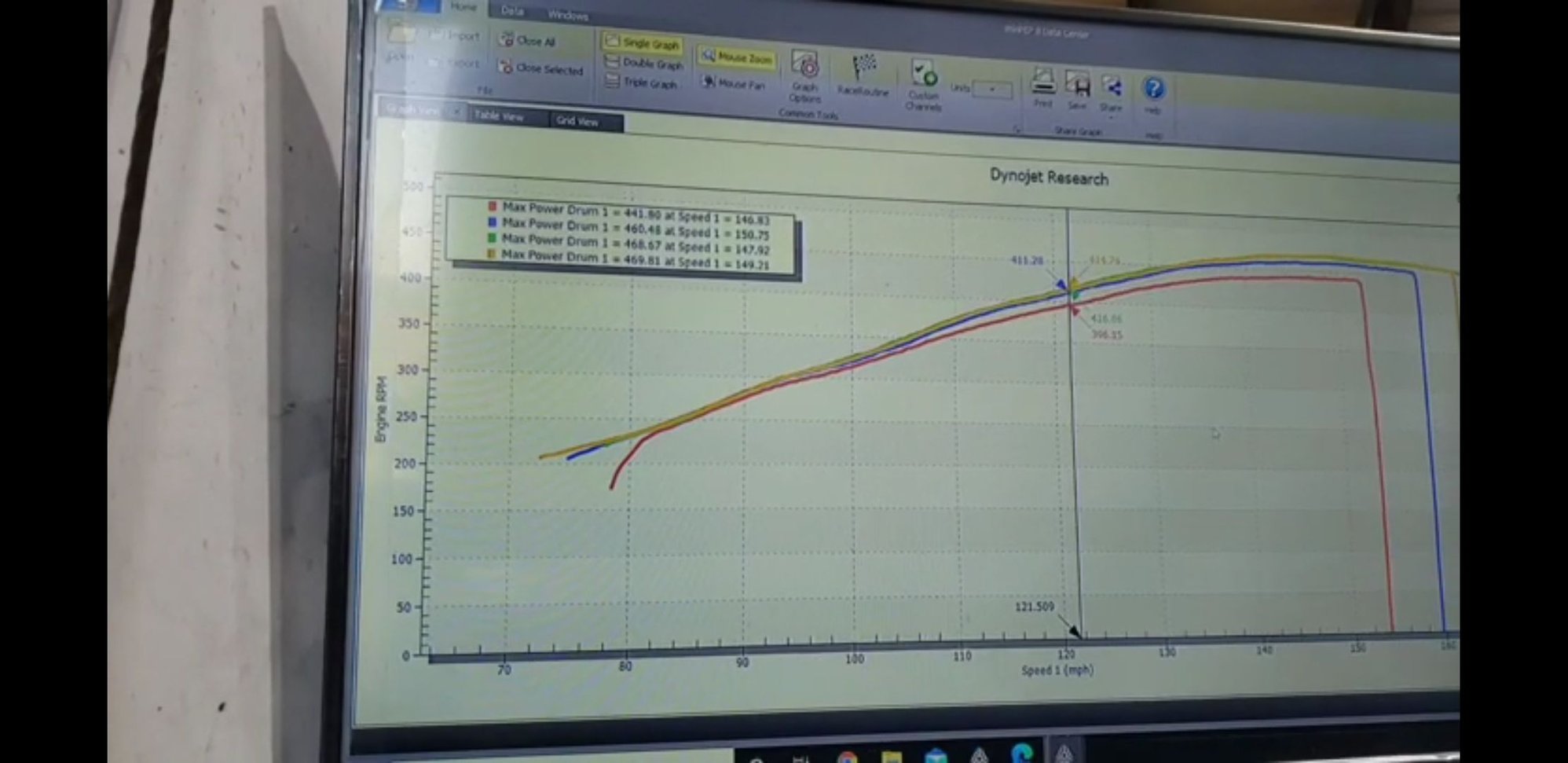

On way to the dyno. To get the sauce from Cesar @ HorsepowerFactory

Old Mar 6, 2021 | 05:23 PM
  #70
spanks13's Avatar
Joined: Oct 2008
Posts: 1,423
Likes: 619
465 wheel!

Old Mar 6, 2021 | 06:19 PM
  #72
Mavn's Avatar
"I MAID THEESE"
Joined: Jul 2011
Posts: 2,757
Likes: 701
From: Houston
Final numbers!
470 wheel thru the auto! On the Heart breaker HPF dyno.
Could not be happier.
Cesar is a bad man! The sauce master .
Old Mar 6, 2021 | 06:20 PM
  #73
Mavn's Avatar
"I MAID THEESE"
Joined: Jul 2011
Posts: 2,757
Likes: 701
From: Houston
Going to rod mod the intake and do PRC 260cc heads next round of mods.
Old Mar 6, 2021 | 06:28 PM
  #74
dAgent's Avatar
Joined: Jul 2020
Posts: 52
Likes: 26
Originally Posted by spanks13
465 wheel!
Pretty good for a small cam. What torque did it make? Post the graph when you get a chance.
Well, **** you did post it right before I asked the question. Thanks.

Thanks Darth, so what dcr would you do to stay on the safe side with 93 and the occasional bad 93 we get around here. 8.6-8.7 or closer to 8.5?
Old Mar 6, 2021 | 06:48 PM
  #76
Mavn's Avatar
"I MAID THEESE"
Joined: Jul 2011
Posts: 2,757
Likes: 701
From: Houston
That was just his guess. It made 470
Yeah sorry just guessing awesome results through an auto. Great combination of balanced mods. Rod mod intake will be nice. I’m a fan of them.
Old Mar 6, 2021 | 07:56 PM
  #78
dAgent's Avatar
Joined: Jul 2020
Posts: 52
Likes: 26
Right, I'm a dubmass. 470 through an auto is really good and it really hangs in there. How's the torque curve look like?
Old Mar 6, 2021 | 08:02 PM
Final numbers!
Just for reference for people, 140mph is 6k rpm and 160 is 6900rpm, at least it is on the wide bodies.
